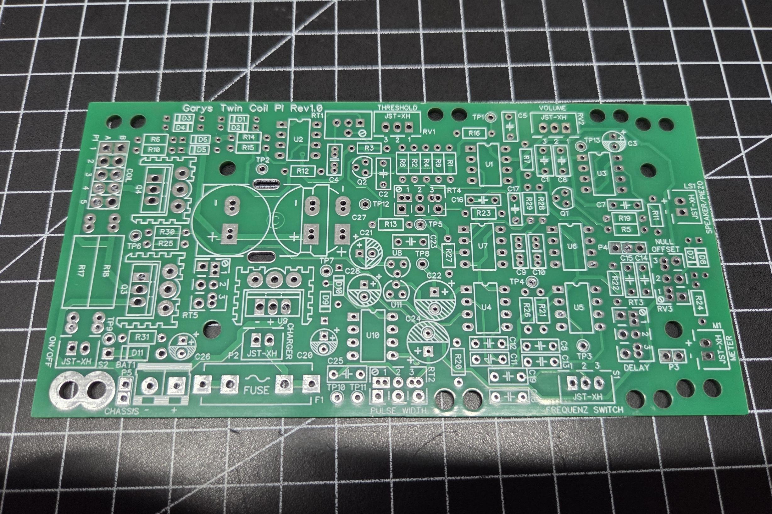

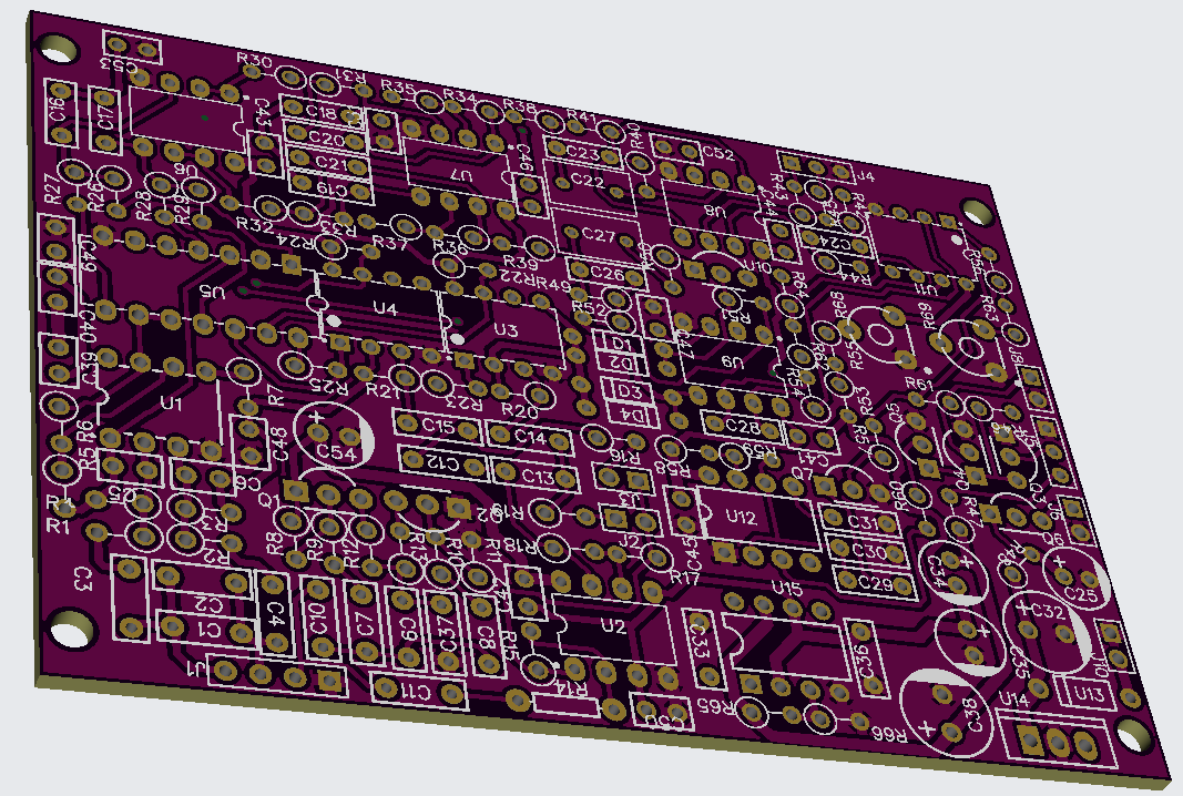

      Here's what Sasho's slow motion prototype pcb looks like, it's a pcb I'll never make public, Sasho himself is entitled to one or two.
      It is currently in the process of verification and testing.
      The rest of the forum can now thank you warmly because they will never get a layout of this pcb!
      Because of your "most".
      What are we going to do now?
      Go back to the mouse hole you crawled out of boy!

      Hello ivconic,
      At first glance, the PCB makes a good impression. On closer inspection, however, I—as a customer—would not be at all satisfied with it. Why? Just take a look at the component layout. The silkscreen looks terrible. The component designators are oriented sometimes to the right, sometimes to the left, and sometimes upside down. There is absolutely no system to it. Furthermore, test points are missing from key component groups. Additionally, the silkscreen is positioned too close to the pads. Regarding the ICs, there is no consistent orientation either, which complicates the component placement (Pick & Place) process. In several areas (U3, U4, U5), soldering in sockets would be difficult. However, I think the PCB will be good enough for testing purposes. Besides, one shouldn't complain when receiving something for free.​

            Hello ivconic,
            "...however, I—as a customer..."
            You and anyone else will never become a "customer"; for the simple reason that I will not offer these pcbs for sale.
            I will only make 1 single detector for my personal use and fun.​
            Though, many objections are "fine" and I agree.
            However, this is a through-hole board and not an smd, primarily intended for manual DIY hobby soldering.
            A serious limiting factor for some objections is the predetermined small dimension of the pcb.
            Page 2, post #29, I provided pictures of the box I plan to pack the pcb in.
            There are 4 screw holes on the bottom of the box. It is the space that defined the dimensions of the pcb.
            The schematic is not simple, there are a lot of components, plus decoupling capacitors have been added, which are not on the schematic.
            "... test points are missing from key component groups..."
            Yeah I agree, a few TPs in key spots would have been really useful, there just wasn't room.
            "...the silkscreen is positioned too close to the pads..."
            This is, to put it direct: a total ignorance and inexprerience.
            JLPCB gerber viewer shows it like that, in reality the situation is much better.
            I've done thousands of pcbs with JLPcb so far and I know for sure that the real pcb is different from what you see in their viewer, in a positive way.
            "...Regarding the ICs, there is no consistent orientation either, which complicates the component placement (Pick & Place) process.
            In several areas (U3, U4, U5), soldering in sockets would be difficult..
            Who on Earth will use pick'n place on this through-hole hobby diy pcb!??
            Total nonsense.
            Just to add more stupid "arguments" to the whole post, right?
            ​This is already excessively "strict" reasoning.
            If it was SMD, I would agree.
            But in the case of through-hole; these objections are meaningless.
            Except maybe the part where you correctly noted that a pair of DIL sockets will be really problematic to wedge.
            Whoever made Pulse Star 2... had more difficult tasks!
            I even had to choose some modified "2.5mm" (a bit more, about 3mm) footprint for the resistors, something I've always avoided until now, always preferring horizontal 7.5mm footprints.
            The main factor is too little space and too many components.
            The main thing for me is that the detector works well for me.
            I only intend to make one, for my hobby. This is not a pcb for professional mass production.
            Of course, you always have all the freedom in the world to design the pcb that suits you best.
            You should keep in mind that the metal detector is a "field thing" and that it is preferable to pack it all in the smallest possible box, at least that's my preference.
            The big fancy "square meter" pcbs we've often seen on this forum are only really good for educational purposes and bench testing.
            Ok, let's be fair, some of your objections are acceptable, all my "justifications" are even more fine.
            We will agree that we are both right to some extent.
            Beauty is in the choice.
            Draw your "correct" pcb and I'll salute it!
            However, your post has nothing to do with constructive criticism. I've been on this forum for too long and I'm no stranger to the human forum mentality.

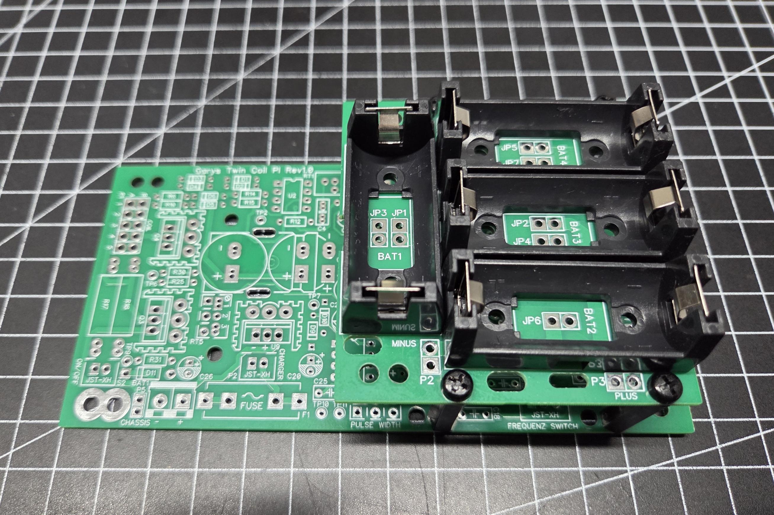

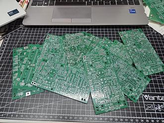

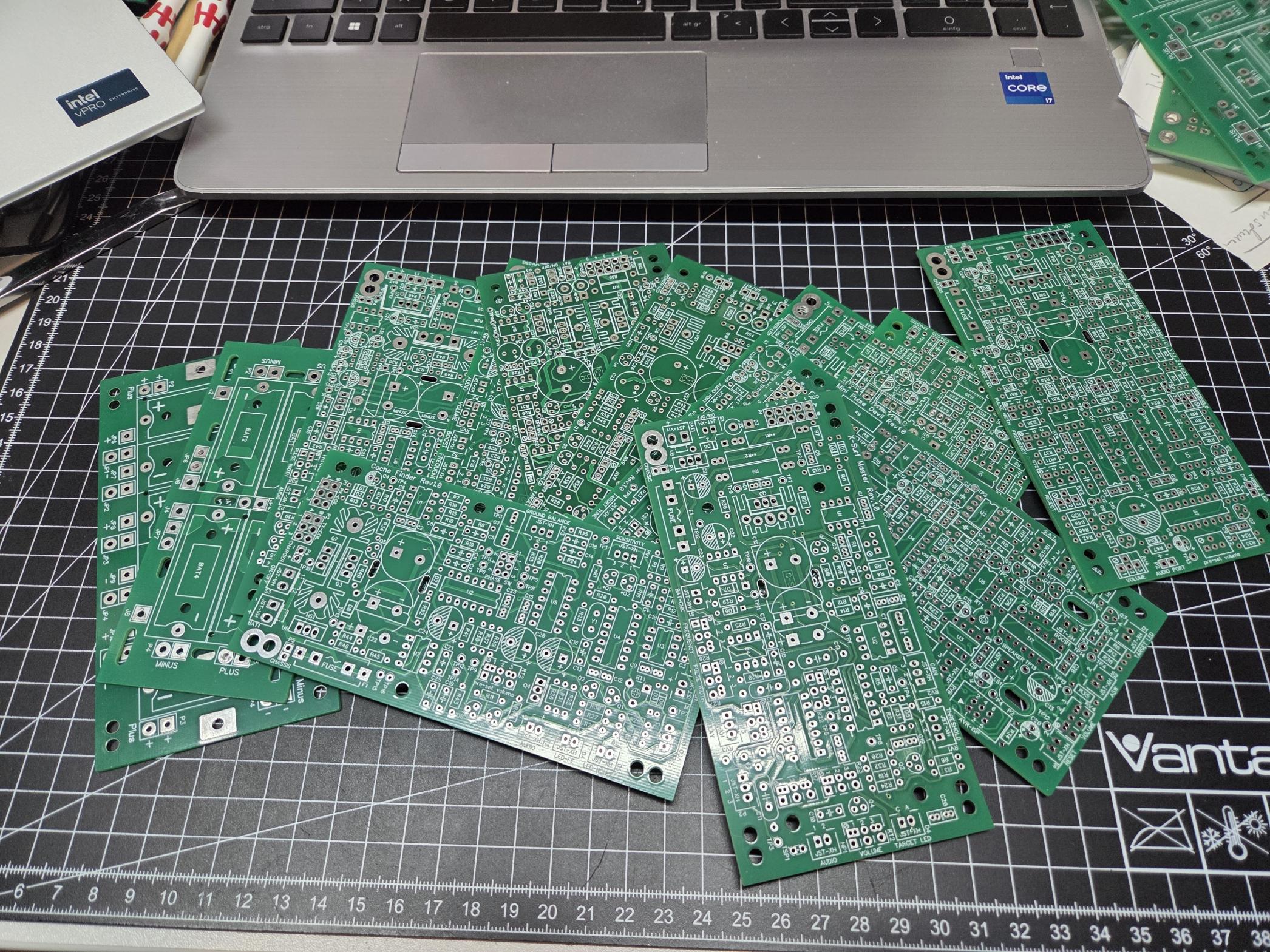

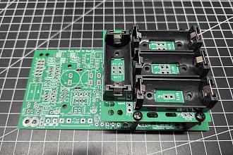

                              I am now giving you the opportunity to review some of my PCBs. If you think anything could be improved, please let me know. I value your opinion highly.​
                              Click image for larger version  Name:	20250715_090044.jpg Views:	0 Size:	760.3 KB ID:	448487
