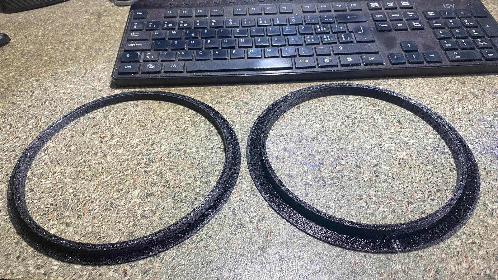

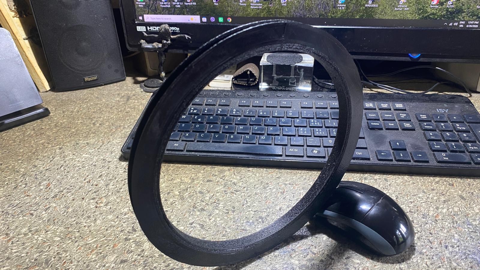

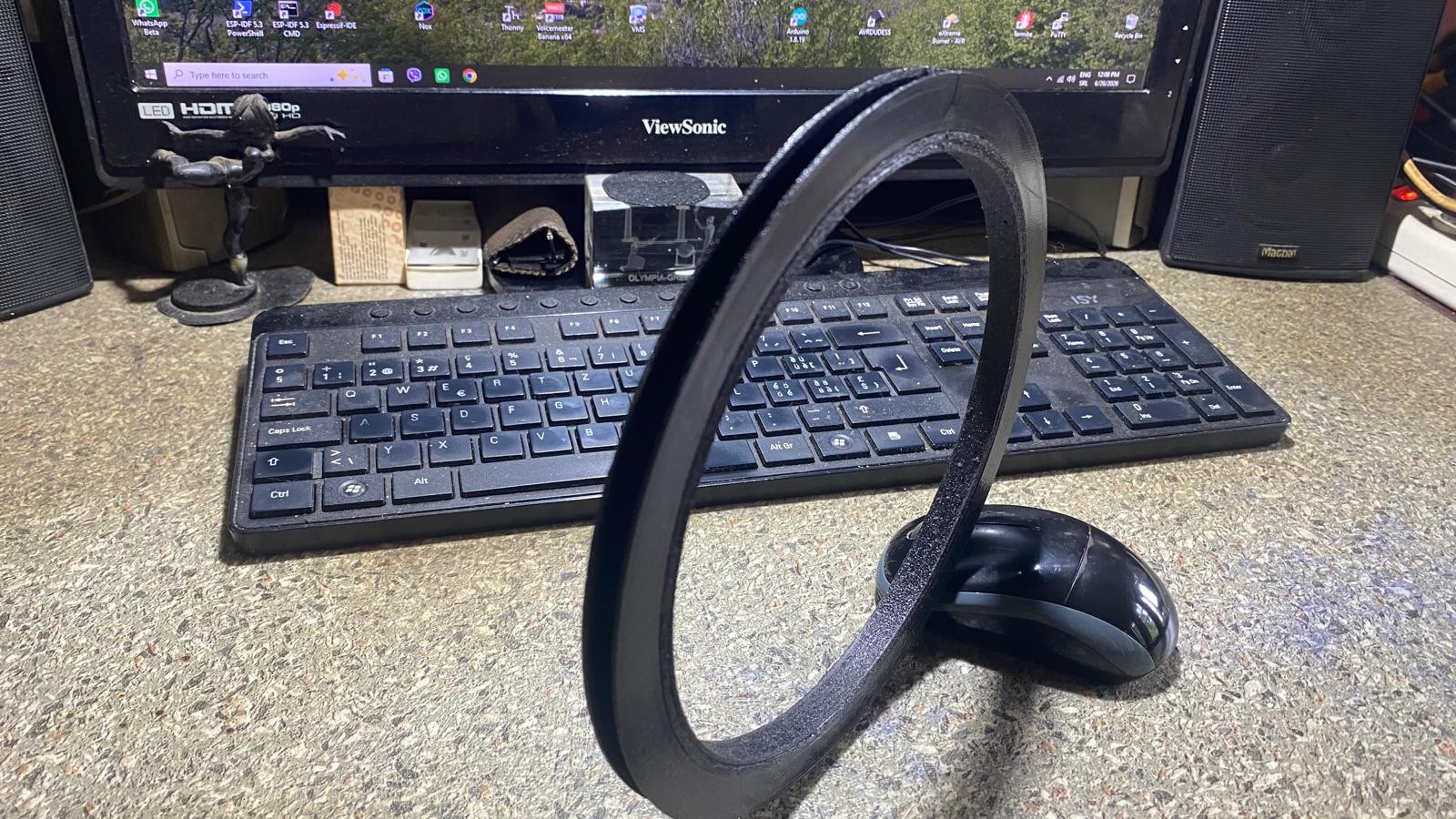

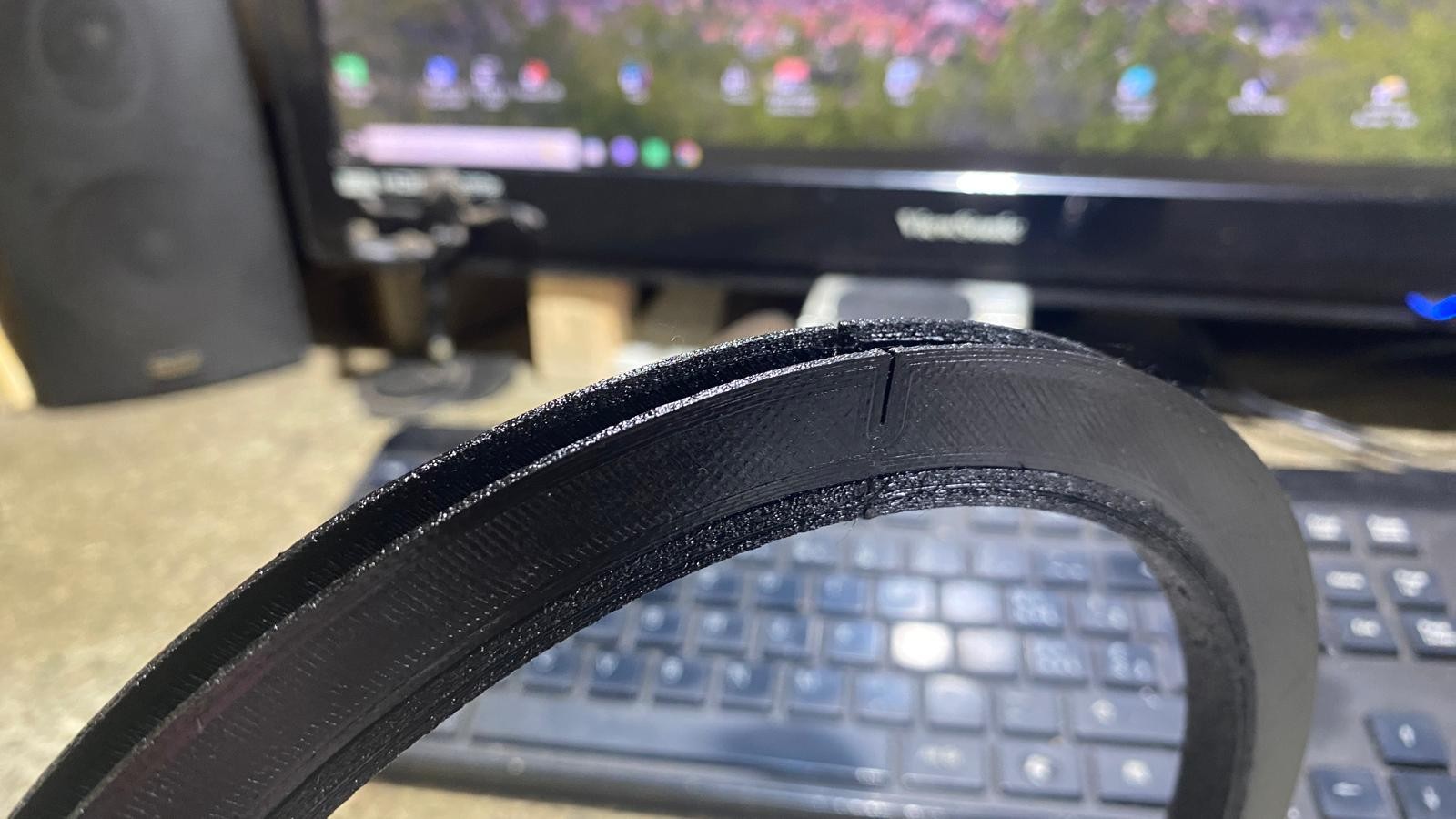

        • Well... what do you know... the thunder and lightning stopped and I "stole" enough time to print the "jig".
          It turned out better than I expected, considering this is still PETG.

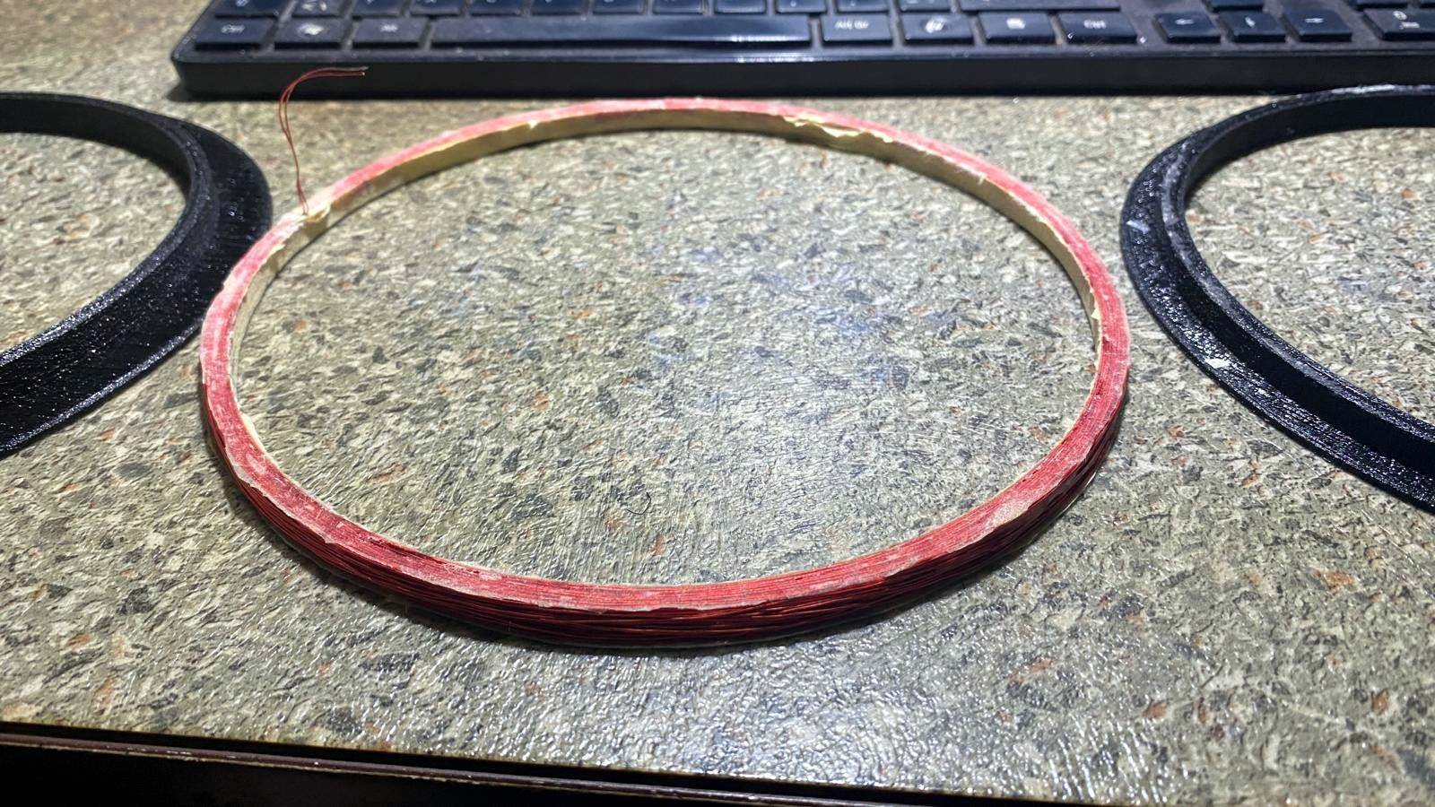

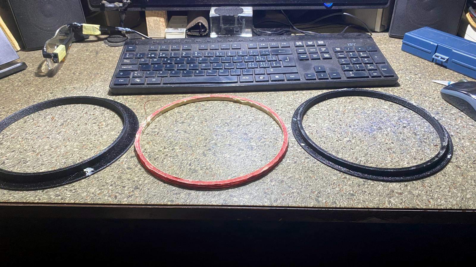

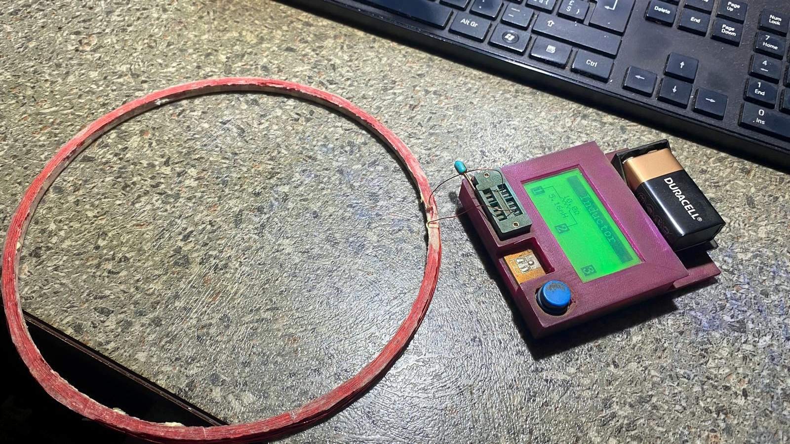

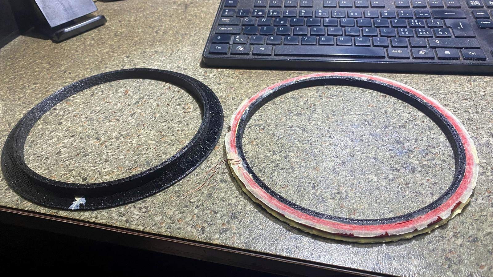

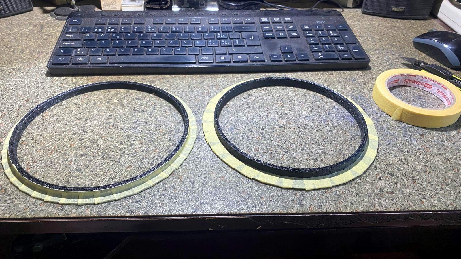

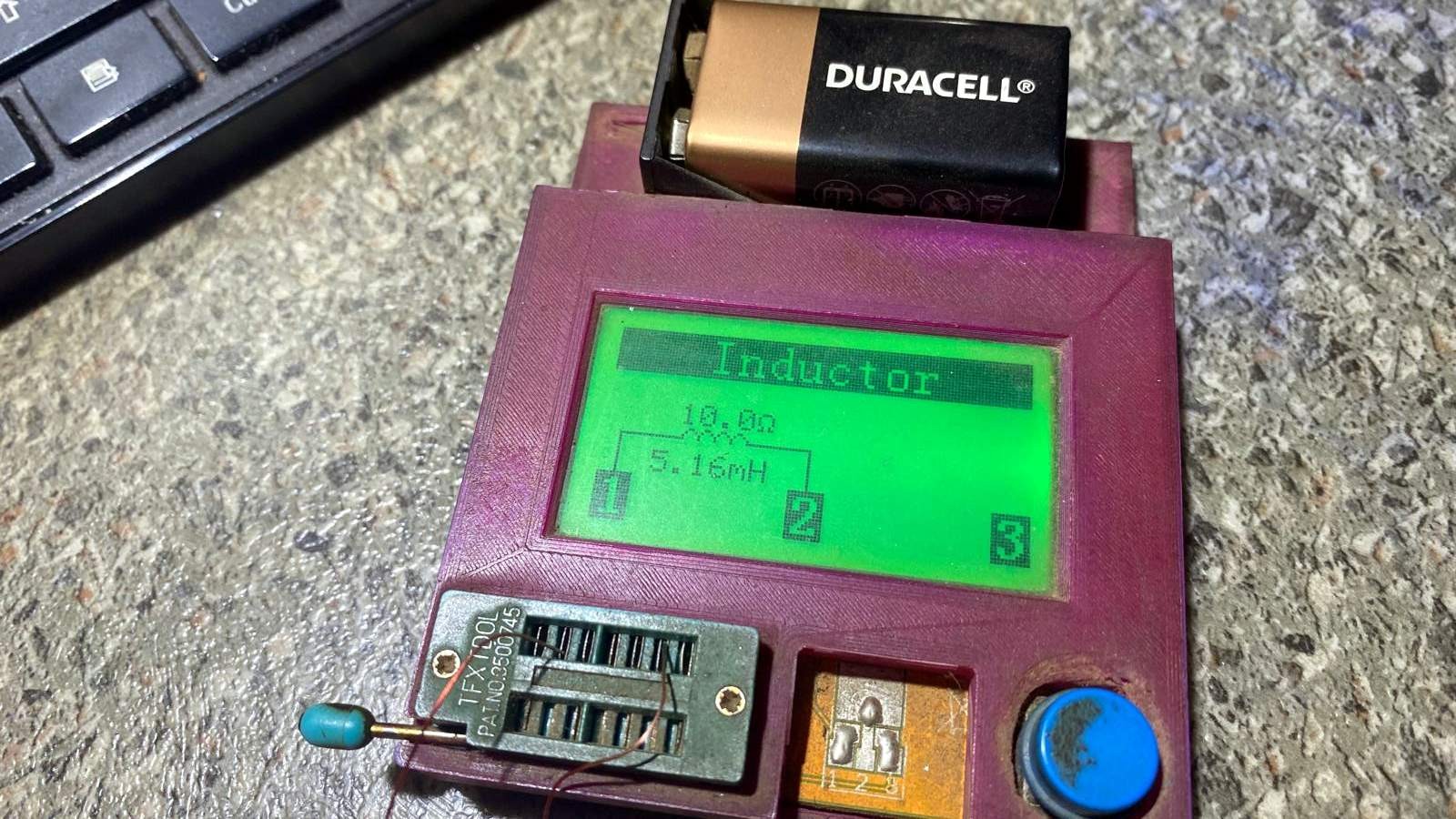

            • TX coil is ready.
              Now is time to search for a wire for RX coil.
              Click image for larger version  Name:	Jig_preparing.jpg Views:	0 Size:	490.5 KB ID:	450183Click image for larger version  Name:	Jig_opening1.jpg Views:	0 Size:	525.8 KB ID:	450184
              Click image for larger version  Name:	Coil_extracted.jpg Views:	0 Size:	455.1 KB ID:	450185Click image for larger version  Name:	Coil_extracted2.jpg Views:	0 Size:	481.6 KB ID:	450186
              Click image for larger version  Name:	Coil_specs2.jpg Views:	0 Size:	557.2 KB ID:	450187Click image for larger version  Name:	Coil_specs1.jpg Views:	0 Size:	372.3 KB ID:	450188​​​​​​
              • This is a real situation.
                And then (just kidding, because I knew the final outcome) I started DeepSeek and ChatGPT in parallel and gave them the basic data:
                18cm is the diameter of the coil body, the wire is 0.32mm (in my case this is debatable, the wire has multiple layers of varnish and my digital caliper is faulty).
                So I gave them range from 0.3mm to 0.4mm to calculate.
                110 turns (windings), coil section is 10x11.
                And what do you think both AIs calculated?
                Ha, ha, ha!
                Both gave totally different and absolutely wrong calculations that deviate from reality by more than 50% !!!!!
                So much for Ai...

                As much as some of you are totally into AI... I still maintain that AI is only useful as a slightly more advanced calculator.
                And here in the case of my TX coil is not even useful for that.
                One AI calculated me 2.2mH and 13 ohms and the other one calculated 8mH and 20 ohms ???
                I've lost all will to prompt the other AIs at my disposal.

                  • Back to the topic.
                    The super glue did the job better than I expected.
                    And what I feared the most; luckily it didn't happen.
                    And that is for the super glue to penetrate through the self-adhesive paper tape and permanently glue the wire to the plastic.
                    And coincidentally, it worked out well that the "jig" was 3D printed with PETG because it is much more resistant to pressure and bending than PLA.
                    I've worked with PLA for a long time and I'm 100% sure that the "jig" would crack in several places and after disassembly I could just throw away the leftover plastic.
                    PETG proved to be good. The "jig" remained usable and undamaged for the next RX coil.
