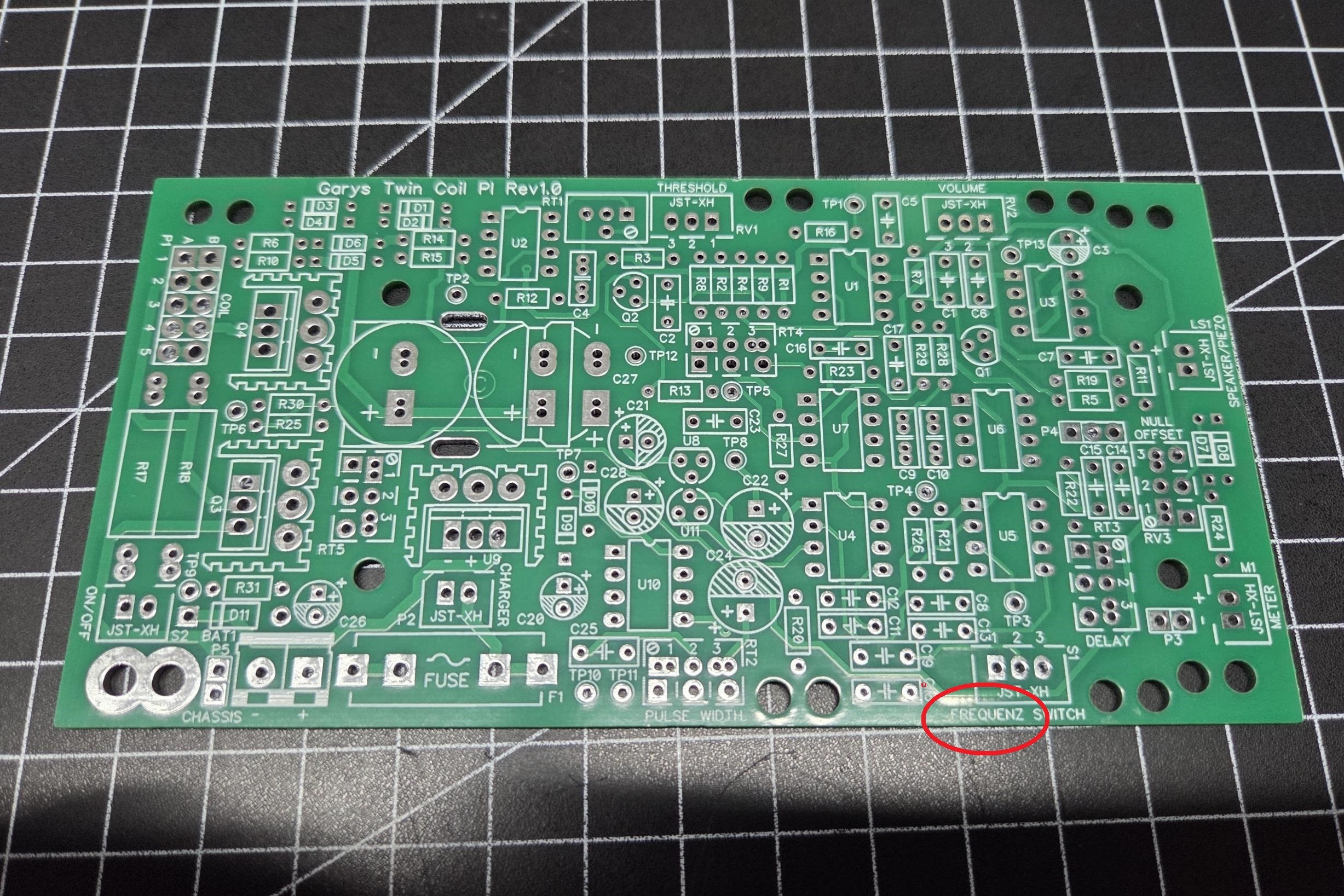

    Hello Ivconic,
    I am now giving you the opportunity to review some of my PCBs. If you think anything could be improved, please let me know. I value your opinion highly.​
    Click image for larger version  Name:	20250715_184854.jpg Views:	0 Size:	633.0 KB ID:	448491
    Click image for larger version  Name:	20250715_183903.jpg Views:	0 Size:	676.8 KB ID:	448490
    Click image for larger version Name:	20250715_090044.jpg Views:	0 Size:	760.3 KB ID:	448487
    Sure!
    They miss components!

                The main problem I see is that there are no components on the pcbs, a terrible omission!
                Pure rookie mistake!

                    GeoMax, kidding aside.
                    Your pcbs are neat.
                    No complaints.
                    I'm really lazy (to take photos) and hate digging through boxes, I have about 100-200 different pcbs that are surplus, JLPCB has a limit of minimum 5 pcbs to order.
                    And I often only need one, that's why I have so many pcb stocks that I haven't used.
                    JLPCB makes superior quality pcbs!
                    I have been dealing with them for several years.
                    They do a phenomenal job (as do other pcb manufacturers, I guess).
                    The PCB with which you found objections is for now only a test copy, it has not been produced yet.
                    I'm still going "on foot" and correcting the details.
                    Your insistence on neatness and perfect order is ok, I really mean it.
                    But I have a serious limit in terms of pcb dimensions and too many components on such limited space.
                    And I wanted it to be through-hole and not SMD.
                    So that I can change components more easily and find my way around more easily.
                    And that's why the pcb is so imperfect.
                    In my case, when I want to make one copy of the device, I pay the most attention to the S/N and visualize in advance how I will solder all the components myself.
                    What components do I have, what can I find, etc.
                    In particular, that pcb was drawn by a colleague from China, who is a miracle worker, within the same day he received a schematic in .jpg format from me,
                    converted it to one of the standard layout formats, asked me a series of questions about my wishes and requirements and later in the afternoon I have a finished drawn pcb,
                    exactly as I described to him that I want!
                    I have yet to meet anyone who can do it faster!
                    I considered myself very skilled in those jobs, and then I saw that there were many better than me.
                    Geometric regularity, aligned components, aesthetics; in this case and also in many other cases; it is often the least important to me personally.
                    The only thing that matters to me is that it finally works and that it works well.
                    Although I make a living from electronics, this is primarily an unprofitable hobby.
                    25 years ago I drew my pcbs by hand on paper. I didn't have a computer scanner so I used the window glass and daylight to trace by hand.
                    Today we have what we have in terms of conditions.
                    Some will do it better, some less well.
                    It doesn't matter.
                    It's a hobby!
                    I have not signed any professional contract with anyone here about any mass production of anything.
                    That's why I don't really care what anyone thinks about how it looks.
                    All I care about is that it works well for me.
                    Don't have bad energy, this is all a hobby, joke and fun.
                    At least that's how I understand this forum.

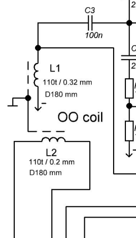

                        • #87
                          How exactly do you make the coil? Wire thickness, coil winding pattern, number of turns, etc.?
                          • #88
                            It is on the schematic, can't you see?

                              Hi Ivconic,
                              The Gary's Twin Coil PI Rev 1.0 version features the same circuitry as the original (based on the latest Revised Pulse-1 and Pulse-2 schematics from April 2009), with the exception that I designed the PCB (134x68mm) to fit a readily available, standard-sized enclosure (160x80x55mm). Additionally, there is a matching board for the battery, which can be mounted directly onto the main PCB. Furthermore, the coil connection has been modified to allow for the use of all coil configurations—such as Twin Coil, Mono/Frame Coil, DD Coil, Concentric Coil, or Dual-Field Coil—without requiring any circuit modifications when switching coils. It is simply plug-and-play. Performance: Due to time constraints, the board has not yet undergone testing; however, it should function correctly right out of the box.
