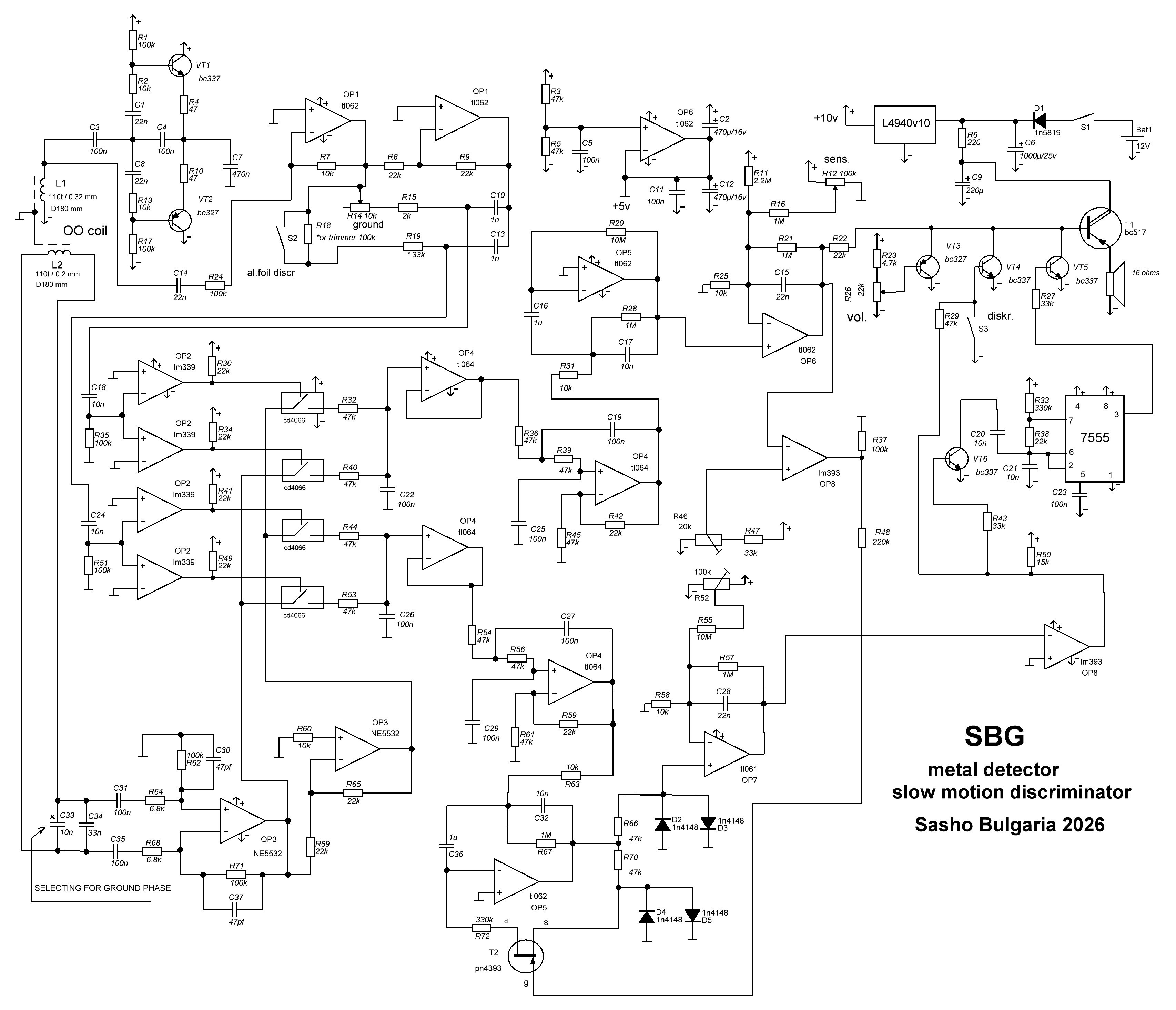

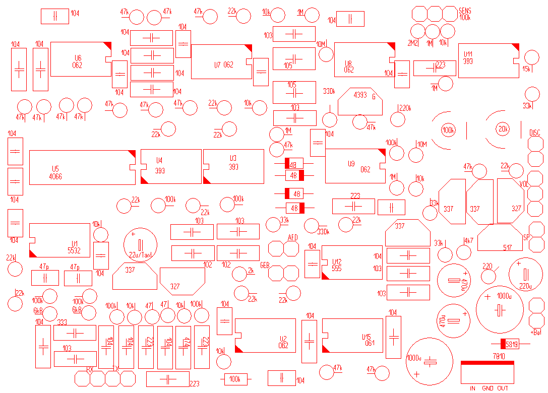

        I couldn't understand exactly what the parts I've circled here do, and whether SMDs are used in the circuit. Is it possible to use pinned components instead of SMDs? I would appreciate it if you could answer my question.
        • #94
          "...Page 1, post #1 is the most proper schematic..."
          This schematic, and author is SCS-BG who posted it.
          Read what he wrote and try to understand.
          So, disregard that shematic and pay attention to this schematic, I clearly answered you again with this:

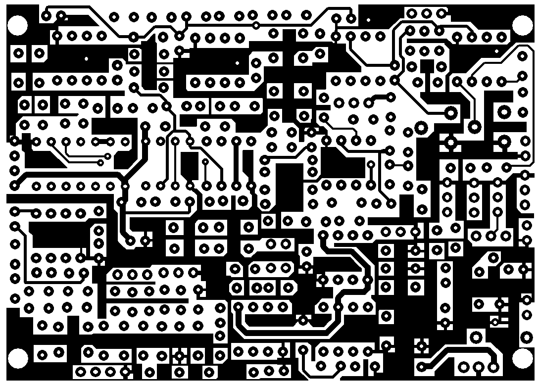

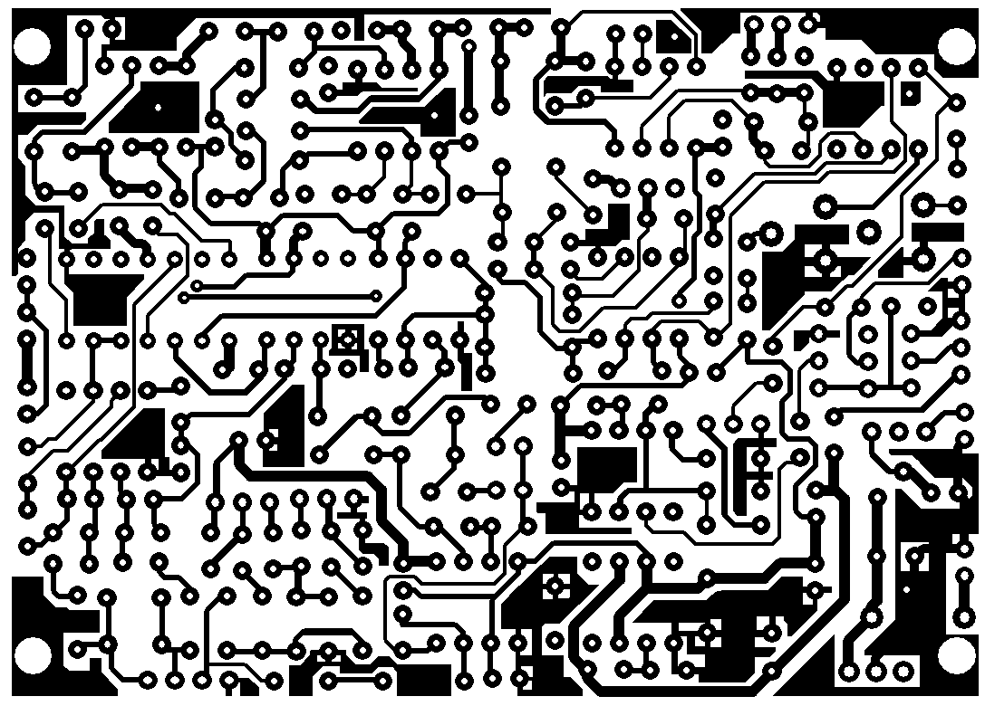

            Do you have the PCB for this circuit? Can you provide it? If so, please.
            • #96
              Page 4, post #60...

                        In the meantime, I will prepare the "placement" file.
                        I am the main culprit for the inconsistencies in the numbering of the components... so it is my "punishment" to prepare that file for you.
                        Give me a day or two...
                        Hey, are the IVConic placement files ready?
                        how long will it take to be ready
                        • 2-3 months in average...
                          I am old man, I need time...
