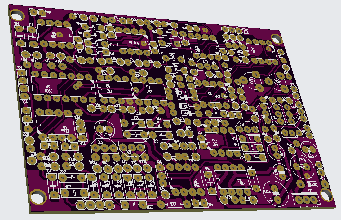

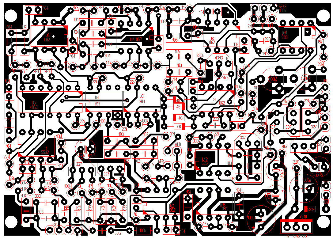

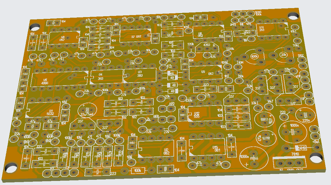

        • I couldn't see where the coils would be connected, I wonder where it is?
          • I'm sorry, I couldn't see it because my eyesight isn't very good. I just found it now. Could you send me the ingredient list if you have it?
            • No, I can't because I don't have any.
              Unlike the vast majority of my colleagues, I write component values ​​directly on the pcb and do not create a separate "BOM" (Bill Of Material) list.
              Just in case I plan to have JLPCB make my pcb and solder the components; I am forced to do it, and it is a rare case.
              In this case, from the beginning I planned to make only one device and solder all the components myself.
              That's why I didn't make a BOM list.
              Ok, I know, it's bad practice and it's not professional.
              Ok, that's me.
              That's why I published here (UP, post #106) a large and clear picture of the components and their values.
              It is very easy to work with.

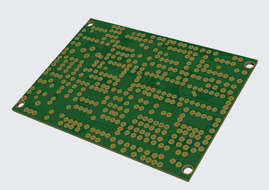

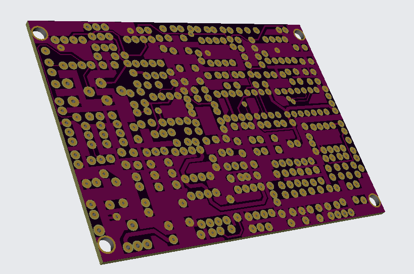

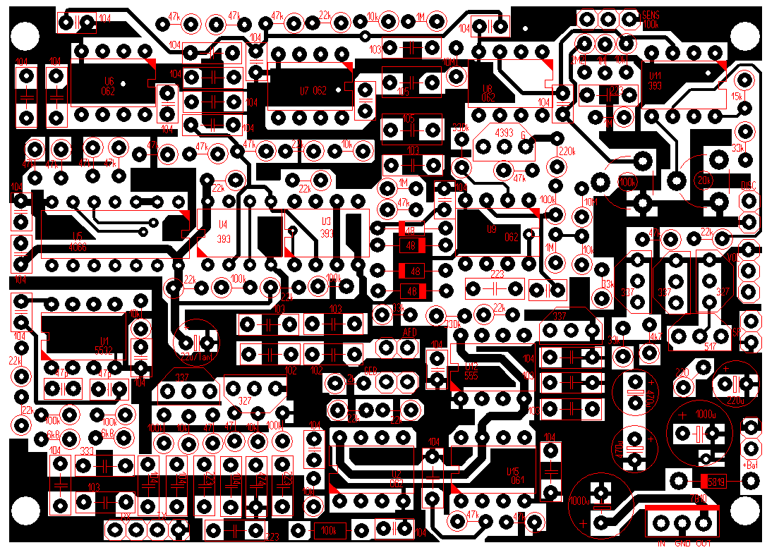

              • I assume you don't have a Sprint Layout? Or do you have?
                If you don't have; be sure to download and install, version 5 or version 6, it doesn't matter.
                You will find the installation easily on the Internet.
                Then with that software you can open this file and everything will be much easier for you:

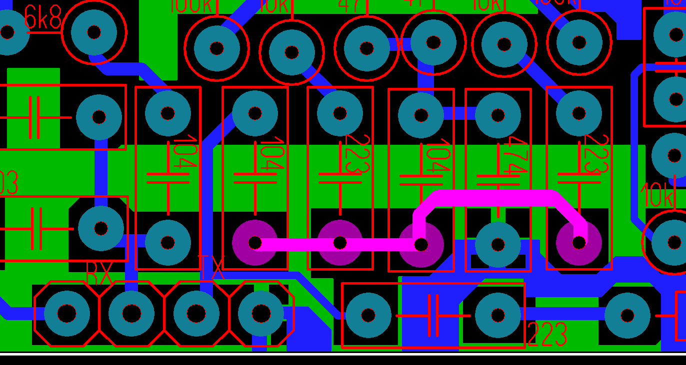

                • Doesn't it seem like the PCB and the circuit diagram don't match, or have I made a mistake?
                  • That's why Sprint Layout is so easy to check with , no it is not error, it is alright:

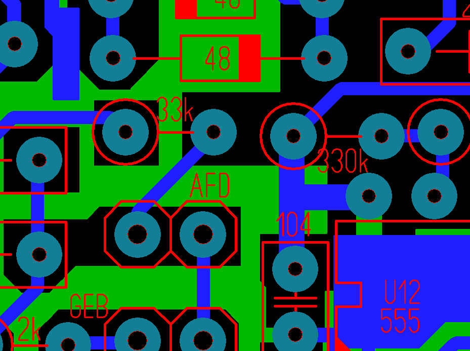

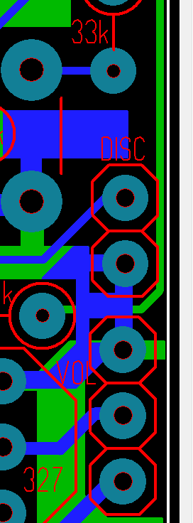

                    • "AFD" stands for "Alu Foil Disc", you use these two points to connect the switch, fixed resistor or trimmer/potentiometer, as you prefer:
                      • Disc ("discr") switch and Volume potentiometer:

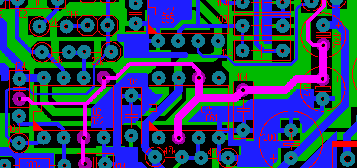

                        • TX connections and following components:

                                Is equal to
                                Hello!
                                I am a 12th grade student at a technical school in electronics.
                                I noticed inaccuracy between the board and the schematic diagram, especially in the generator part. The two capacitors in the transistor bases must be shorted, otherwise the transistors will not go in generation.
                                I have not checked the board in detail.
                                Some annotations on the picture of the diagram I sent ,are details - to identify potentiometers, switches and others that will be placed on the front panel.
                                Thank you very much!
                                All the best!
                                After I construct the device, I will send a review​ in the forum.
