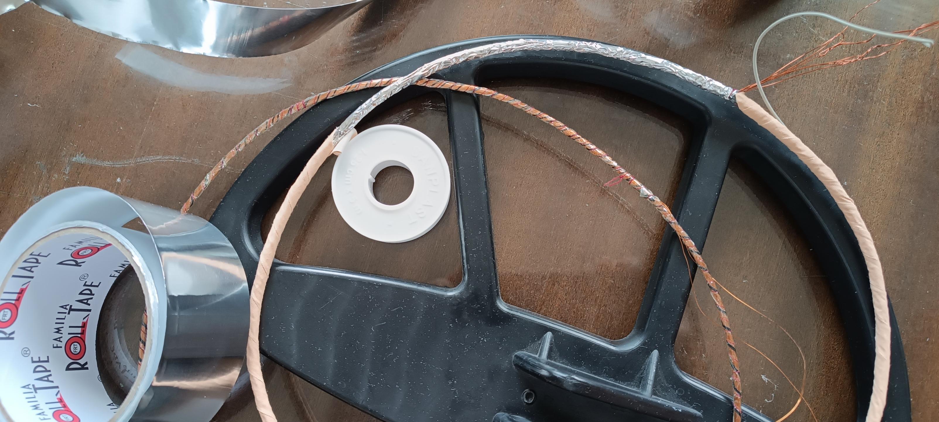

            • What is the easiest way to make the coils? You need strong wire and a lot of patience. Finally, you can glue the coils into the housing using instant adhesive and coat them with epoxy resin, or attach them to wooden supports, wrap them with gauze, and apply resin. The coils in the photo aren't for this specific detector, but the method is the same.

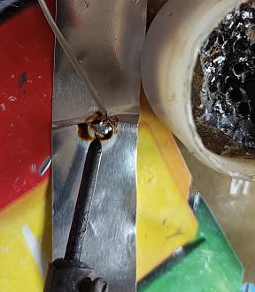

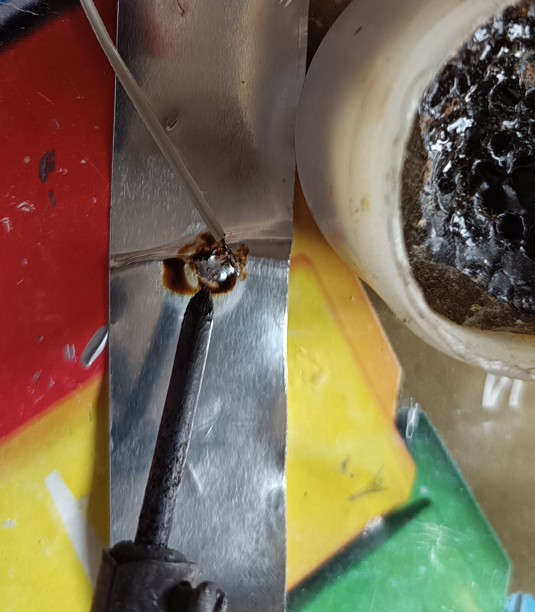

              • A wire can be easily soldered to aluminum foil. The foil needs to be coated with solder; this is done using a soldering iron and rosin flux. The rosin blocks oxygen, making the process successful.

                • Translation error. The coils are secured with strong sewing thread.

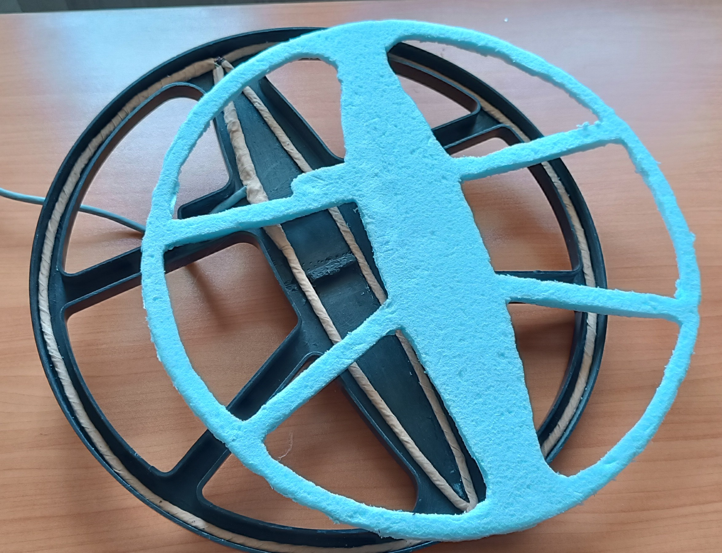

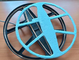

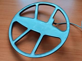

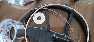

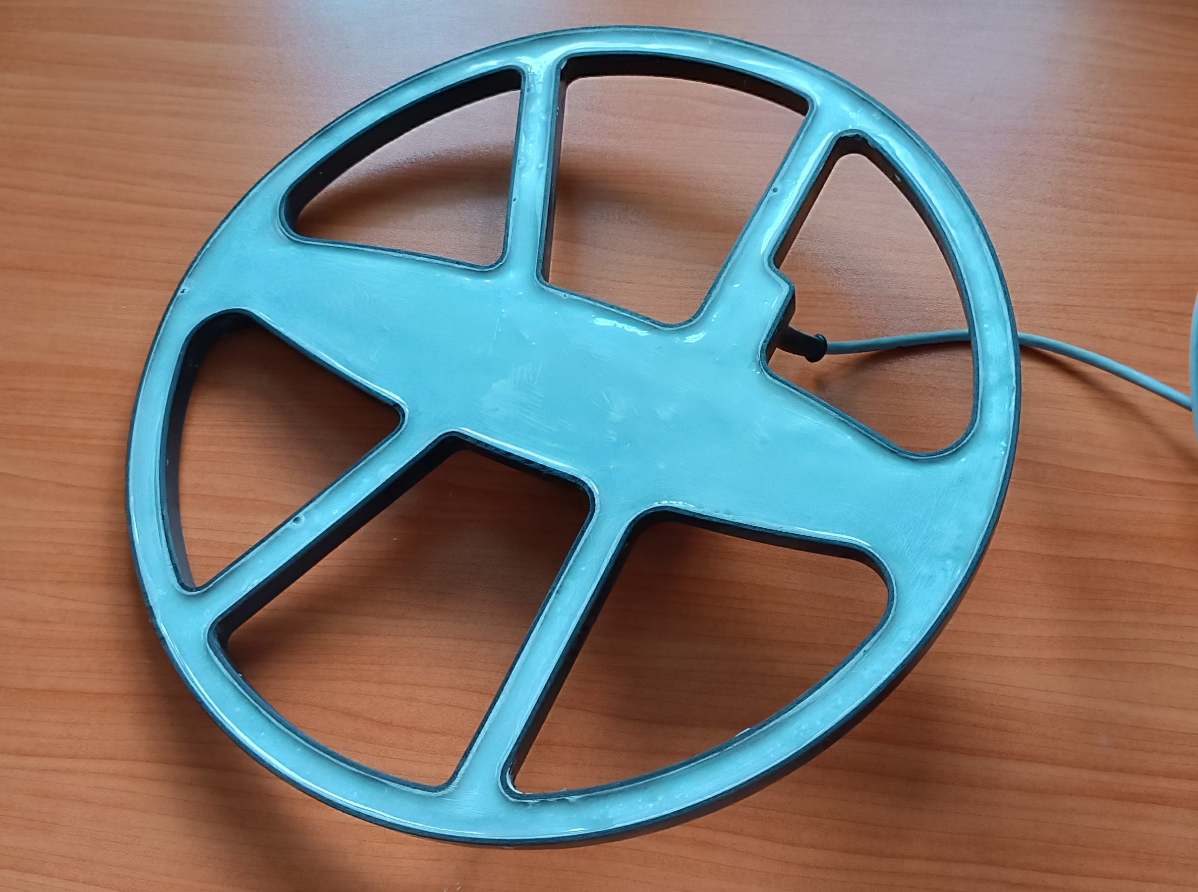

                        • You make a filler form out of extruded polystyrene (XPS) foam. Coat the coils and the form with epoxy resin. Position the foam. Apply a coating over the top with epoxy. And the lightweight coil is ready Click image for larger version

                            • Important! The surface has been roughened using coarse sandpaper to ensure a good bond with the epoxy resin.
