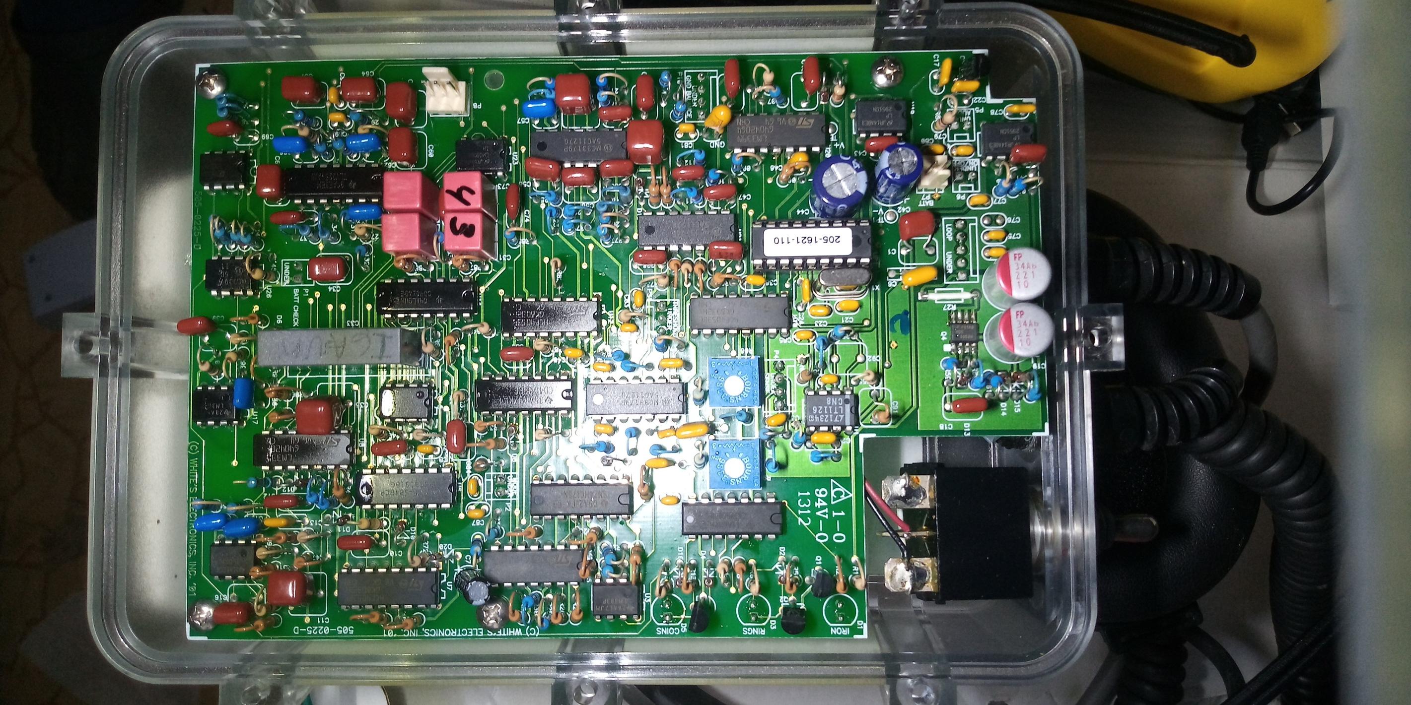

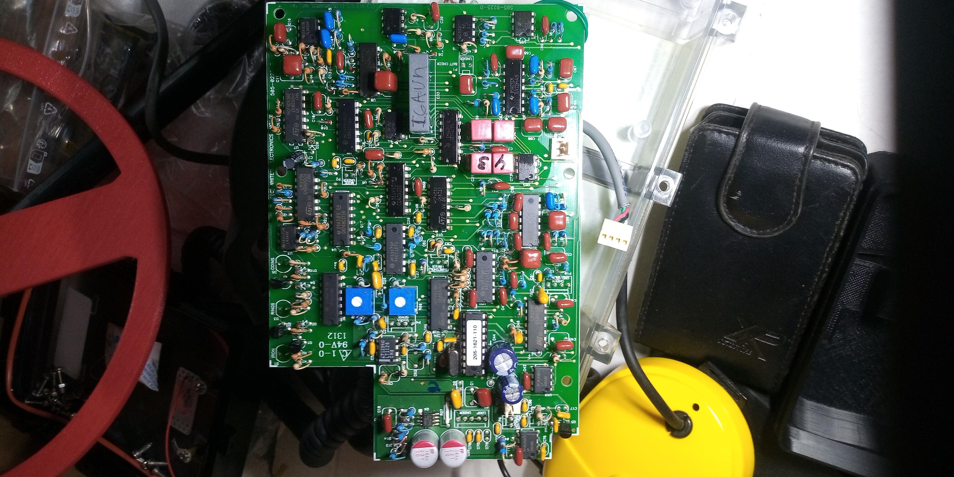

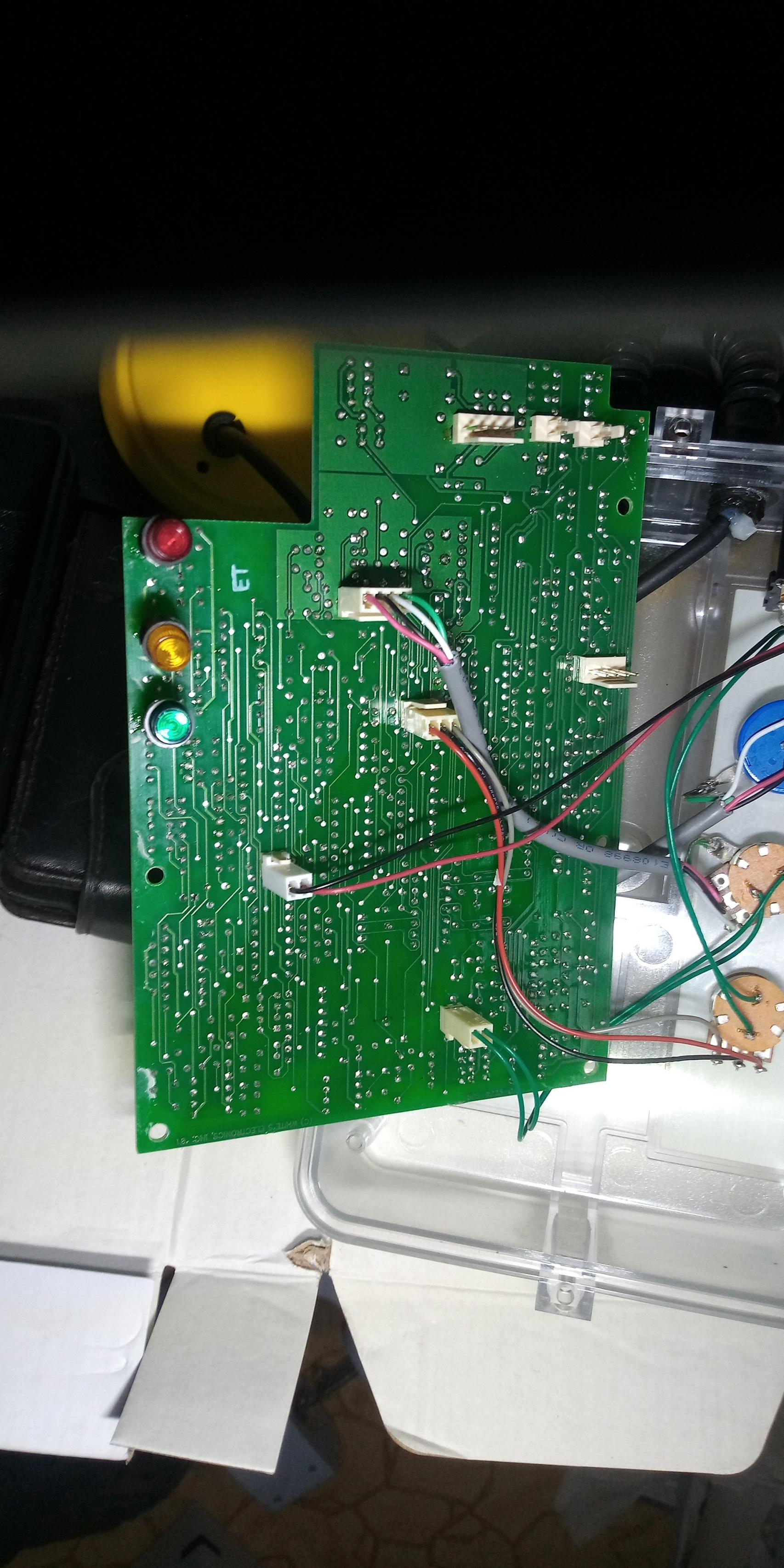

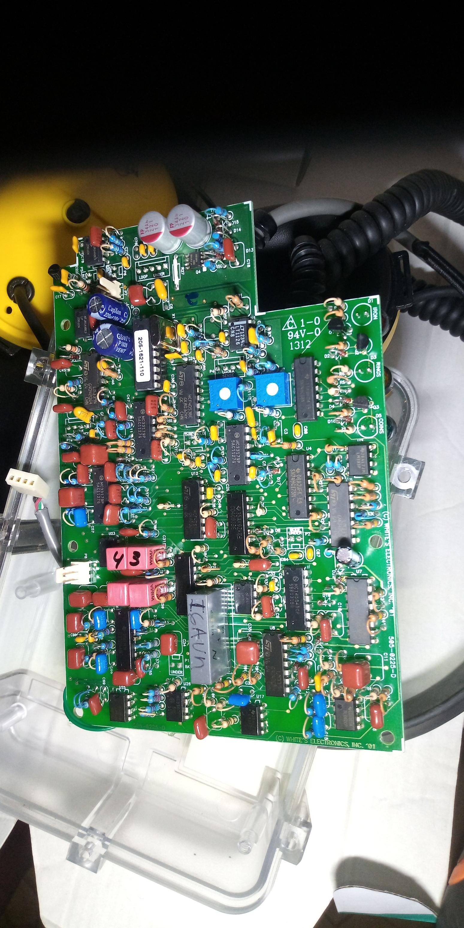

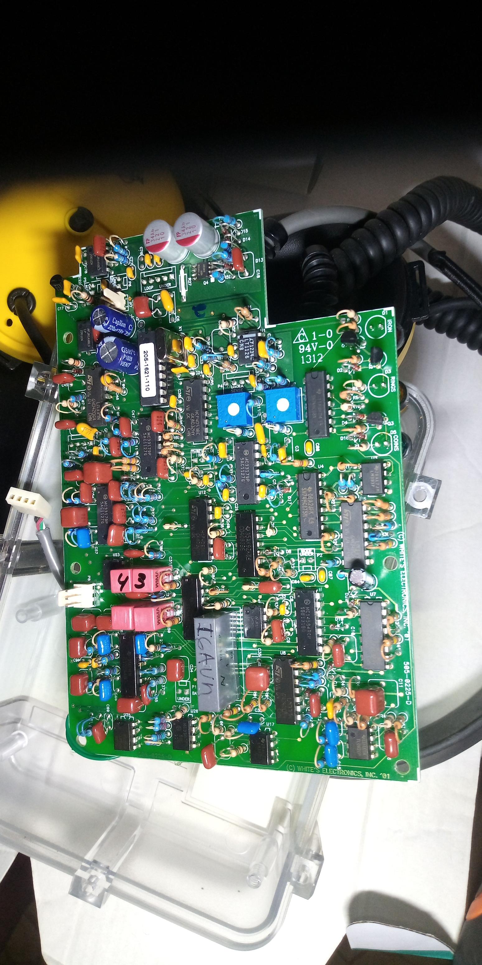

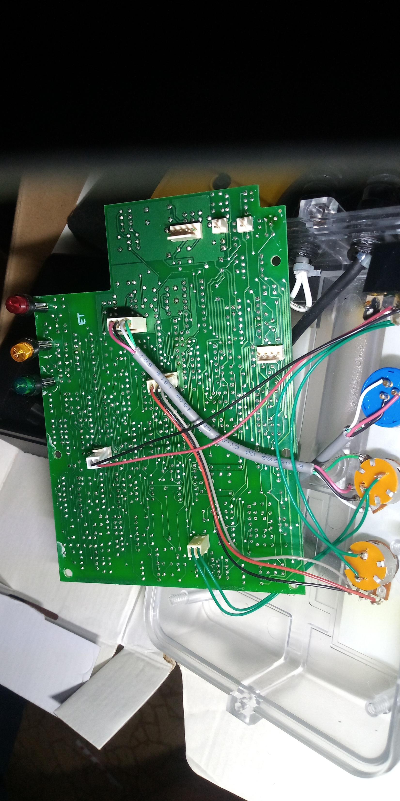

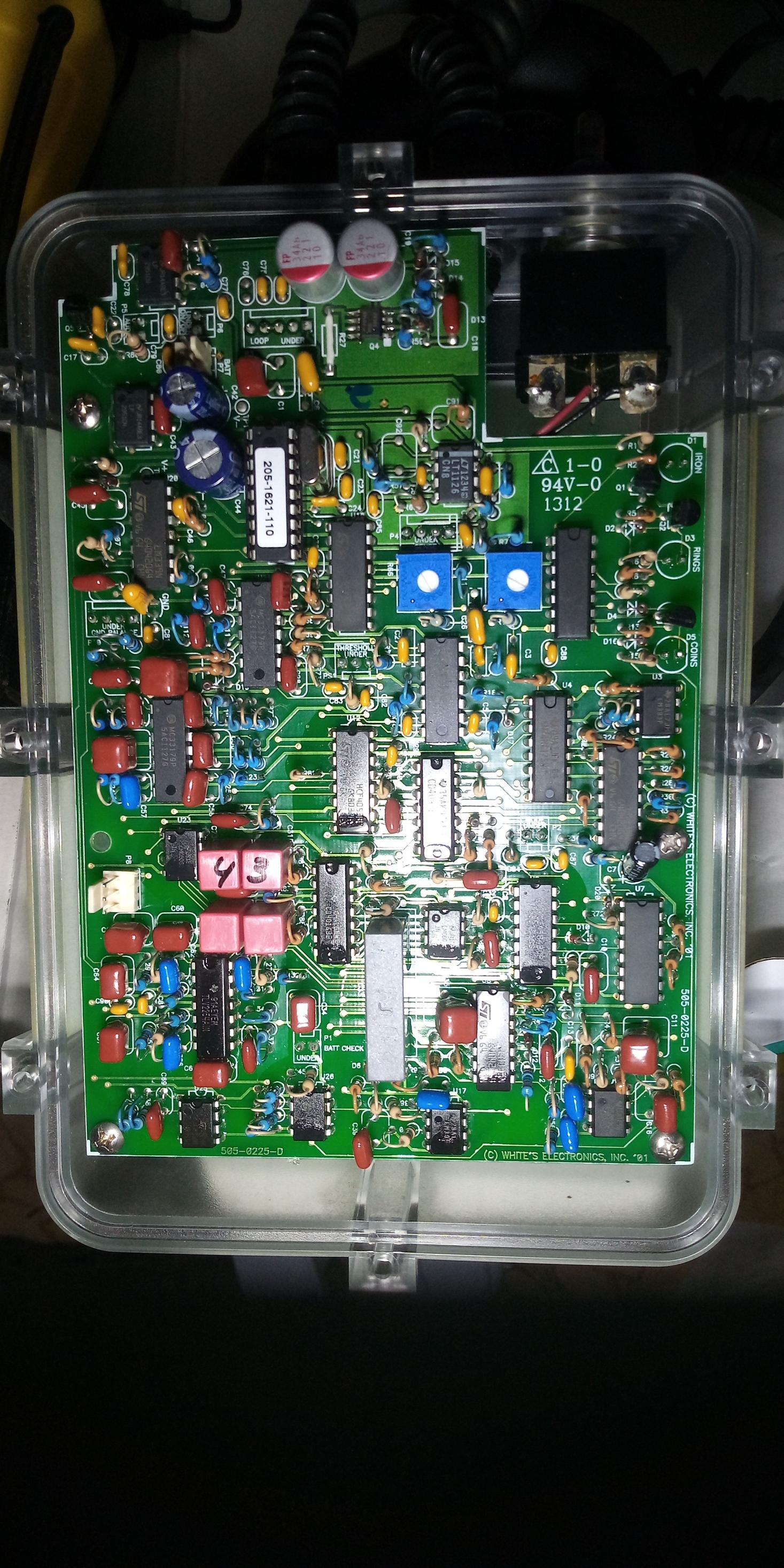

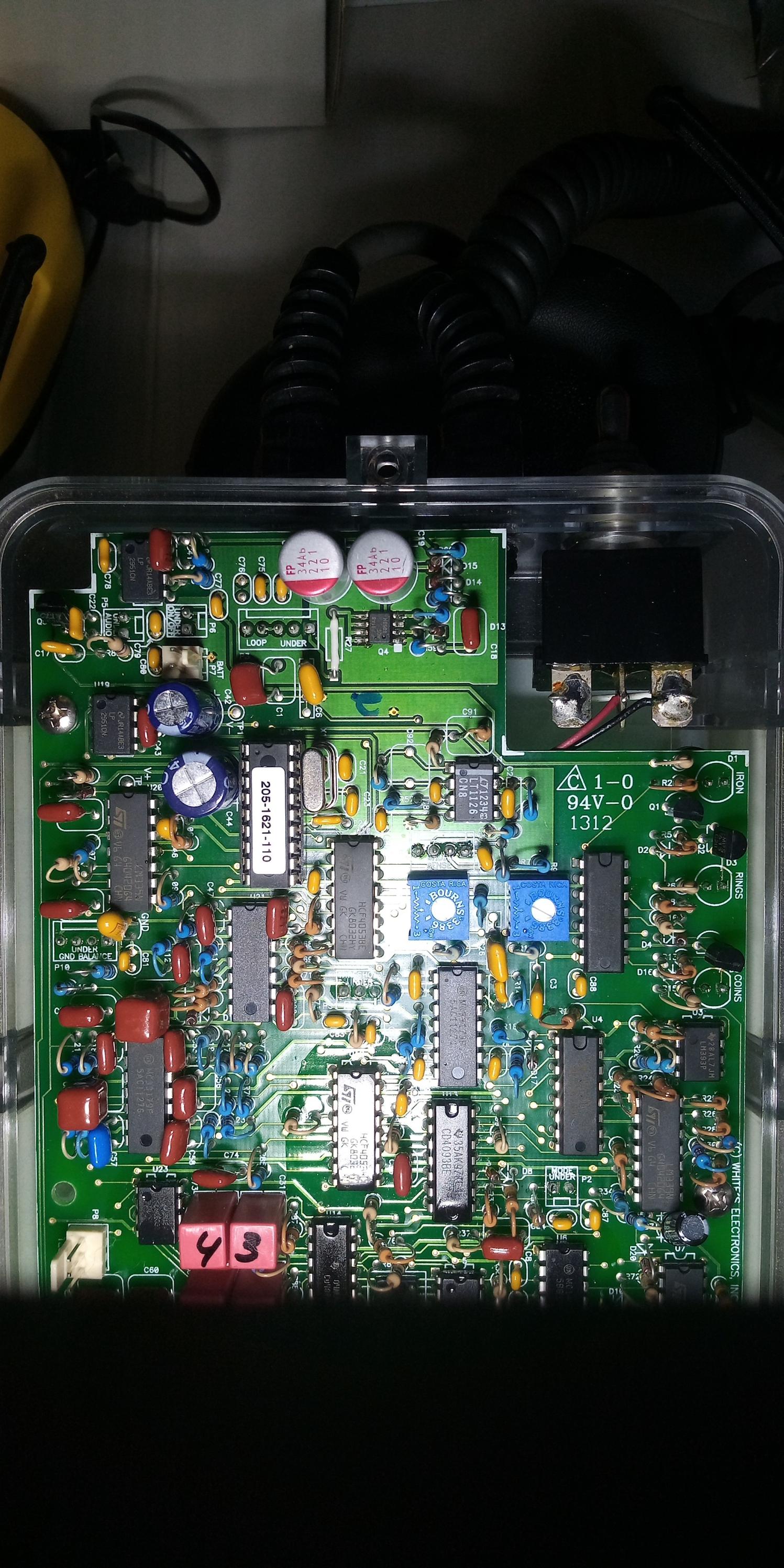

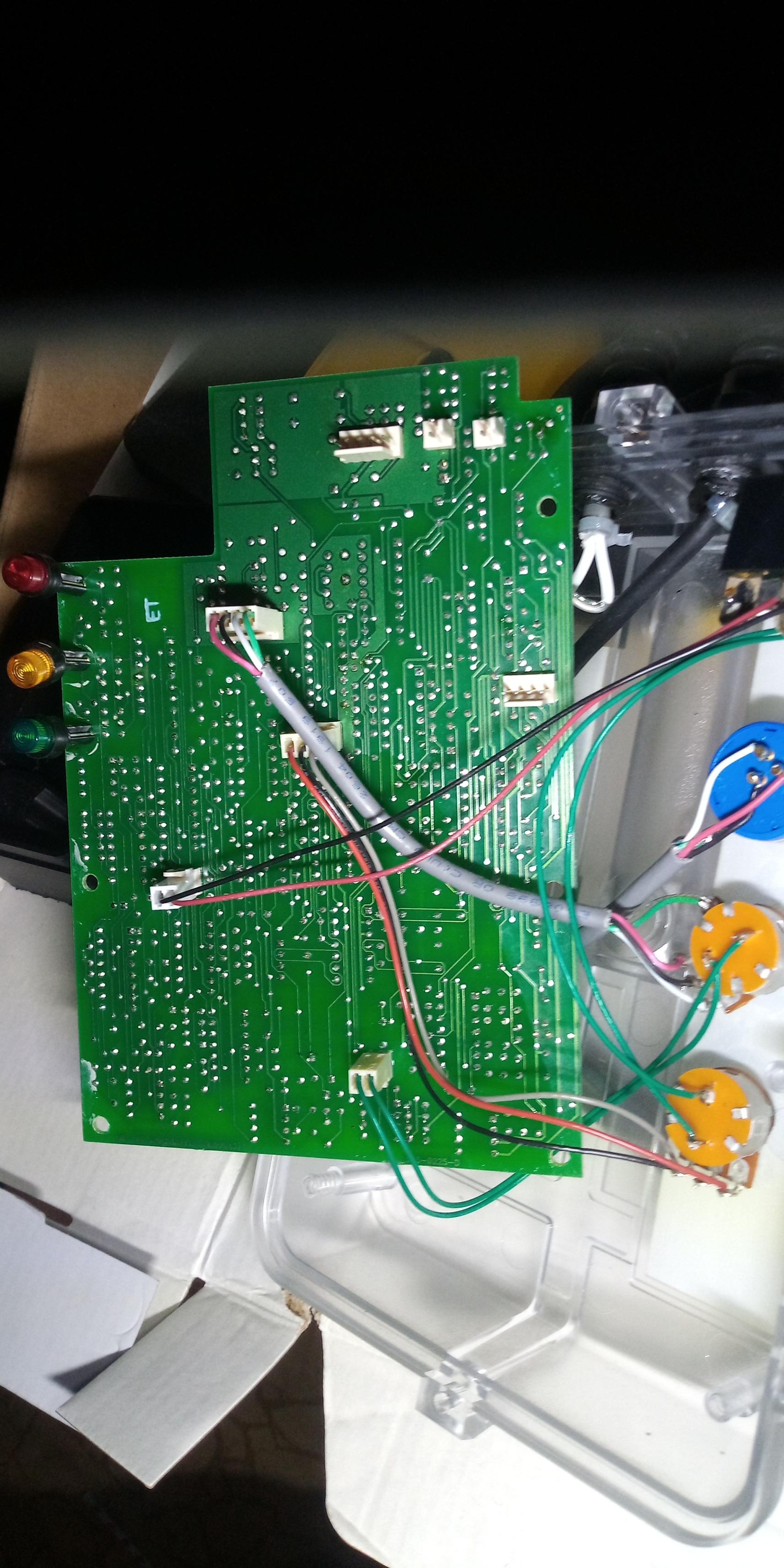

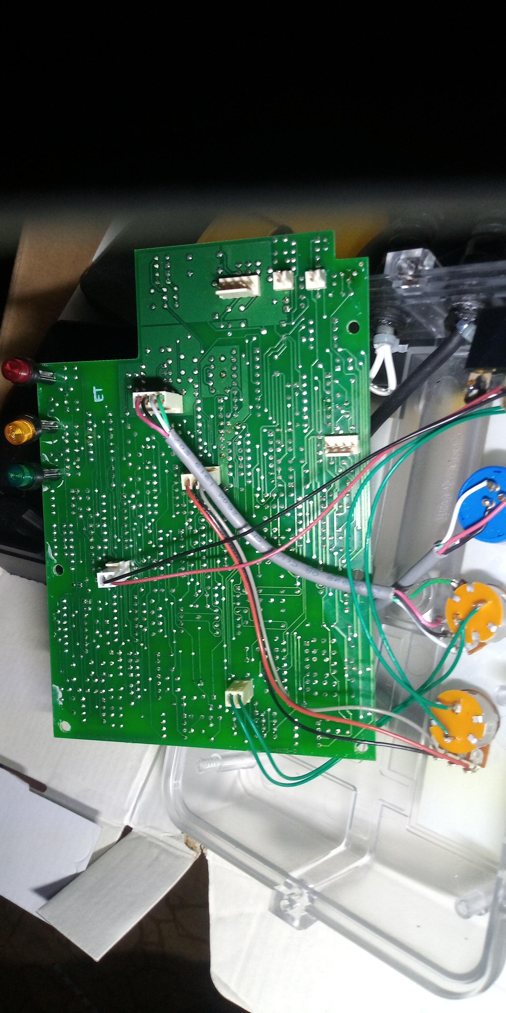

Tomorrow I will try to light the board better and take pictures from both sides. Write what else I can do ;-) (what I can do)
Whites Beach Hunter ID 300
Please choose the best ones.Attached Files- IMG_20260707_195605_886.jpg (557.3 KB, 139 views)

you have to look BOM file on Bara. so will seeOriginally posted by Altra View PostThanks for posting the parts list. Yes, you can substitute MC14584 with a CD40106BE. Can you check the markings for Q4? It is next to the red striped electrolytic capacitors. It should be a dual np mosfet. Thanks
40106 CD40014 SN74HC14
CD40106 MC40106 TC40106
HHF40106 HCF40106
CD4584 MC14584 TC4584
AN6559 K561TL2 K1561TL2
