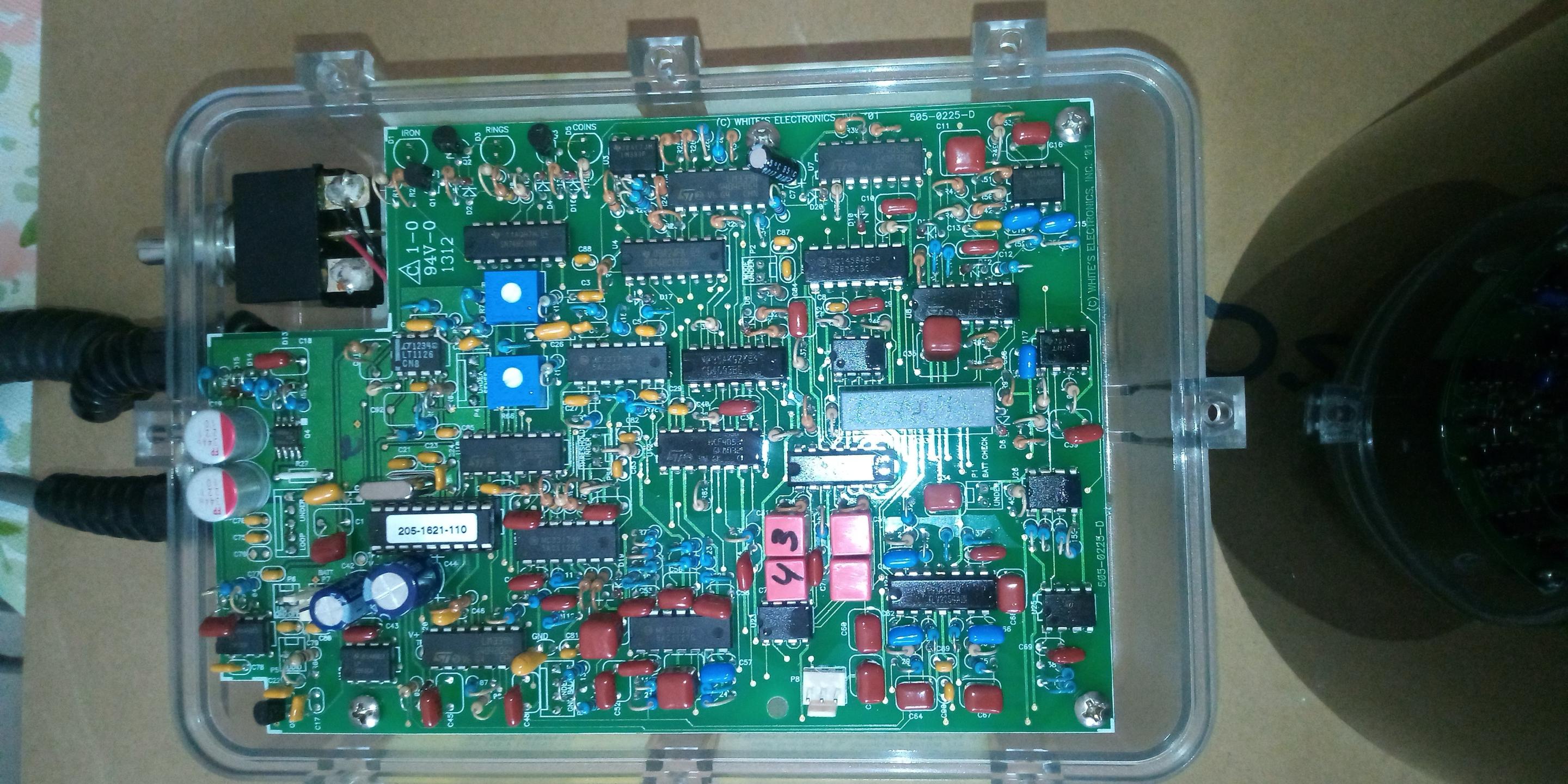

    Hallo.
    I have not schema, but I have got complet Beach Hunter ID 300.
    When help it, I try make photos motherboard ;-)
    Regards Martin

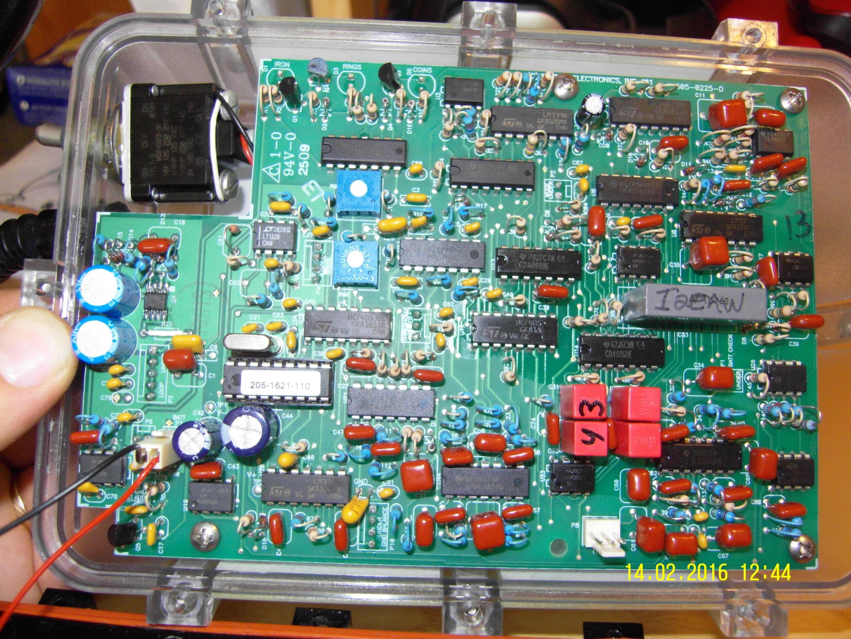

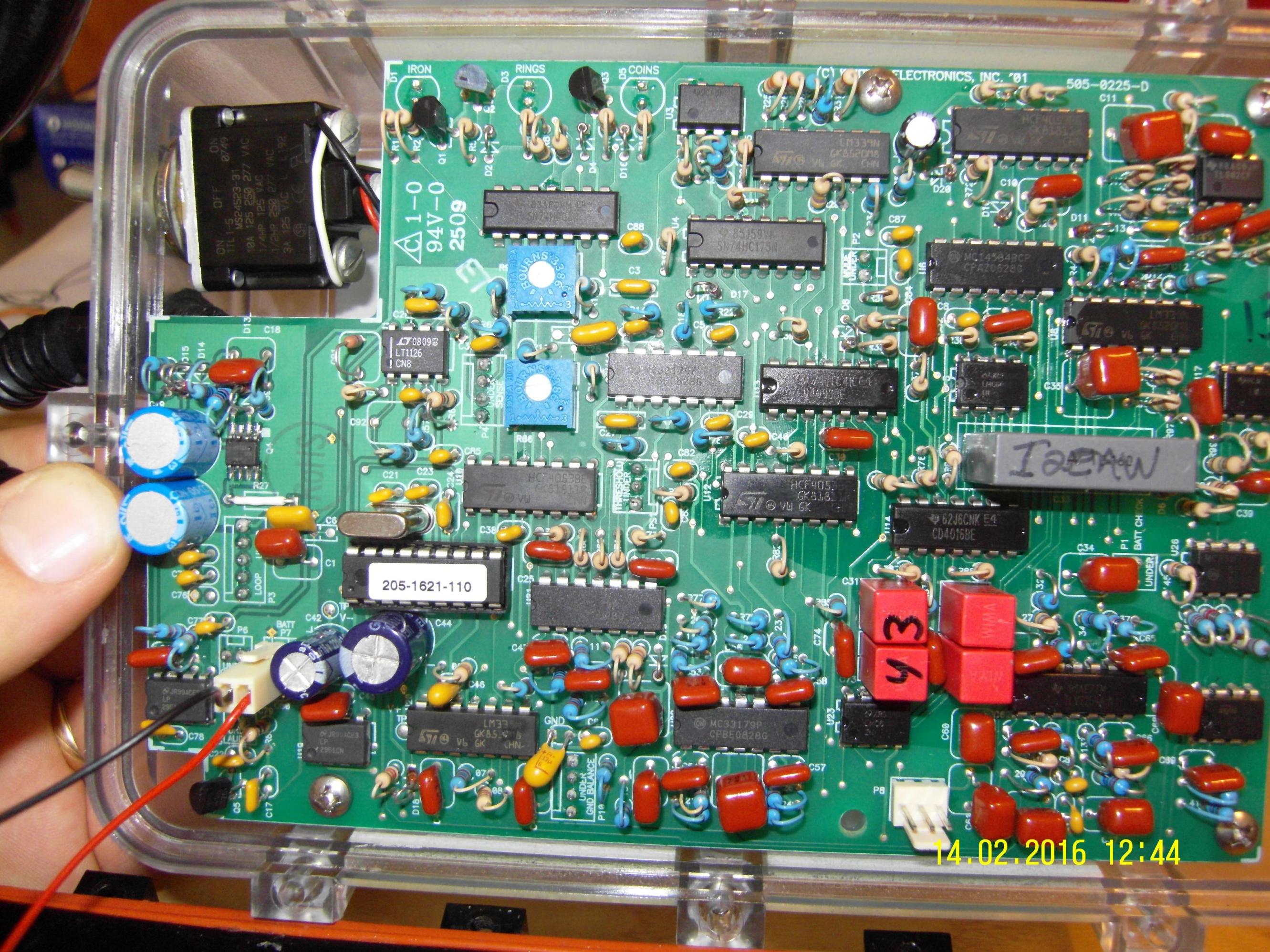

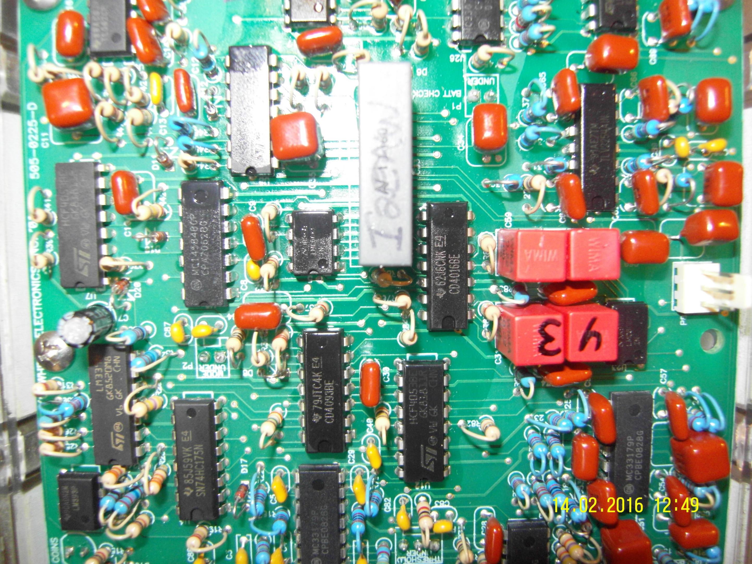

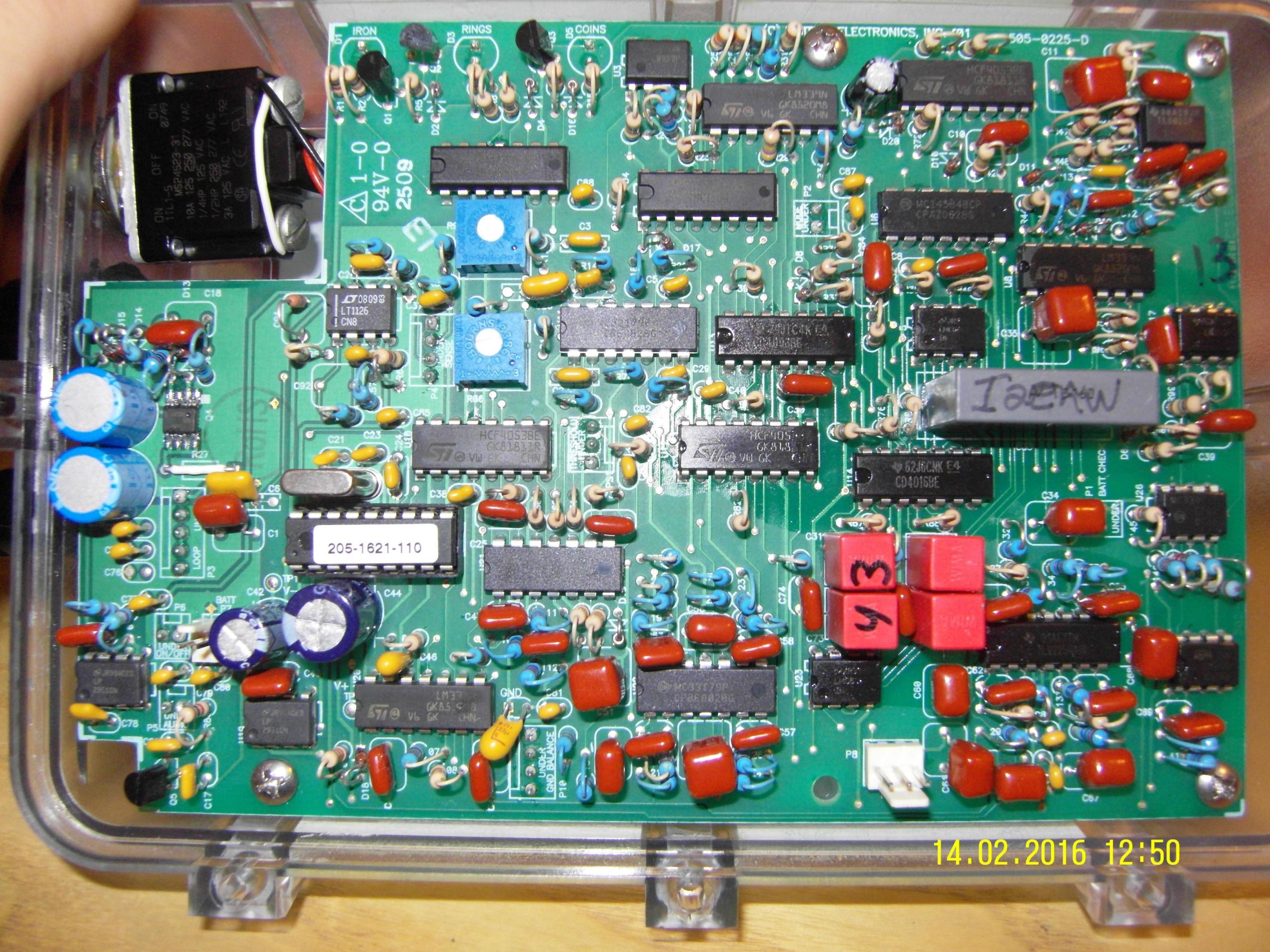

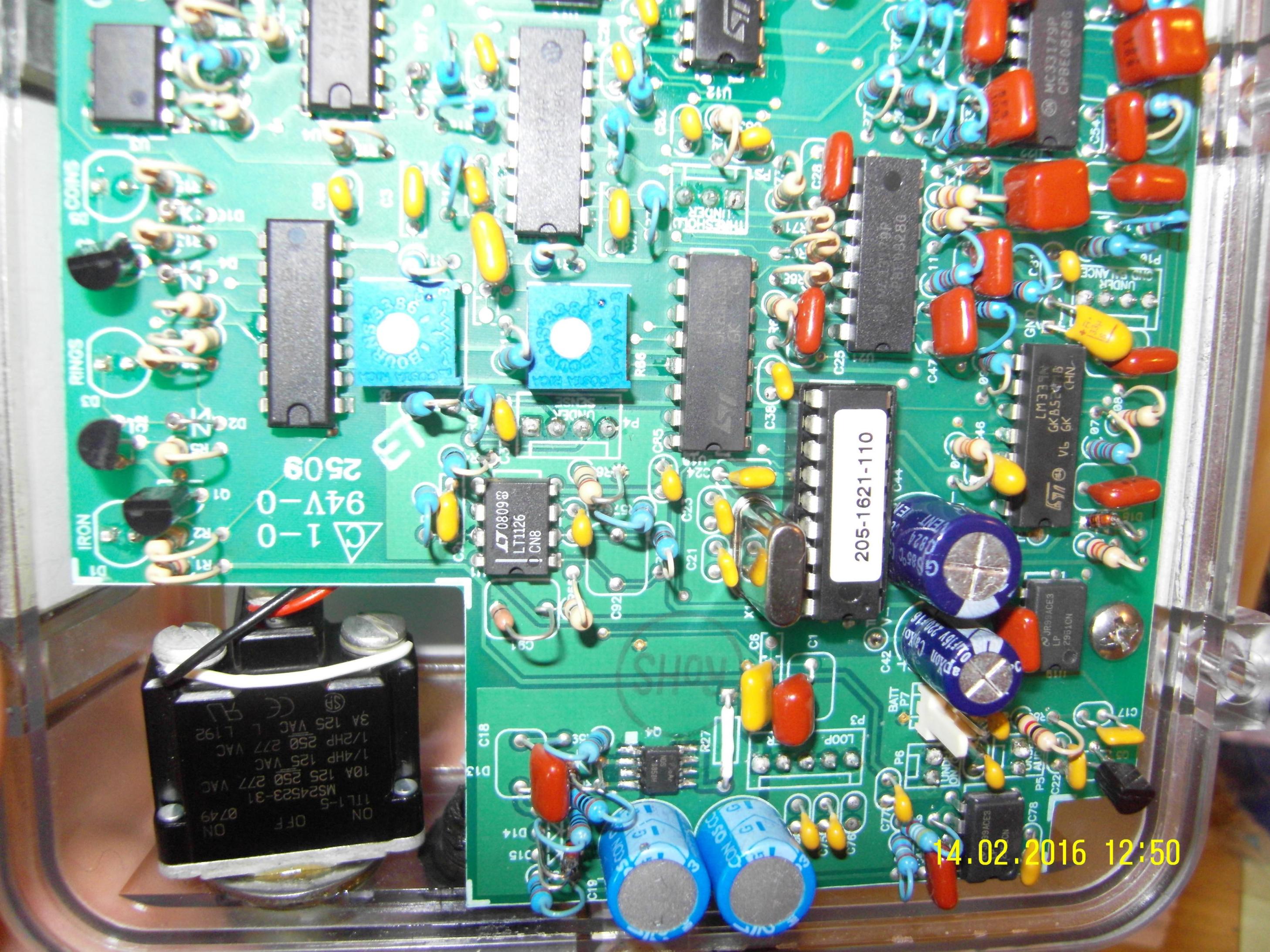

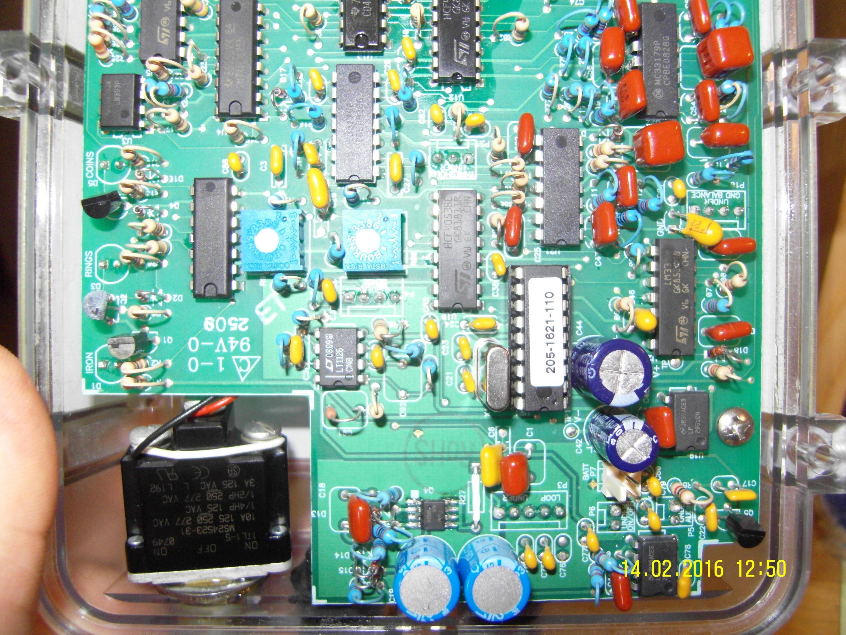

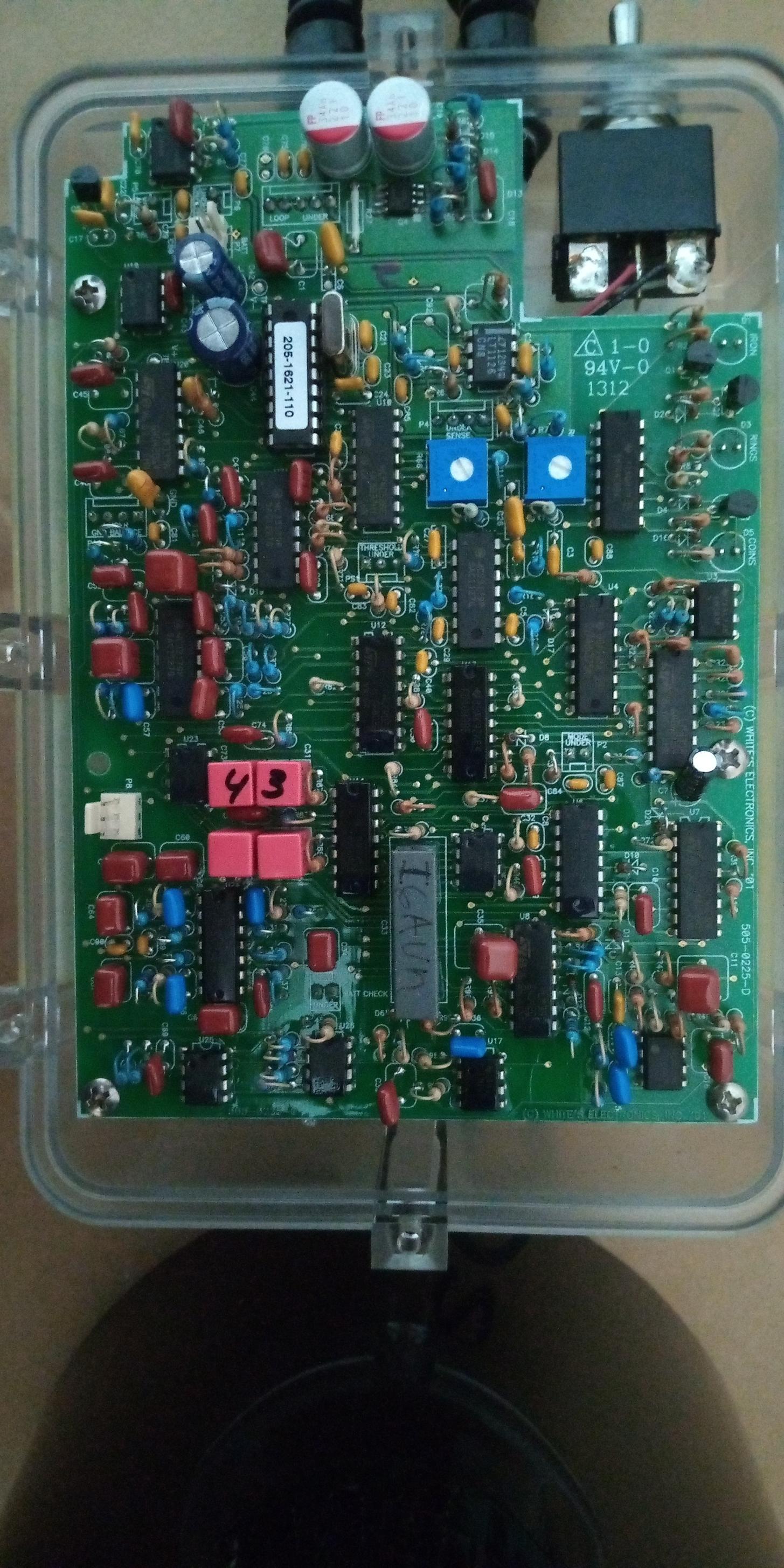

                    Hallo.
                    For all listing IO
                    U1 LT1126 CN8 E3
                    U2 SN74HC08N E4
                    U3 LM393P
                    U4 SN74HC175N E4
                    U5 LM339N
                    U6 MC14584BCP (ended) I think may bee changed for CD40106BE ?
                    U7 HCF4053BE
                    U8 LM339N
                    U9 TL062CP
                    U10 HCF4053BE
                    U11 MC33179P
                    U12 HCF4053BE
                    U13 CD4093BE
                    U14 CD4016BE
                    U15 LMC6081
                    U16 NDS8858H
                    U17 LM393P
                    U18 LP2951CN
                    U19 LP2951CN
                    U20 LM339N
                    U21 MC33179P
                    U22 MC33179P
                    U23 LMC6082
                    U24 TLV2254AIN
                    U25 LM358N
                    U26 MC33077
                    Regards Martin
                    Click image for larger version  Name:	IMG_20260705_114555_683.jpg Views:	0 Size:	572.3 KB ID:	450480

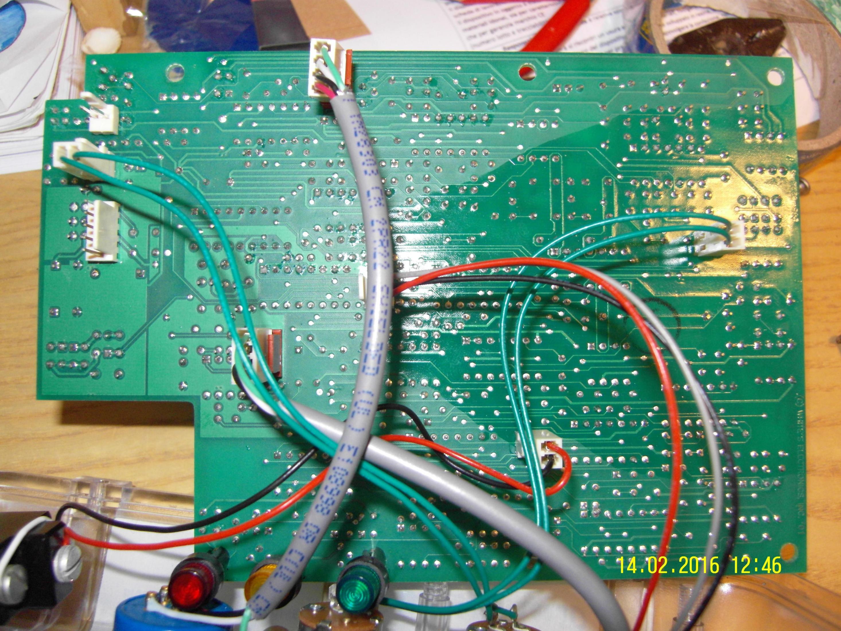

                      thank you WinstonW/Martin! nice Home Work. but please more light at PCB (Carl always on nerve if i ask to give more light somebody).
                        Thanks for posting the parts list. Yes, you can substitute MC14584 with a CD40106BE. Can you check the markings for Q4? It is next to the red striped electrolytic capacitors. It should be a dual np mosfet. Thanks

                            [QUOTE=Altra;n450483]Thanks for posting the parts list. Yes, you can substitute MC14584 with a CD40106BE. Can you check the markings for Q4? It is next to the red striped electrolytic capacitors. It should be a dual np mosfet. Thanks[/QUOTE
                            I marked q4 as U16 NDS8858H from the marking on the jumper
                            the processor in the socket is marked differently - should I remove its sticker to find out its marking?
                            I have just added U26 MC33077 to the IO list
