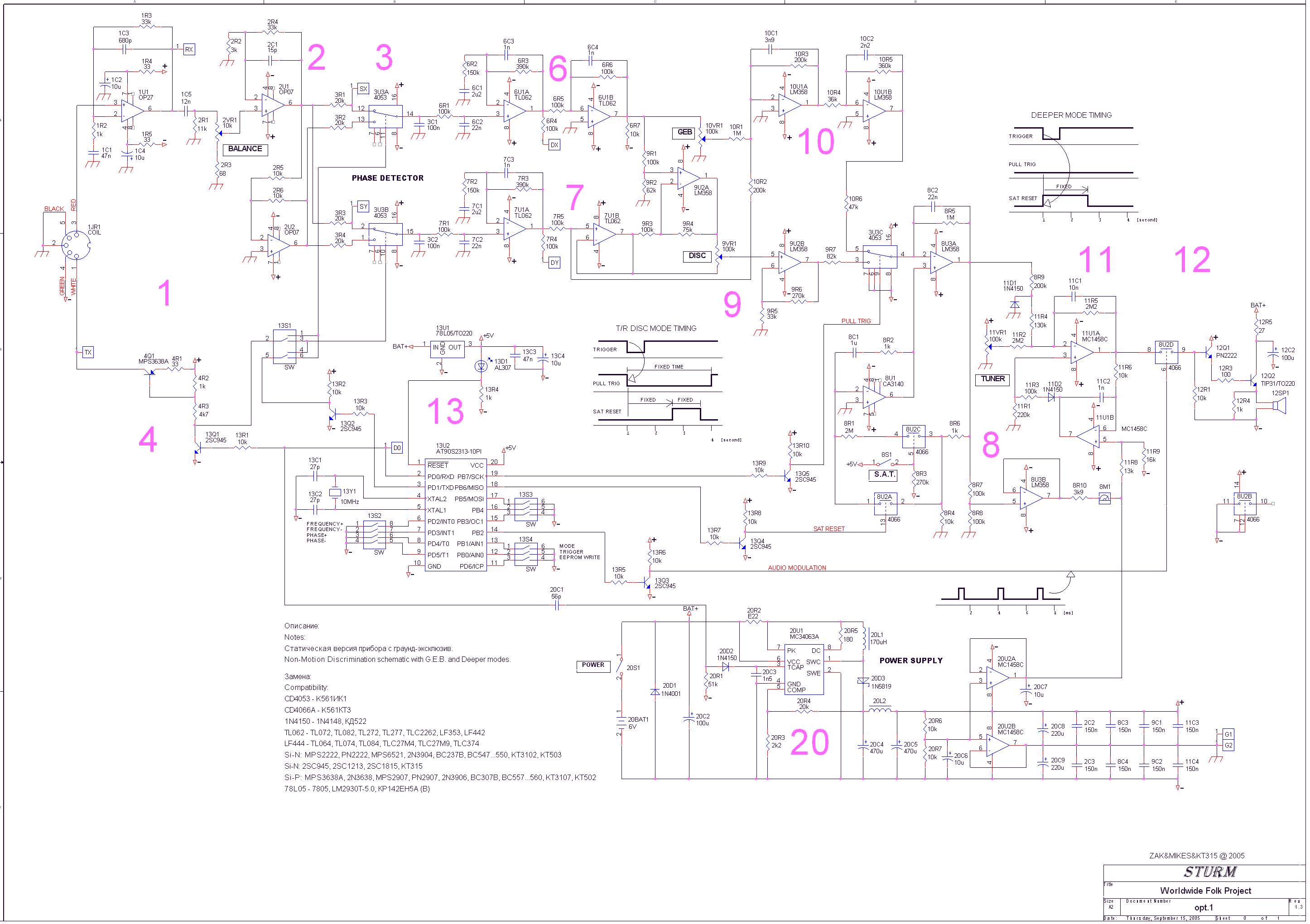

Metal detector with double tone and reject discriminator- new schematic
  • Metal detector with double tone and reject discriminator- new schematic
    This is the best variant:
    Tell me do yon see the schematik.

                  what about iron rejection...can it reject completely iron ??? bigger objects like pipes...etc ?

                    To Max
                    Iron rejection make op11 and d9. Reject completely iron.
                      TO Max.
                      Switch bi d9
                      audio diskr.=double tone discriminator
                      diskr.=reject. No tone for iron and Al foil

                        Hi sascho,
                        really interesting...
                        I mean : no tone/signal also when e.g. a big iron pipe is at 2-3cm ?
                        If it is so it's a wonderful detector !
                        Cause e.g. on bandido I can reject most of it but when object is great or at very few distance it could be detected easy as good target...
                        Best regards,
                        Max
                          To Max
                          That is right.Reject also ground minerals with doule ground channels.
