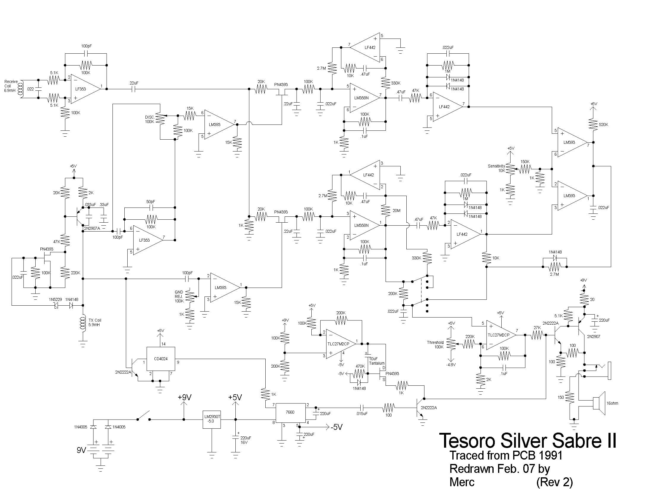

    Can anybody upload Cutlass II schematic ?
    Did you have any reponse ? I also own a Cutlass and i am trying to make a schematic myself but this is not easy because Tesoro used a lot of wires and via's.
    Leendert
      It is the same as the Bandito schematic except a few parts removed and a few wires in different places.
      I have a marked up Bandito schematic that shows the differences.
        Tesoro Cutlass 2

          Here is one of Carls Schematics marked up with Cutlass II notes.

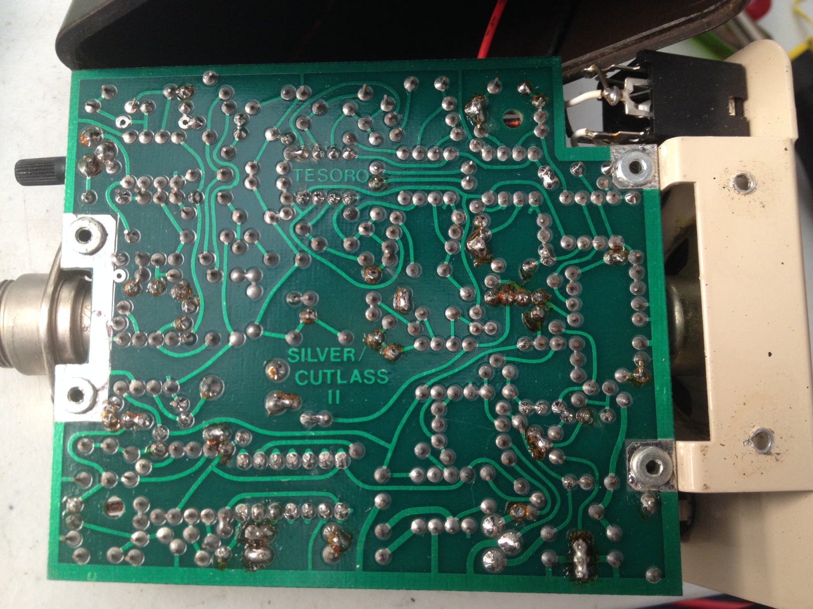

                    I have a Silver Sabre 2 and the PCB actually has printed on it Silver Sabre II/ Cutlass II as best I can remember. You may want to checkout the Silver Sabre II schematic.

                        Here's the one I have
                          this bottom side title sure say that cutlass2 and SS2 have one board.
