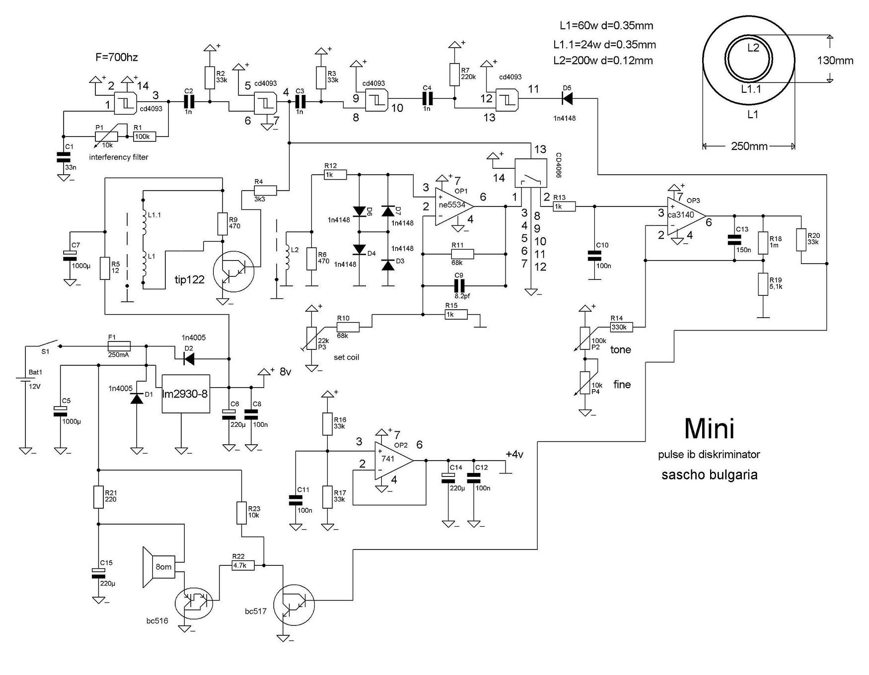

    I reposted the shematic again, as the waiting for the picture to download from www.imagehigh.com is somewhat boring.
    Original post is here:
    https://www.geotech1.com/thuntings/s...ad.php?t=12855
    Anyway thanks Sasho for this interesting circuit - looks like pretty decent coinshooter device.
    Questions that bother me:
    Whats the purpose of P3 (set coil) trimmer - how to adjust it?
    Can I use 9V regulator - any changes needed?

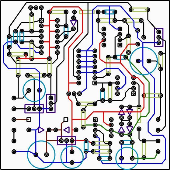

    I made the PCB (8x8cm, no-jumpers, one-sided)... hope it will work..
      To Leto
      No changes in 9v low drop regulator.
      Adjustment with search coil:
      P1 and P2 set to middle. Set P3 until sound appears.
      Depth is silver coin d=10mm in 15 cm.

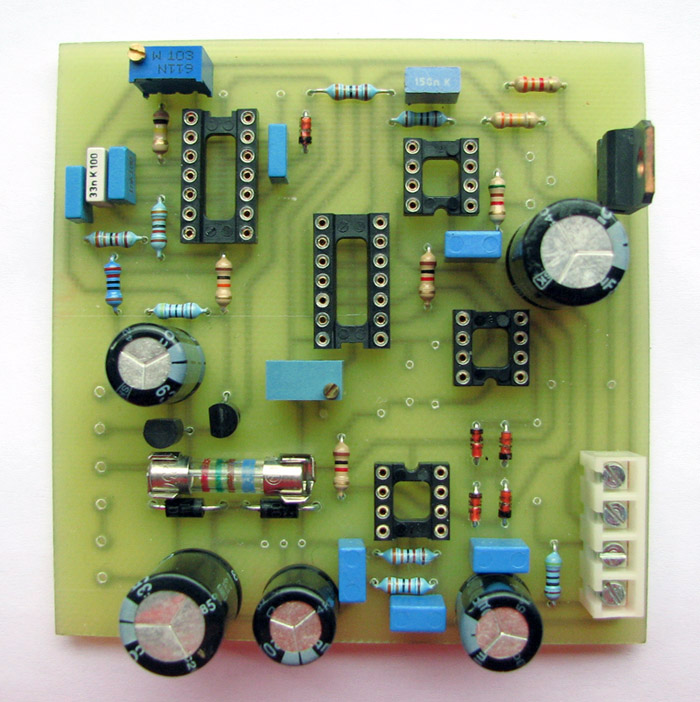

        Hi Sasho and thanks for fast reply..
        Board is finished but few components are still missing.
        Probably will test the device tomorrow.
          Warning!!!!
          Warning Leto !!!
          This pcb will never work, unless correct few mistakes! It will probably burn NE5534 at once! You mixed up supply pins on it. Switch them by cutting their connections and fix it up....Also another mistake; R21 and R23 goes to battery not to +8V....
          Those are mistakes i spoted so far....maybe more,maybe not....

            To Leto:
            Search coil has to be well compensated with L1.1.
              Damn...
              Hi Ivconic, thanx.
              True eagleye, as you spoted those mistakes.
              .. anyway I can not find that 9v low-drop regulator I thougt I had in my junque box. I have only "normal" 78xx ones.
              Will correct PCB and post it here ..
                To Leto
                Put 7808 regulator. Schematic will work in power interval
                10.5-12v.
                  close but no cigar...
                  Thanks Sasho, I folowed your advice with regulator ->
                  It works fine ... voltages are -4/+4V
                  I have corrected supply on 5534 and sound stage resistors.
                  BUT
                  oscillator does not work
                  Please recheck your shematic.
                  I do not have specified coil.. just took one simmilar from scrap
                  for testing as I can not see that oscillator is coil dependable..

                    It is OK
                    Schematic is OK! I made it and it works....1cm coin at 15cm distance...
                    I used 8" Fisher spider coil to test it, and it is working fine...
                    It is detecting only non-ferrous metals, so it is "discriminator" for real...Main drawback is when iron is near coin, it cant detect coin. Iron "blanked" coin and no sound in spkr. Of course this is due design itself...Reminds me (by behavior) on Bukaneer...i made once in the past....
                    Simple,small,cute experiment....not useable on many types of terrains...but still interesting to build it...
                    No errors in schematic Leto...
                    regards!

                        Hey Nelson...? Cant you see Leto's pcb? I made that pcb,only corrected supply pins at 5534.....Coil is original Fisher 8" spider coil.
                        Besides, Sascho already gave data for his coil here.....
