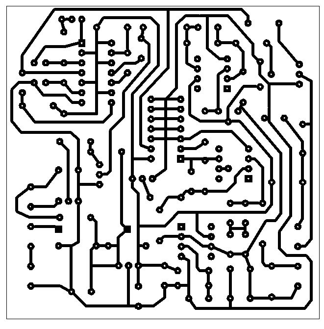

      hello
      hi,
      I have made this pcb
      • #63
        hi
        But can't understand where to fit the parts!
        Can someone:
        Leto,ivconic,sasho
        please post picture where I can see parts places??/
        p.s.R1,R2......;P1,P2......;+-batt...........................

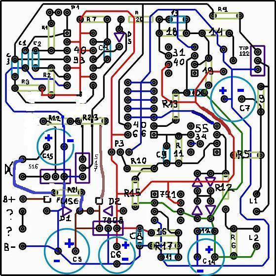

        • #64
          TO LETO,SASHO,IVCONIC
          Hello,
          Can you please check and mark whats missing on this picture?
          I cant understand why the C7 + goes in negative?Isn this capacitator reversed?
          • #65
            hi
            Sorry for ugly picture!!
            • #66
              HELP PLEASE!
              Hello,
              Are you all on a vacation or what???
              Why no one answer?PLEASE HELP
              • #67
                realy ugly!
                And I think also that something isn't righ here!
                Please someone that have make it share more it's conclusions!

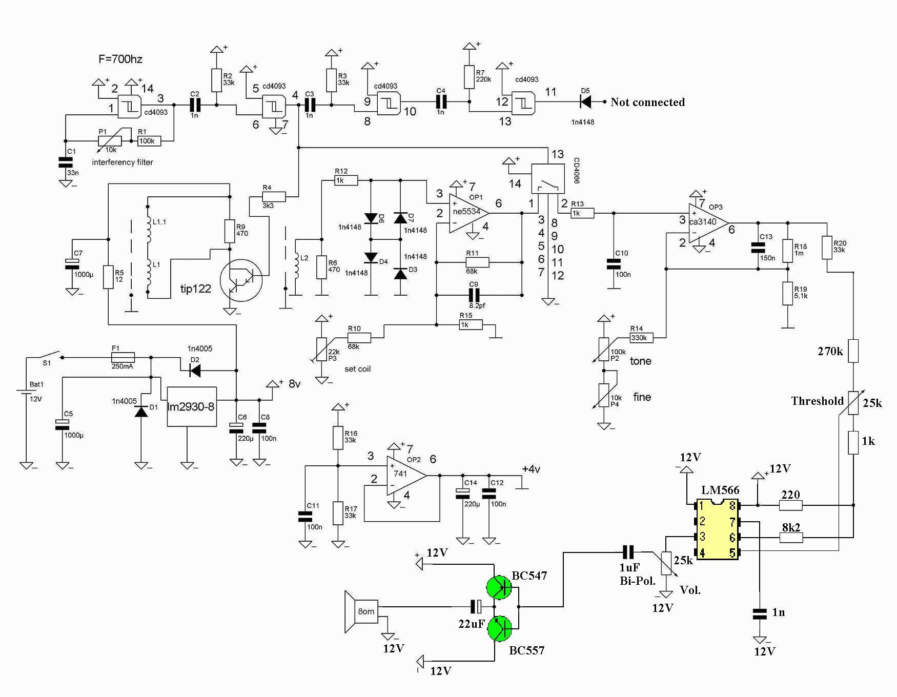

                      • #71
                        This schematic have mistakes.Look at speaker:Colector on BC547 is connected to +12V,but BC547 is pnp.Second wire of speacer mus bu connect ot GND,not to -12V.When tip 122 turn off,only 12 Ohms limit this spike.
                        • #72
                          Eh ?
                          BC547 is PNP now ???
                          Maybe for mineoro's designer that's so ... !
                          Or have you looked at arrows in drawing ?
                          There is the little mistake.
                          Best regards,
                          Max
                          • #73
                            NVM try Google and BC547
                            Sascho and Ivconic, WHAT A BRILLLIANT DESIGN!! I had two old defunct Fisher 1265's, which now are 100% PI discriminators.
                            A couple of questions though; What are the extra capacitors after the delay stage for, I mean the bit that goes to "no connection"??
                            What about a variable delay for adding a discriminate of sorts? I would try this but right now the two machines I built have been borrowed by my local club. A LOT of people ae interested in having these machines built.
                            Anyone know of a source of CHEAP Fisher search heads??
                            • #74
                              BC547 is NPN, BC557 is PNP...!? Of course!
                              Even arrowas are correct, only you cant see those clear, i had to rescale .bmp to .jpg and lower resolution to suit this forum demands and my dial-up limitations.
                              But hey, you dont need to look at arrows at all, i already noted BC547 and BC557....? Didnt i?
                              Schematic is accurate, no mistakes..Mod is working perfect.Pulse IB is worth of making, it is good,nice little design. I advice you to make it and see...
