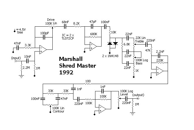

            Max, question for you;
            right now i am making some guitar preamp, it is finished and working good.Next step is distortion. I made Shred Master from Marshall. It is working but...sound is much attenuated when Shred is ON. When switched OFF sound retreives at normal level???
            Yes, i know that there must be some attenuation, since signal always have some losts when put through some filter (dist.) but this one has big lost???
            I rechecked all, schematic, elements....All seems to be normal.
            Maybe i used wrong type of capacitors??? I used ordinary, first i had handy..
            Any experiences?

                      about the marshall effect I have no direct experience with it, but think you could have a bad component value.
                      Saw many times this stuff, very common some years ago, but never opened one.
                      Yes there's always some attenuation but if is too hi there's something wrong in the circuit.
                      Anyway, that's the schematic I've found.
                      It's the same you have ?
                      Kind regards,
                      Max

                        Yes Max, i did my dist. according to that schematic....It si working but not good....

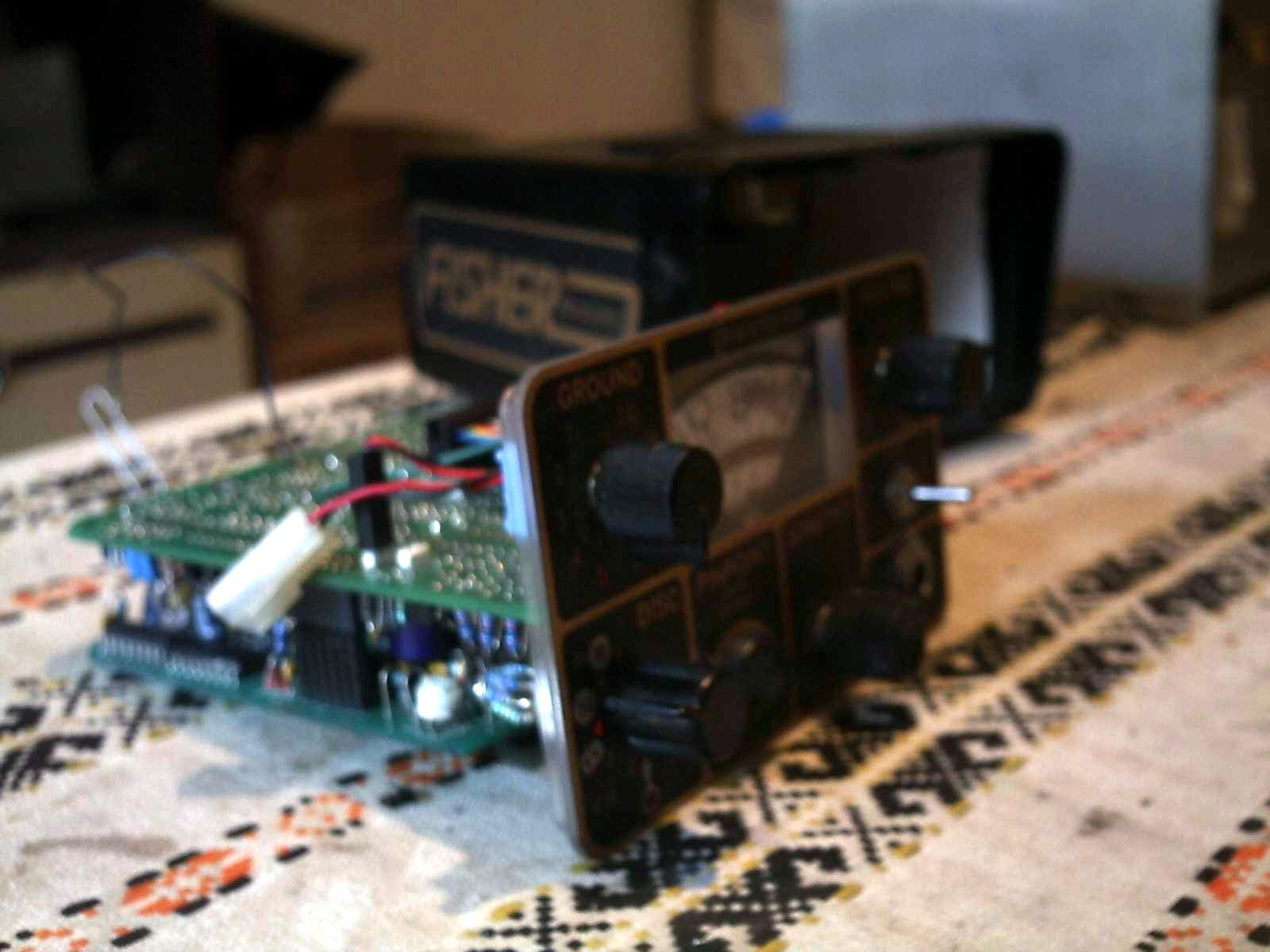

                        • Souvenir...
                          I still have photos of it...as souvenir! Looking at those suddenly become sad...!
                          • Ivconic, I keep a bunch of good quality photos of CZ-5's PCB. if you need...
                            I had seen it inside... because I did take fix out CZ-5...
                            yours

                              • KT315 i have to much photos....whenerver i see photo of some detector i had and later sold, feel sad about it....My finances not allowed me to keep them all. Last few years very hard living here, so i had to sell many of them to collect money for everyday things - to survive! So i rather skip viewing those photos oftenly....
