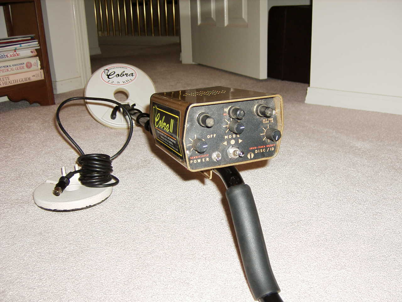

          Geo , Check your e-mail . I wish I can find the schematic for the detector pictured below. Eugene

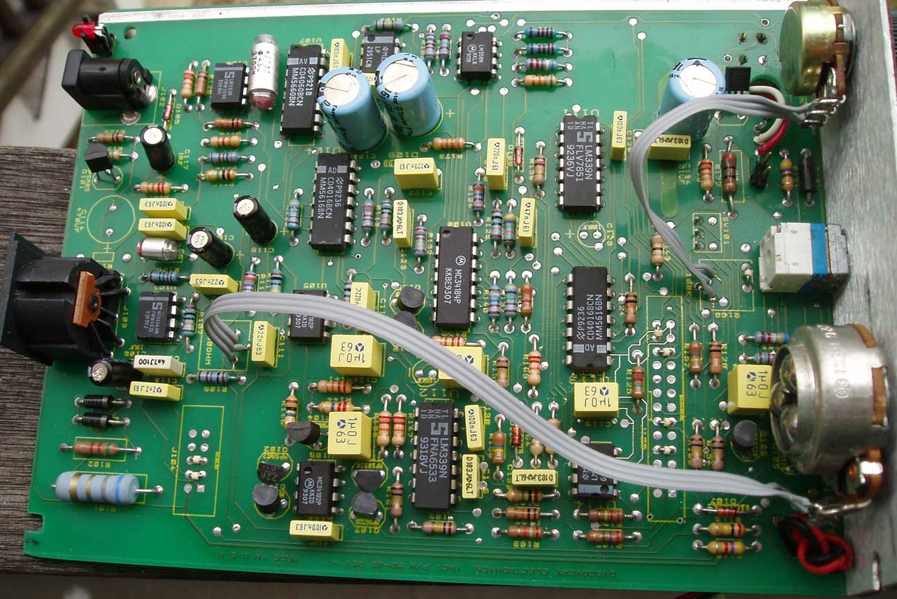

                  PD3200 board
                  Does anyone have correct dimensions for pcb?
                  And has anyone dimensions for skif pcb? kokokokoolov is impossible to reach.

                      Hi Sean,
                      Got most of the files from the internet wayback archive. Just need the PCB dimensions to print direct to transparency then to board, (could probably waste a lot of paper printing out until got the right size).
