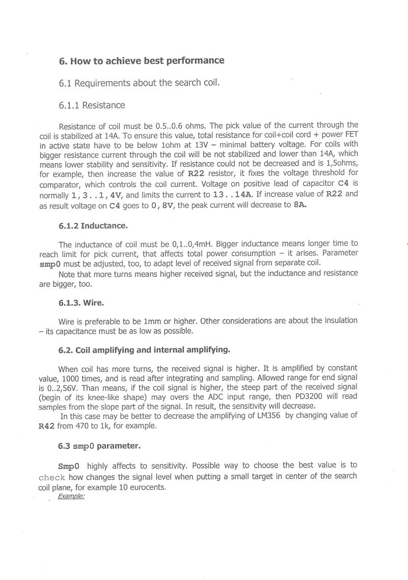

                        coils..
                        Geo,
                        You can use large variety of coils for PD3200 - depends on what you want.
                        .. there is no recipie for one and only best coil...
                        Kasnimir gave folowing data for suitable coils:
                        1) Diameter 38cm, 20 turns, 1mm-PVC insulated wire (390uH)
                        2) Diameter 25cm, 25 turns, 1mm wire (380uH)
                        I've made lots and lots of coils just for experimenting with PD3200,
                        and my best coil is spider-web wound, 25cm diameter, 310uH, threaded wire 0.75mm.
                        results -> 50 Eurocents at 35cm!
                        But as you say: experimenting will be the best to find out what you want.

                            Do you have the manual of PD3200

                                Hi Geo,
                                For now I found only paper-copy of the manual for PD3200.
                                If someone has original .pdf file please post it here.
                                Normally the main time delay for PD3200 is 30..50us and depends on induction and Q of the coil, also the time of sampling is long (time to integrate the incoming signal).
                                Only change I made to the original were newer low-coss FETs.
                                Also the mosfet resistance Rds(on) should be as low as possible.
                                I used two paralleled ZXMP4A16G mosfets.
                                Another thing: flat wound coils (or spider-web, or Basket weave and alike) really
                                are much better for low frequency PI's as the shielding is not mandatory.
