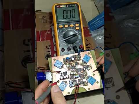

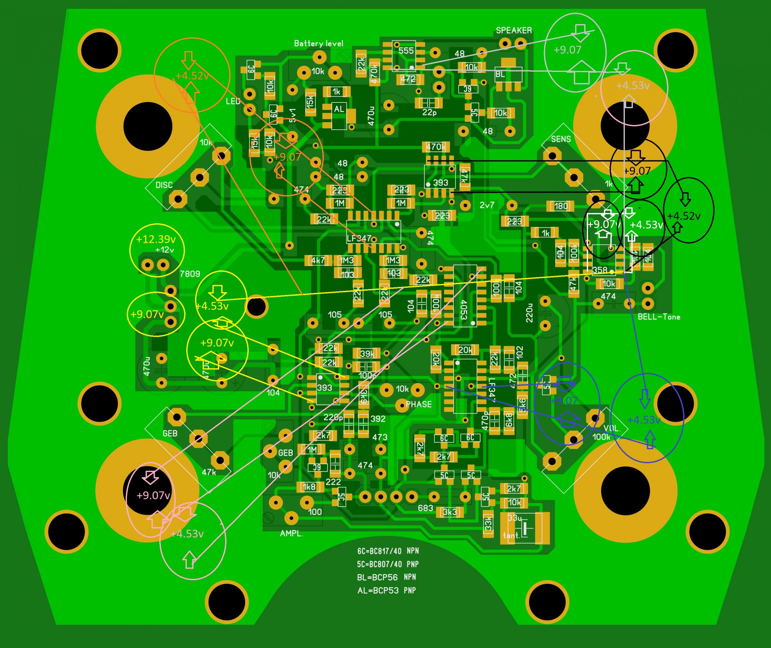

Looking your draw and video; i see no problem with voltages.

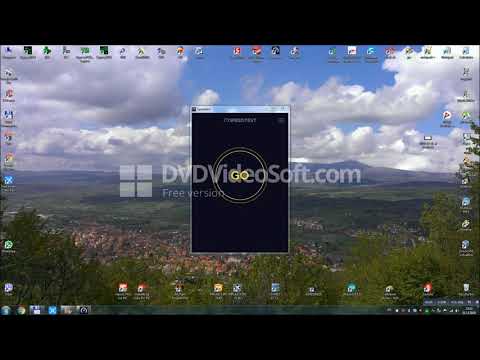

Everything seems fine with power supply.
But also i see and hear lot of noise on pcb, self oscillations and sensitivity to your presence and touching some parts.
Looks like some ground is missing there... but how to find it?
Something is terribly "ringing" and oscillating on pcb.
You did few things on pcb unlike i expected and planned, when i drawn it.
You put through hole components on the same side as SMD components.
Also you put potentiometers backwards.
And what's even worse; you used plastic cased potentiometers and now those are acting like "antennas".
Reason for 4 holes on pcb, for potentiometers; connected to minus (minus is "ground" here, although there is virtual ground too, generated by LM358, to split power supply by 2)...
so reason i drawn wide copper areas around holes for potentiometers is to use metal case potentiometers (put through holes from opposite side than what you do) and to screw them hard and to "minus" (ground) their cases good.
If you used metal case pots; the cases would also act as "ground" and "cage" for signal paths.
Also. like i said (and explained much earlier); "yellow" components should be put from the opposite side of the pcb than SMD components.
All except 7809.
Because main traces for those components are done on top layer, easier to solder them on pcb without metalized vias.
Now you have problem there. There is obvious break in some ground path and now is much harder to trace it out.
I will repeat; when i say "ground" i mean minus. Battery minus. It is "ground" in particular case. For "grounding".
And also there is virtual ground, generated with LM358, but not used for "grounding".
Please don't mix those two.
So, hums, self oscillations and noise on pcb; most probably came from some broken path, missing solder (via maybe) and above all amplified by plastic potentiometer cases and through hole components put on wrong side.

I would try to find broken path by tracing signal paths from frontends to last stages, using osciloscope.

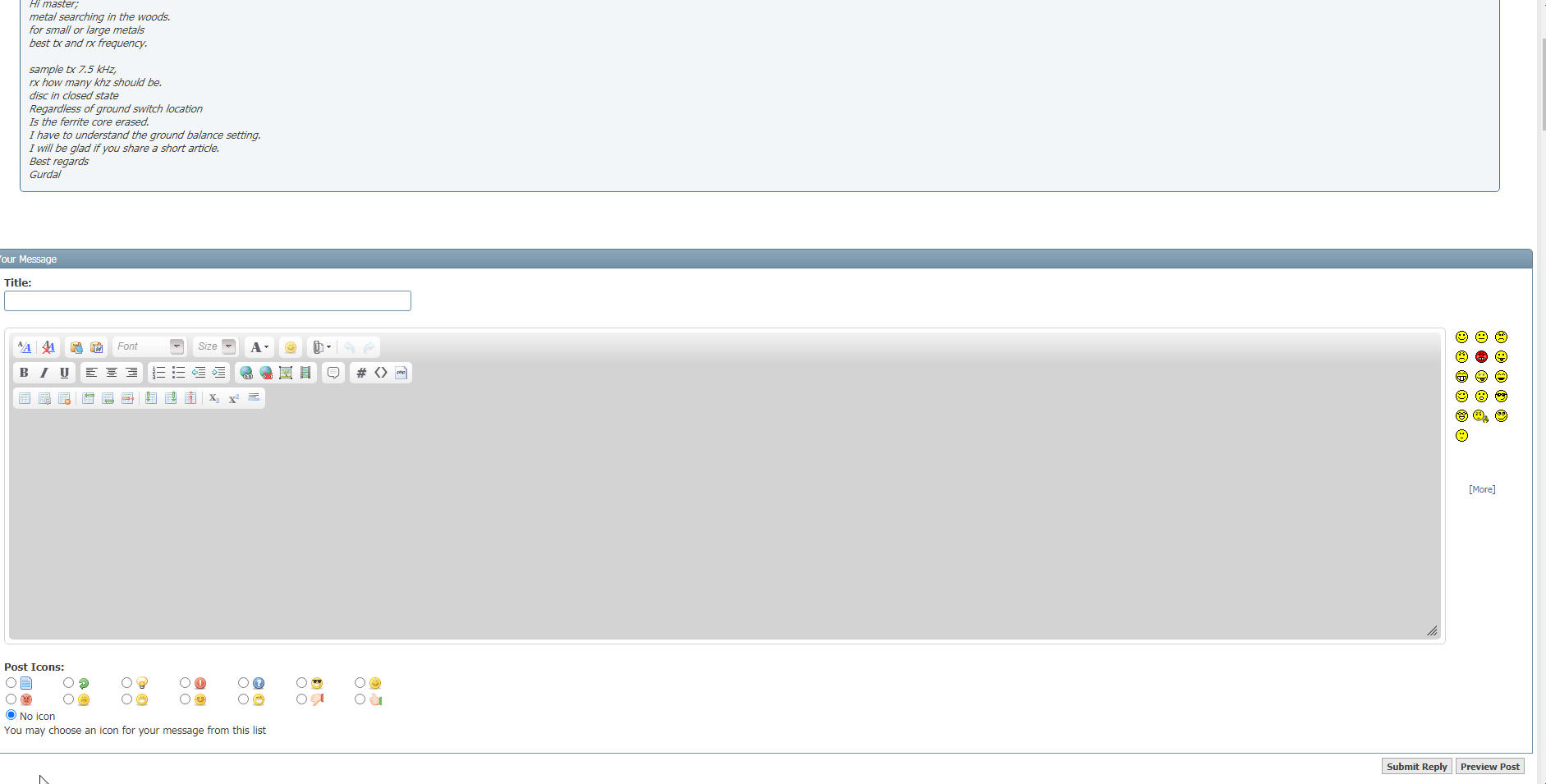

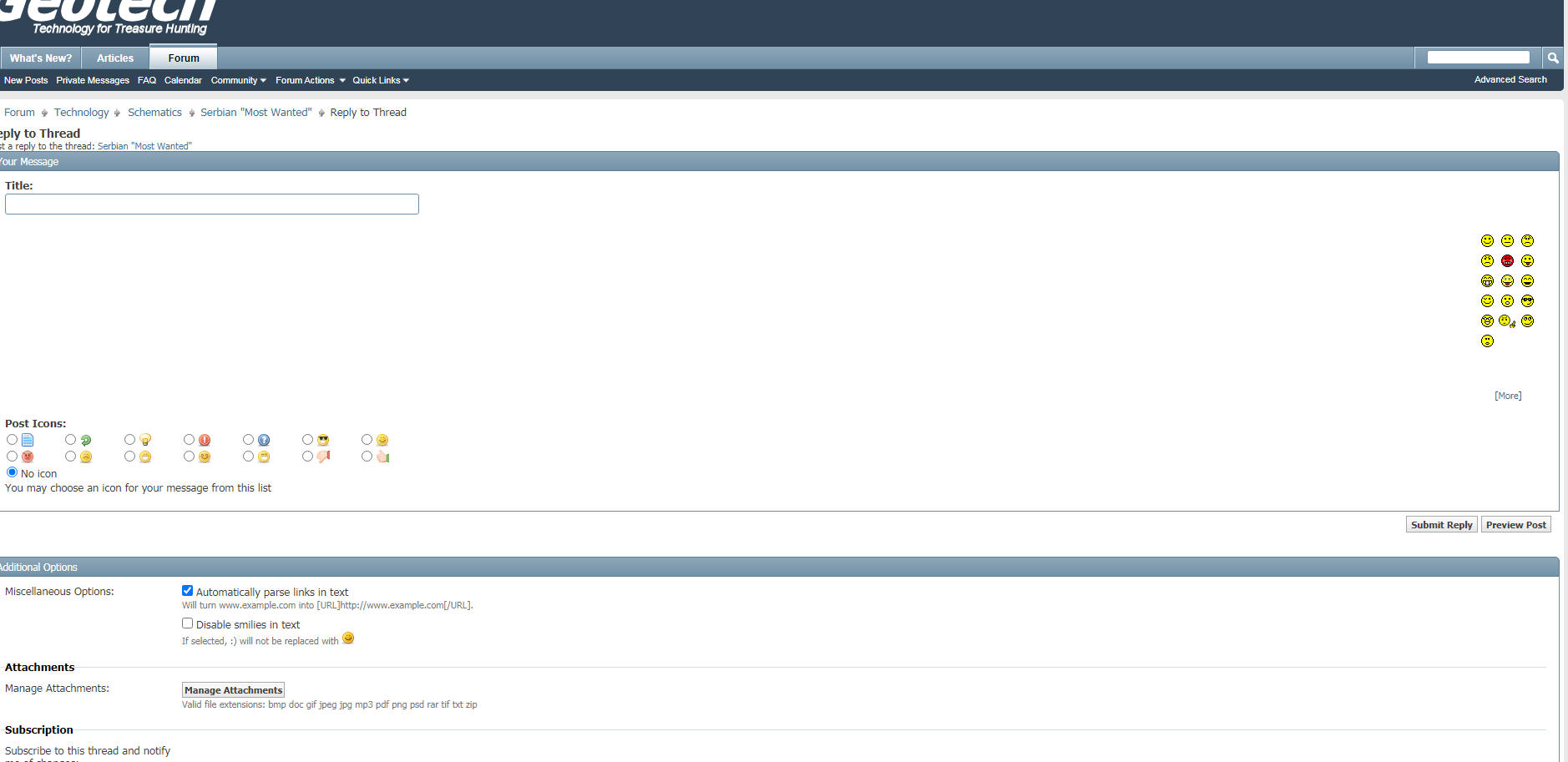

For weeks i have problems to easy reply here on this topic only!??
It's like somebody put some obstacle purposely to this topic... is it?
When i click on "reply" and "go advanced"; i get this kind of screen:
Not allowing me to write anything nor to post reply.
Unlike the other topics where i can reply easy with no such problems.

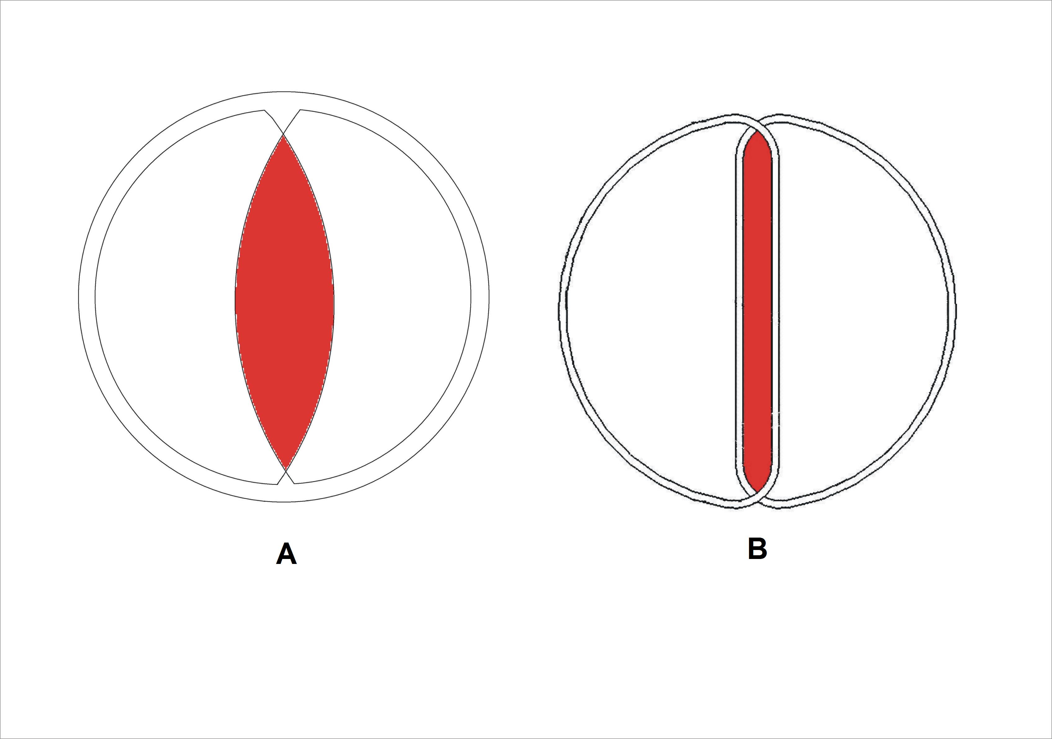

Yes, yes, I agree. A type is much better than the B type. The range of side to side movement for A type is larger per millivolt up or down. Which means that you don't fall off a cliff with the slightest shift, as is the case with type B. Translation, easier to set up.Originally posted by ivconic View PostSo i guess "Post Quick Reply" is all what i can do here.
Here is what i wanted to pointed out Gurdal;
watch this draw and you will understand.
A type is much easier to balance than B type.
Unfortunately you made B type coil.
[ATTACH]54090[/ATTACH]
In type B, the null occupies a very narrow corridor, with a steep fall off to either side, moreso than type A
