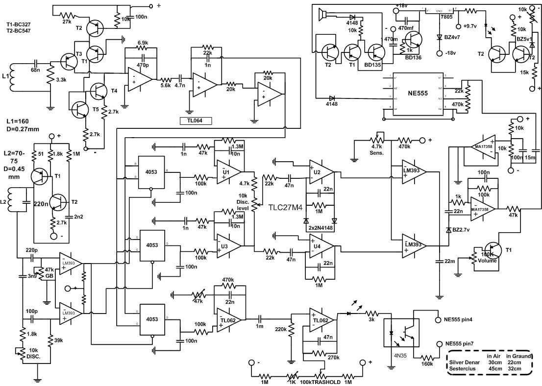

    I had chance to test it; coil was made in horror manner!??? Absolute
    UNNULLED with HUGE wire gauges...totally nonsenced wired up...
    It producing bedlam of false signals...
    Maybe from this schematic could be maden good and useable detector, but
    those what i saw already, are scum! Totally unuseable on soil due a lot
    of false signals...mostly cose worse made coil i ever saw in my life!
    Also discrimination is NONE! Cant distinguish among metals at all.

    But I AM NOT SPITING ON SCHEMATIC at all! Dont guess me wrong! This
    schematic could be good...dont know?

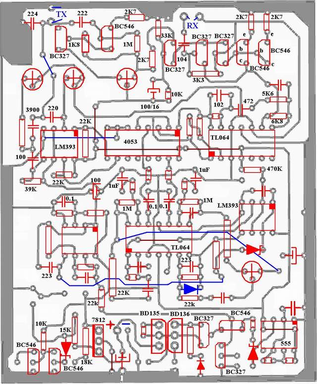

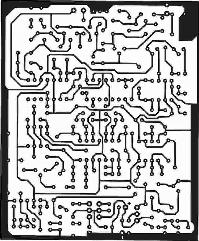

    PCB
    PCB
      Hi ivconic
      Are you have component side?

              I don't know about this one.
              Schematic seems ok... though simplified (and sloppy) version of other things.
              I think in original ones disc could works good too. To me have sense.
              Lacks are around tx stage, audio... maybe rx preamp too
              I think that who made that units to sell actually haven't designed nothing but just reassembled existing stuff in a sloppy way.
              Also coils seems are made, from your description, in a way they can't work any good.
              I think that people involved started a "production" of these but at the end without any reliability... any good idea of quality standards... etc
              homemade for the masses. Can't give any good at the end of the day... apart a huge bank account.

                  Sloppy...
                  Sloppy pcb....and sloppy me! I am to lazy to trace it out complete...Lost nervs...Anyway this is good enough to have some picture...
