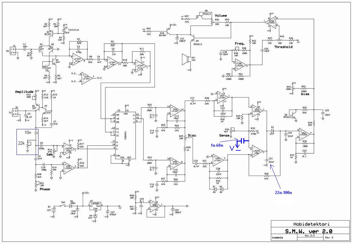

      As i see at Bluemax the Rx signal is about 35degrees rear of the Tx signal. So i must make it to be in phase with tx signal. I will try to late the Rx signal other 330 degrees so to be in phase with the Tx or other 150 degrees and to reverse the winding. But it is not so easy to make it. With the disk potentiometer closed and when i have signal only on the one channel (ferrous), it detect a 30mm coin at 50+cm with the coil no good tuned. This is the reason that i try to make it to work right.
      Hi.

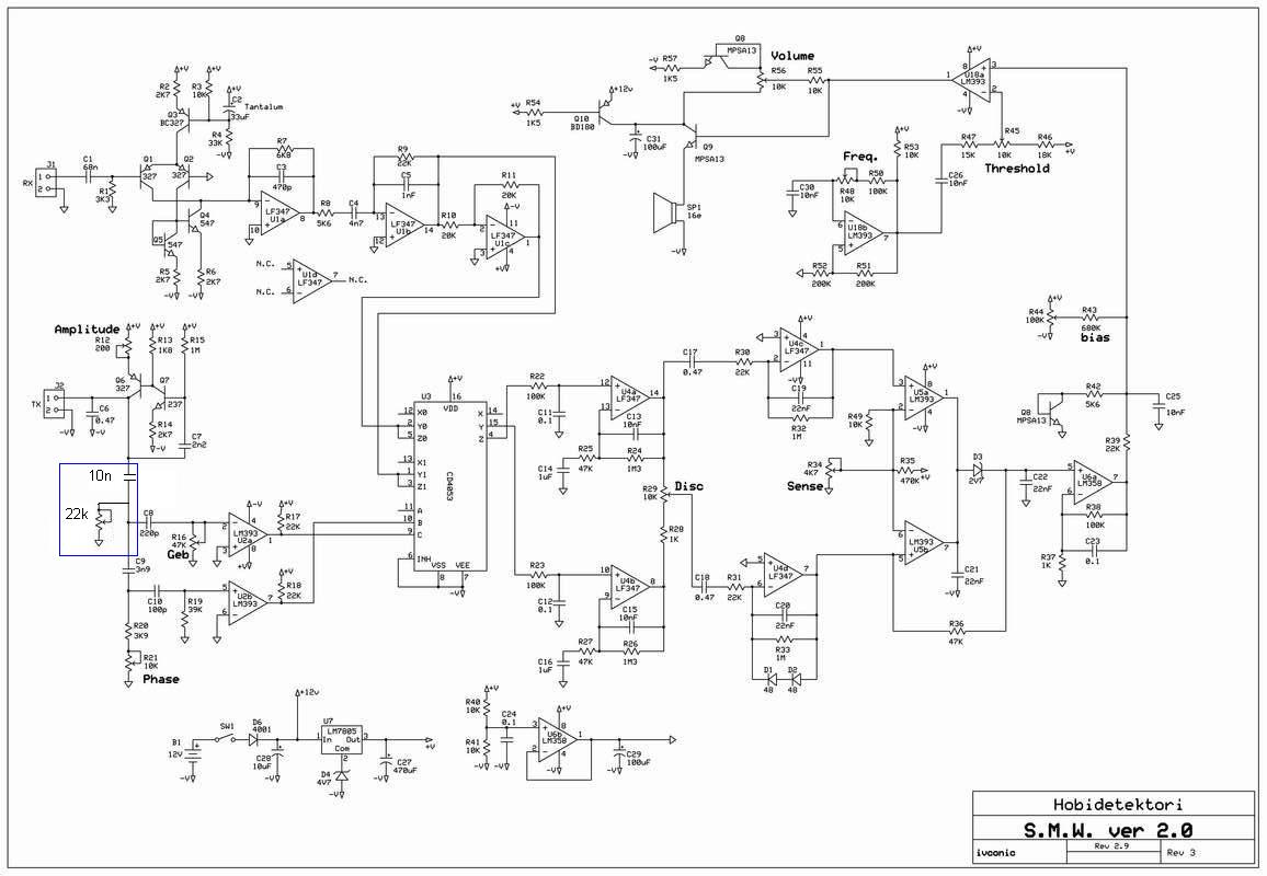

      Finally i found the solution of the phase shift between Tx and Rx coil.
      I attach the schematic of Caesar, and at left side (in the blue square), you will see the simple modification who corrected the problem.

        Are you sure of that?
        • Originally posted by lari View Post
          Hi Lari.
          Yes i am sure. Maybe the Rx signal is 35o front of the Tx signal and not rear it.
          But with the modification that i say, Discrimination is OK.

            Hi Geo
            Try to put condenzator of 10n in order to
            potentiometer, may be better.
            • Originally posted by Vladimir View Post
              Hi Geo
              Hi Vladimir.
              Thank you. Now it is OK, no need to change it again. But i have other problem. It is very sensitive and unstable.
              When i touch a little the coil or the cable or the pcb it beeps.
              So i can't move the coil on the ground or on the air.......
              Ideas!!!!
                      [Priloži] 11208 [/ Priloži][quote = Geo; 107.381] Bok Vladimir.
                      Hvala. Sada je u redu, nema potrebe da se ponovno promijeniti. Ali imam drugi problem. To je vrlo osjetljiv i nestabilan.
                      Kad ja dodir malo zavojnica ili kabel ili PCB ga oglašava.
                      Pa ne mogu premjestiti zavojnica na tlu ili na zraku .......
                      Ideje !!!![/ quote]These are two options for instability (amplification integral round)
                      Hi Lari, i will try the modifications.
                      Thank you.
                          Hi Lari.
                          I connected the capacitor to the sensitivity potentiometer without results.

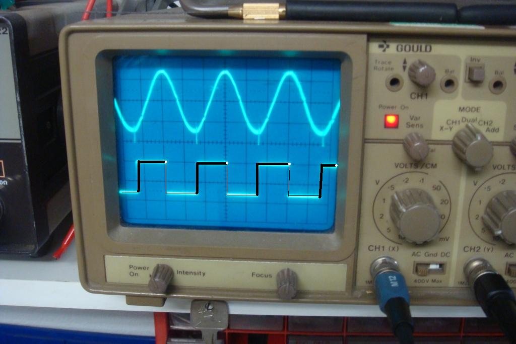

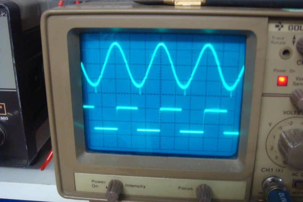

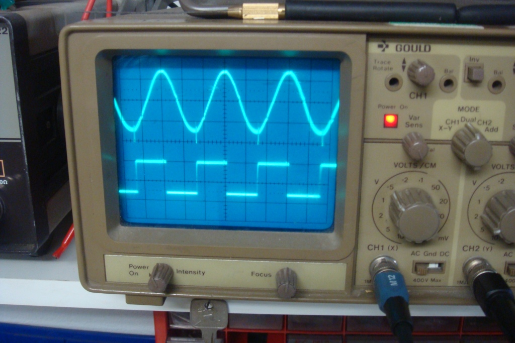

                            I attach here 2 waveforms.
                            At first the sinus signal is from pin14 of U1b (ivconic schematic) and the square is from pin10 of 4053. At second photo the sinus is the same and the square is from pin9 of 4053.
                            What do you see???
                              Hi Vladimir.
                              Depth is great.
                              Discrimination is good.
                              GEB is bad.
                              What do you see???
                              Phases are ok but the 393 waveform is not good (geb.)
