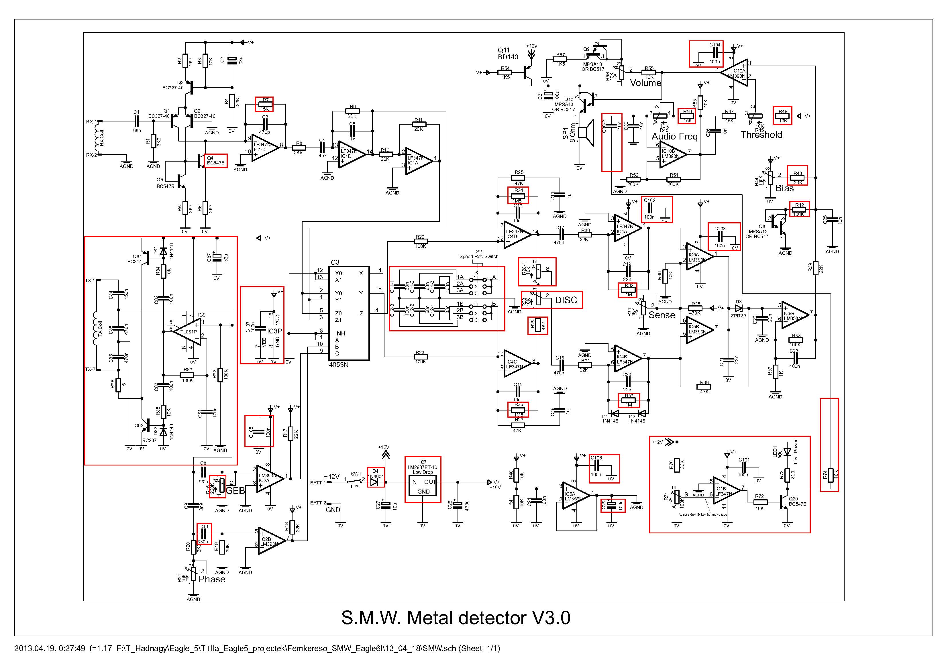

            i am going to make the pcb and lay out file for smw3
            does below schematic of smw3 is correct or no?
            best regard
            zakari

              • hi all
                ruben2000 and sbaio1 the 145.rar file has some error that is not according the smw3 schematic
                which one is the correct?pcb lay file or schematic??
                best regard
                zakari

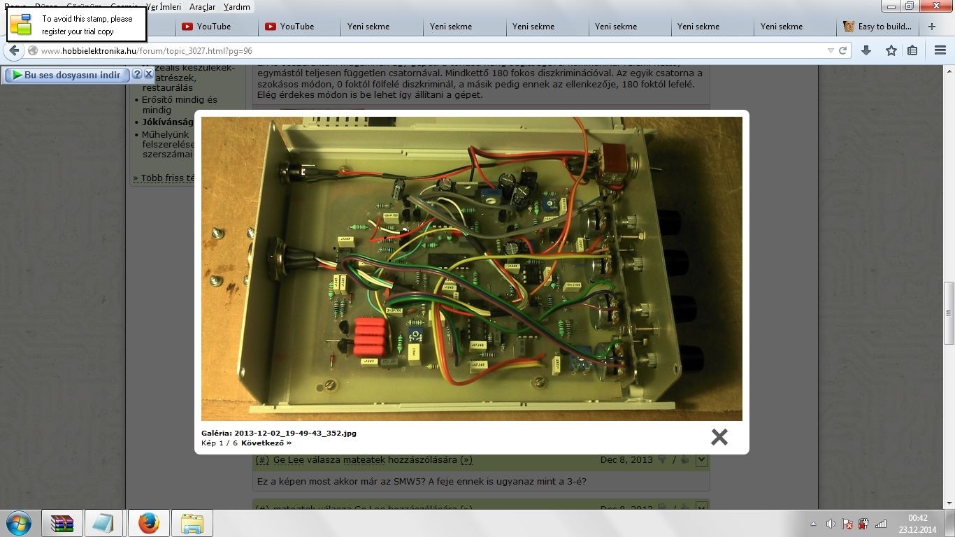

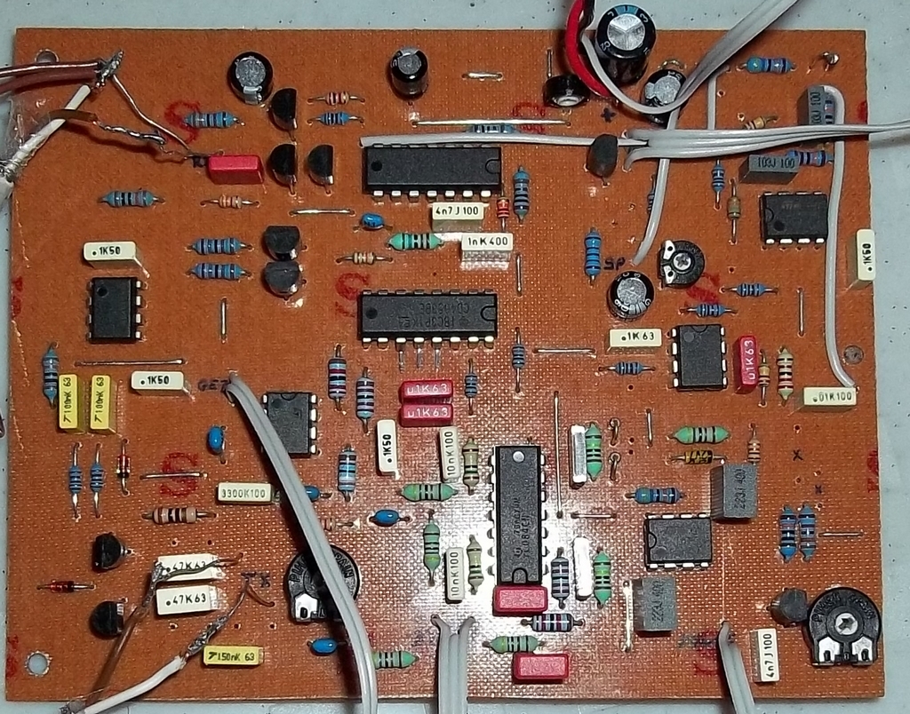

                  Hi, zakari, here are the files I have from SMW3, I haven't built it yet. I hope you find it useful.Click image for larger version
ID:	361333Click image for larger version
ID:	361334Click image for larger version
ID:	361335SMW_3_0_5.pdfSMW_v3.rarClick image for larger version
