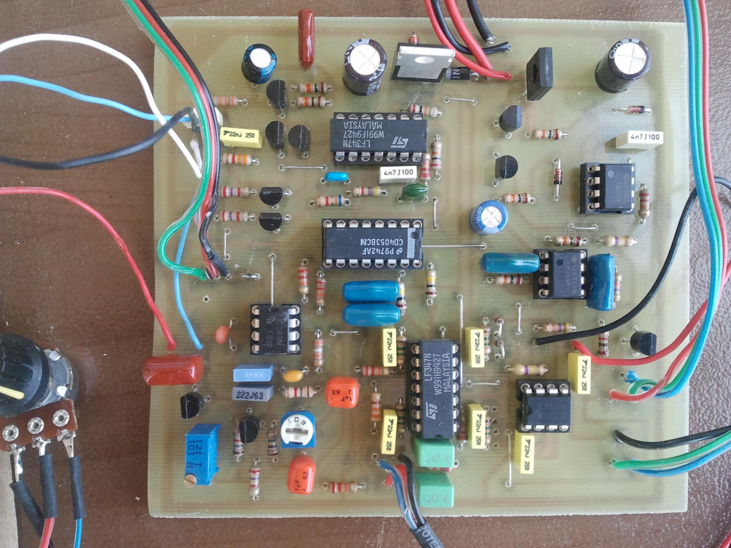

            • changed-R22 R33-51k R25 R27-4k7 but not stable
              Somewhere there is a mistake there is not enough depth
              • Changing R22 R23 is safe from the point of filter corner frequencies, but R25 and R27 must be adjusted together with C14 and C16 to make sense.
                Channel filters are a bit touchy for making such adjustments. Safe way is observing each branch function and making sure frequency response of a branch is maintained. You could for example reduce R25 and R27, but simultaneously increase C14 and C16. This particular change may prove a bit tricky because 1uF comes at "normal" dimensions, while 2uF or larger tend to be huge in comparison. Option "B" is reverting to electrolytes, preferably bipolar.
                There is another issue that is usually overlooked: noise. Using LF347 or TL074 gives advantage over the original LM324
                • I use 347 have maximum amplitude in the receiving coil but no depth of detection. Where is problema.10mm. Coin of not more than 20 cm. 60 cm air.Nad no detection of even large objects.
                  • It could be due to several things. I'd start with coil balance. In video it seem you have some commercial coil. Did you check the signal level prior to 4053? Just because it is all potted doesn't mean you can't improve the coil balance - it can always be done with a small piece of ferrite and a small piece of foil.
