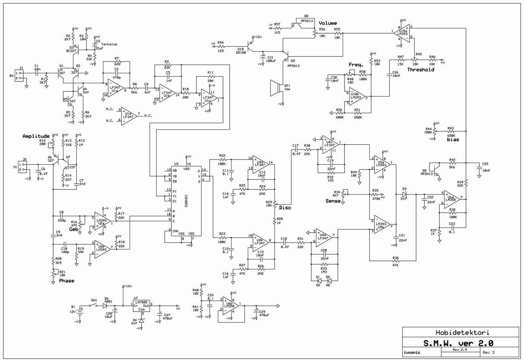

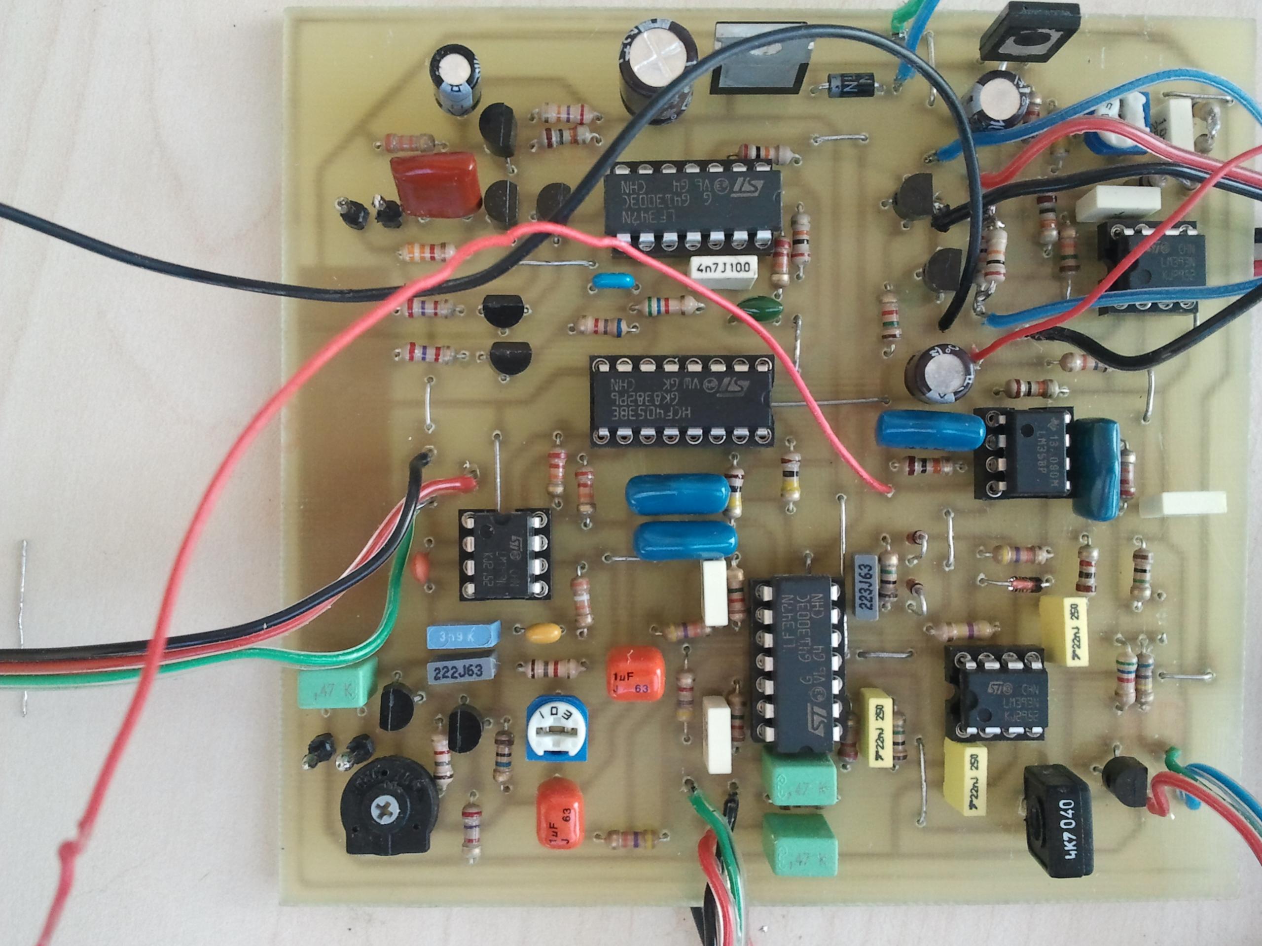

  • My SMW 555 TX-470nf - 7.7Khz- 8.6 Vac/ RX- 1nf - 8.2 Khz
    • This version of oscillator is way better than the typical oscillators in popular VLF builds, but there is also a catch... you can't use it with any coil. The coil for this Tx must float, so it must not have any of the ends connected to a shield.
      In case you build your own coil it is not a problem at all. The op amp takes care that the conduction is precisely 50:50 so the 2nd harmonic will be greatly suppressed, and purity of signal will depend mostly on how the supply voltage is pure.
      The same job would be performed even better with a real balanced oscillator, as you have to have a Tx coil floating anyway. The advantage of a balanced mode operation is that a net E-field of such coil in operation is zero, so capacitive feedback from Tx to Rx coils is off the table and better balance is achieved. With single ended operation a net E-field of a coil is half the voltage across the Tx coil, and capacitive feedback limits the depth of achievable balance.

          • These are just all the specifications put together, a 555 audio version, Tx running with 470n at 7.2kHz and producing 8.6Vac, Rx tuned to 8.2kHz with 1nF capacitor (which is the part I don't quite understand).

                  • Help me to analogues of the transistor TIS75
                      • BF245B ... it has almost exact Ugso range and it is made symmetrical (drain and source are interchangeable)

                            • But bd 180 wrong. Turn to 180 degree
                              • Where is the problem
                                in my SMW I have problem There is an inverse relationship between sensitivity and volume key . When the sound is low Detecting coin in the air 40cm . When the sound is high Detecting coin in the air 29cm. I use BC517 Instead of MPSA13. help.
