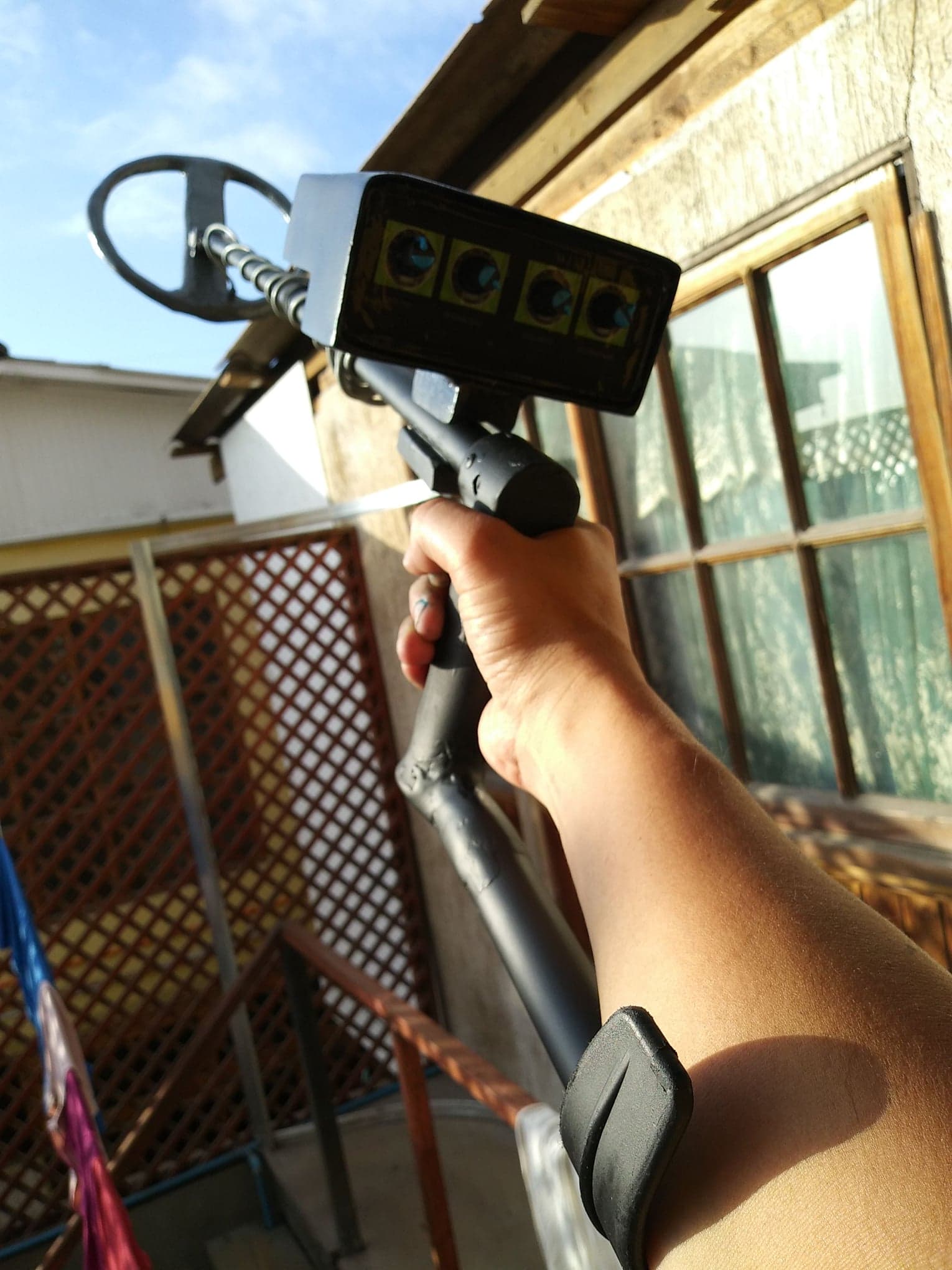

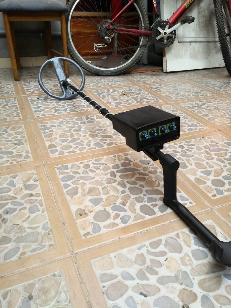

                  • hello .. I finished the project worked perfectly, better than expected ... want to know if someone has made 2 tones? .. I would like to add 2 tones someone knows?
                    • my video
                      • What is the loop information?
                        @ricalbertvig
                        Which pcb have you made?
                        • I made modifications to the scheme, instead of regulator 8 volts, use 5 volts with zener 4.7v to the regulator ground 5 volt .. does not carry rx capacitor ... change r1, also r28 ... inductance rx 16 mh and tx 2 calibers wire inductance 1mh ... coil 28cm .. I would like someone if the done 2 shades can share, greetings
