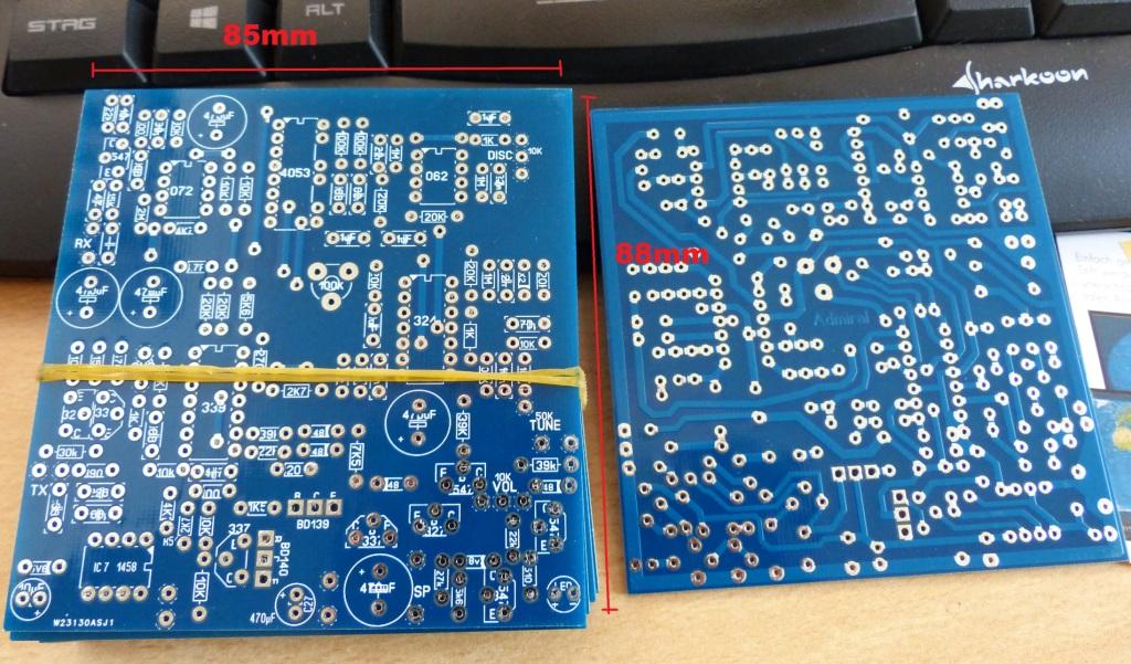

                    • got my admiral pcb yesterday, tooks 14 days from china
                      made them for german diy builders

                      • Look's very professional. How much cost + shiping?

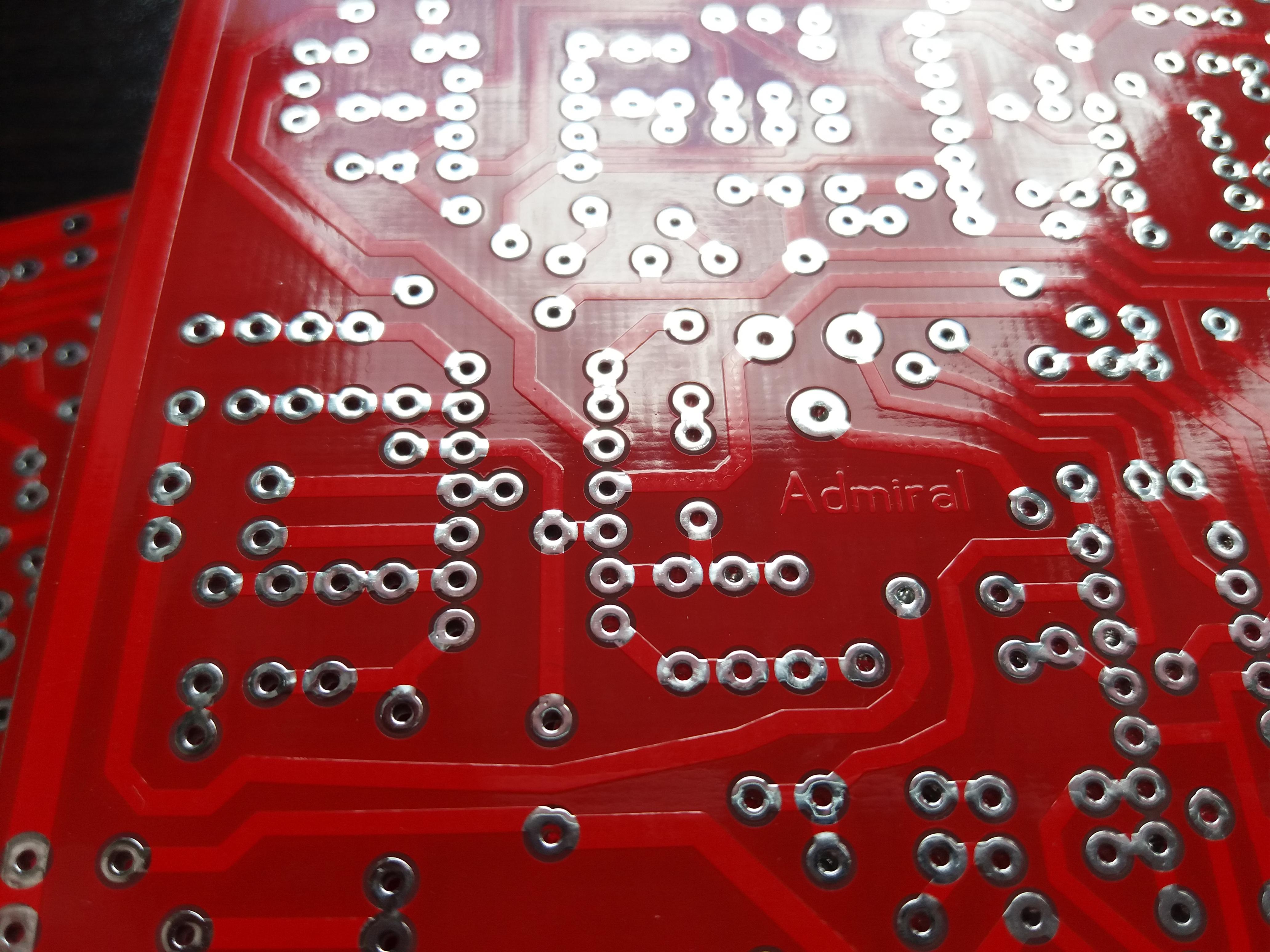

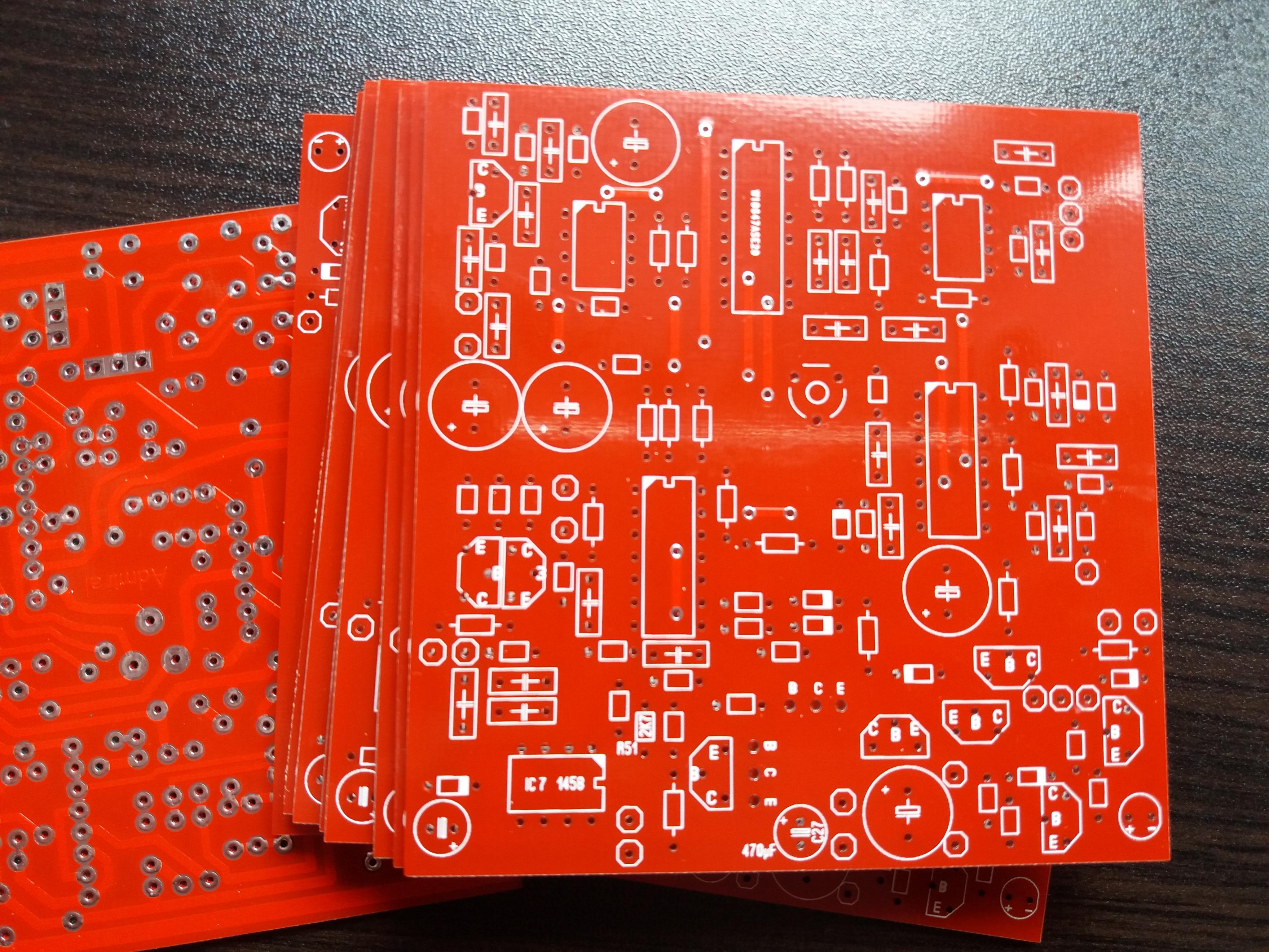

                        • Originally posted by CDI View Post
                          http://www.ebay.it/itm/232087859162?...84.m1555.l2649

                          • Nice offer.
                            Bandito, do you know, if all boards are tested on working status as claimed (1€/40cm), or populated only?
                            If previously tested, which coil are used for test? Detech DD Ultimate 13" or some of other available coil?
