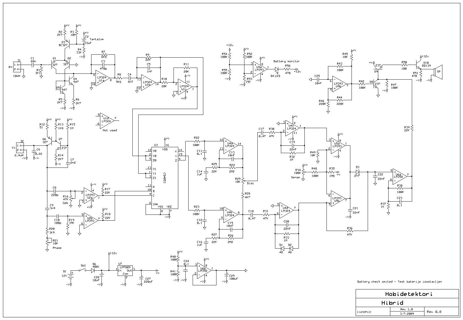

          It's been a while, since i posted this...

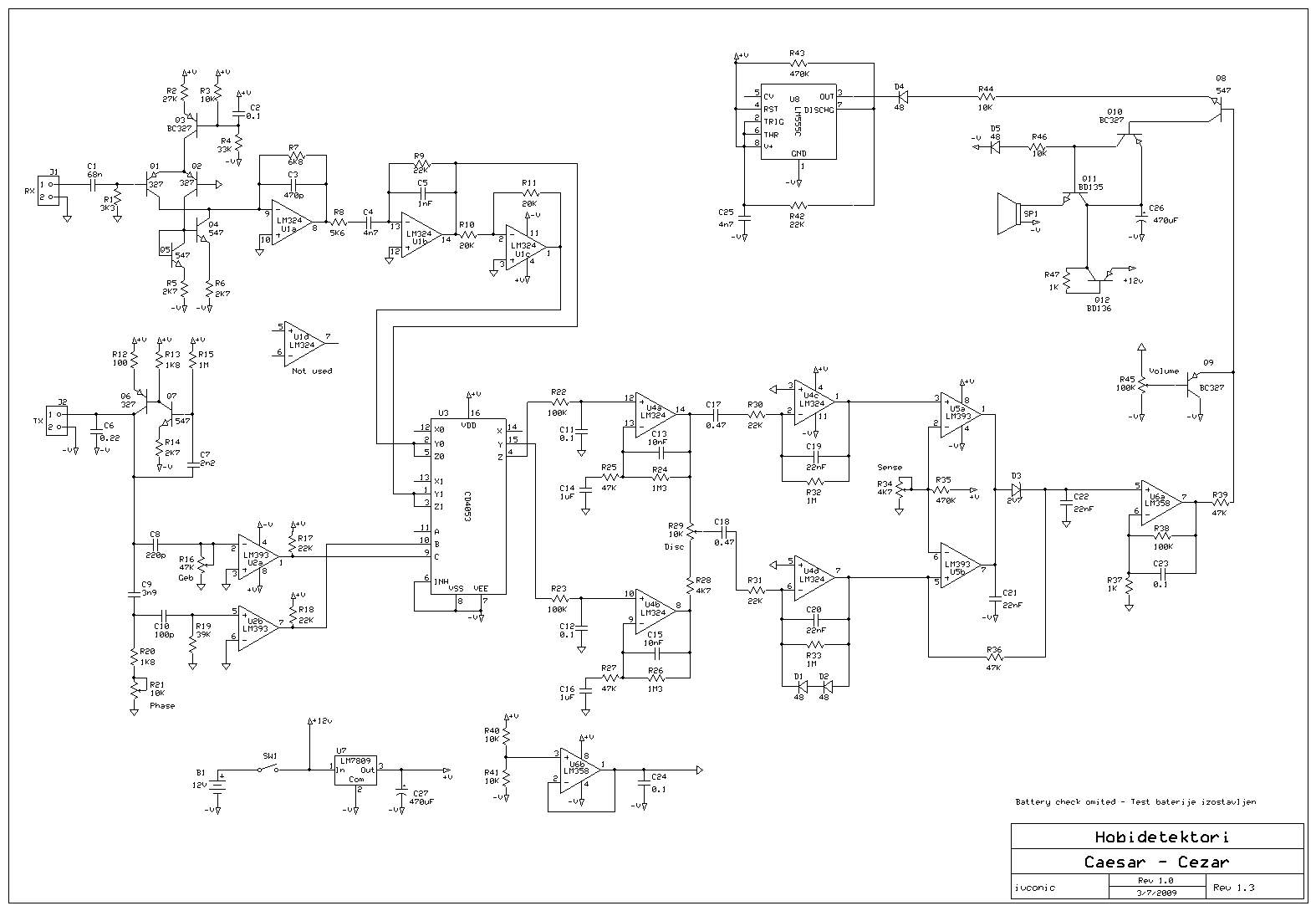

          This "serbian most wanted" actually was and still is most controversial diy project here in Serbia. Many beginners usually do start building detectors with this one. Few of older enthusiasts already made a series and spread good and bad opinion among prospectors - usually dependable of quality of those hand mades.
          I met few handmades made by others so far. It is truth; some of those work very good and some don't. Until recently i never payed more serious attention on this one. But recently i decided to investigate this more and also made my first "Caesar" !
          Yes it is working very descently! Of course most of working quality depends directly on coil. So i used one older Fisher coil just to experimenting. It is quite a effort to adjust good phase , yet once done; this device is working very,very good.
          So far nobody ever offered accurate schematic. I already posted one and only schematic which circles arround the net, and it is faked and not accurate at all.
          So i decided firstly to trace already made and workable device and to establish most proper and most accurate schematic.
          Now...looking at this schematic, it is so obvious that this detector is a sort of sublimate between White's, Fisher 1225 and Tesoro. Although we can meet simillar or exact the same stages in other projects too.
          Also, recently, i discovered another fact; originally, this design came from Bulgaria. I guess some good bulgarian enthusiast payed a lot of effort to experiment and finally got this project.
          Looking at schematic..man can be fooled by it's simplicity and wrongly to conclude about it's performances.
          I took it outdoor with me few times and was pretty amazed with it's performances and depths i reached.
          Only one minor drawback is; it can suffer from minor instabillities if Sensitivity is adjusted to maximum. Lowering Sense device becomes very stabille and loose just a bit of depth.
          Discrimination is not so splendid as on TGS/TGSL/Eldorado ..but it is still very good and useable.
          When making handmade coil, datas from first (faked) schematic can be used. Those datas are good. Wire and numbers of windings are related for standard 27cm DD coil..(255x137mm for "D" shape)...
          So...what else? Aha..! Those quadro opamps are not LM324's by demand. TL064-TL084's can be used. And even better 27m4 or simillar...
          What else..? Here it is and enjoy! I suggest you to make it and see..worth of every effort!

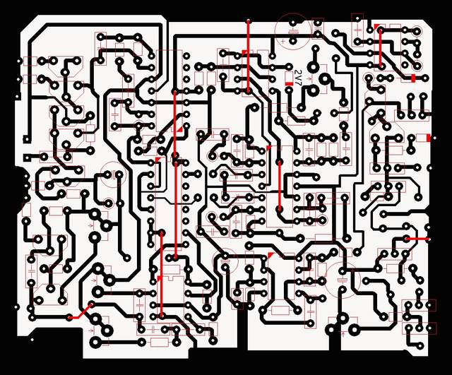

          Oh yes! One more thing; drawing schematic i omitted battery testing circuit. So you can be confused (dont be) comparing pcb and schematic. I also skipped those few components on my detector. Simply i dont like it...and dont need it..
            Oh yes; just spotted one mistake! At 555 pins 2. and 6. must NOT be connected to pin 8.
            I guess software (ExpressPCB) made wrong connectione there!? Or it was me? However, pins 2. and 6. are connected togather but not with pin 8.
              Ok..using same approach i changed concept a bit. Also corrected few minor mistakes on previous schematic. Now is time to draw another and better pcb...

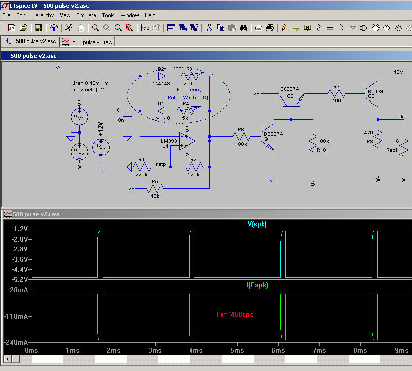

                Hello Ivconic! There is nothing wrong with what you are showing but here's a way to use less power at your speaker by adding two diodes and one resistor.
                This mod allows separate control over audio frequency and Duty Cycle. The two adjustments are not completly non-interactive but pretty much. (Hmmm... changing DC affects frequency according to the formula Fo=1/(Thigh+Tlow)?) For somebody who doesn't want a square wave audio output (because of making too much noise or using too much battery power) variable DC would be desirable.
                Just make sure you don't reverse the diodes by mistake or you will have something like 95% DC instead of approximately 5% as shown here. You wouldn't hear any better and your battery life would suffer.
                Just like your circuit, 1/2 LM358 could be used. It should make slightly lower output frequency.
                Increase the value of the DC resistor if you need more volume. Don't go too high or you defeat the purpose.

                  This is very interesting new little thing to learn! I will include it on pcb for sure.
                    oops
                    I made a mistake (again?!! ).

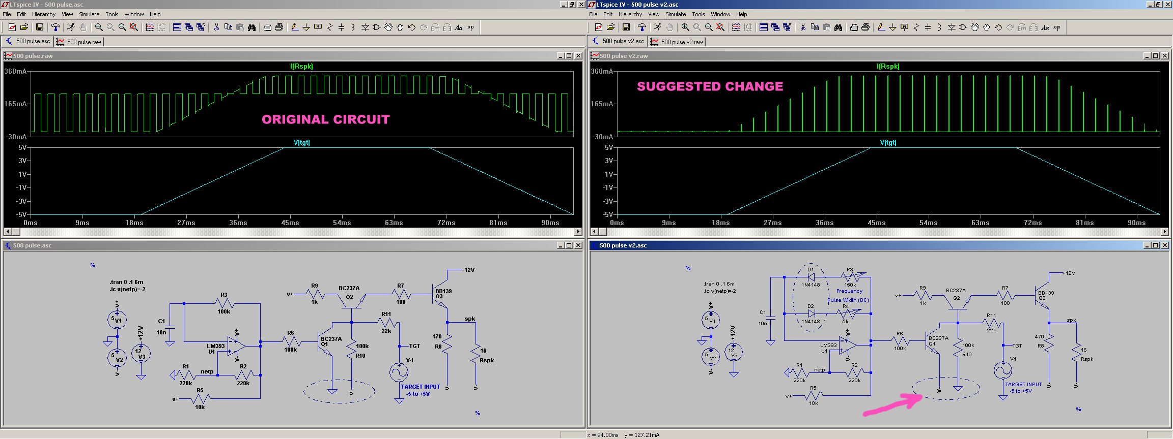

                    I got to looking at the audio output. When I apply what would be a "target good" input from the comparators; operating the entire subsystem
                    instead of just looking at the oscillator output - what occurs is the not what is desired.
                    Two reasons.
                    Change two things. Reverse the diodes (also change the resistor values to obtain the same approximate frequency as before). My fault.
                    I did not look at the entire audio system. Duty Cycle gets inverted in the audio transistor chain. That was my bad.
                    But this is not my fault: I believe you should swap the connections of V- and ground between the emitter of Q8, and R47. (This assumes that
                    the output of U6A goes positive with a good target, right?) You won't have a smooth
                    transition from no audio to full audio as target signal level increases without swapping those connections.
                    note: Compared to my previous post, I turned the speaker resistor around, so the "I(Rspk)" display goes positive instead of negative.
                    That's just a little spice oddity. I hope it doesn't add any more confusion.
                    Maybe it's right this time.
