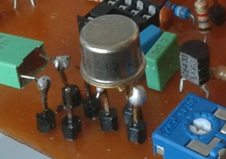

                        • solid phase solid sound at full volume refuses'm building a new sound

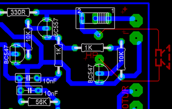

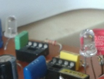

                          • bc 160 transıstor -2v7 delete ....led dıode fine ....ferros nonferros led diode
