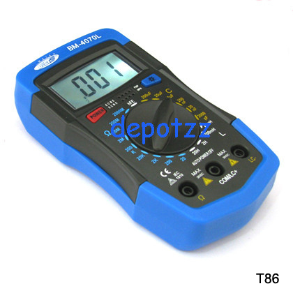

        • Hi all
          My Lmeter arrived from China. Will be able to work seriously.

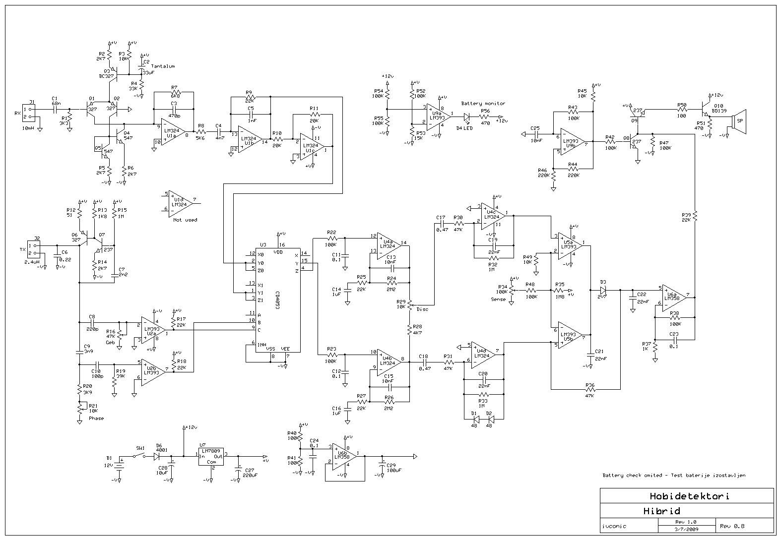

            • Hi
              Any pnp transistor can operate. Search on Google.
              3906 is not in the final scheme and it is not resistance but transistor. I think before making such an arrangement should at least know a little components.
              • Actually not. The best cheap choice for T1 and T3 is BC327 because of very low Rbb at about 30ohm. Fun part is that the so called "low noise" BJTs tend to have much larger Rbb and will not perform well here.
                With BC327 you may expect noise down to 1nV/sqrt(Hz), which is not bad at all. It is the key feature of this rig, so cherish it

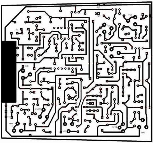

                • plz...... I want component side of this pcb.........give me........plz.......
                  • Hi kkyawhtet
                    See # 438. It is in any case advisable to read the full article

                      • Hi kkyawhtet
                        The right diagram is # 107 page 5. The detector is also called Cesar Caezar ... I attach the pcb Jpeg.

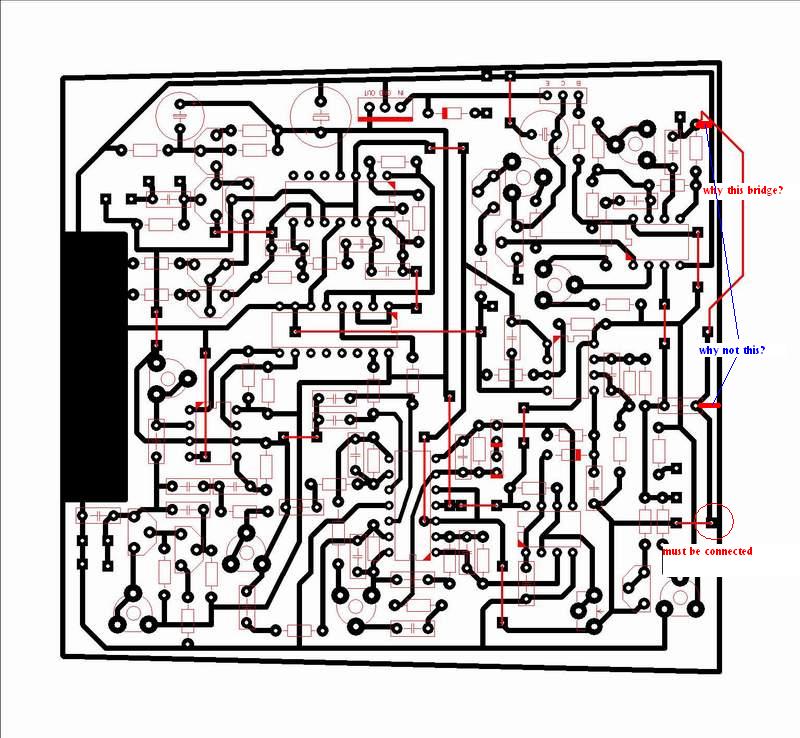

                        • Errata and question
Name:	pcb cesar.JPG
