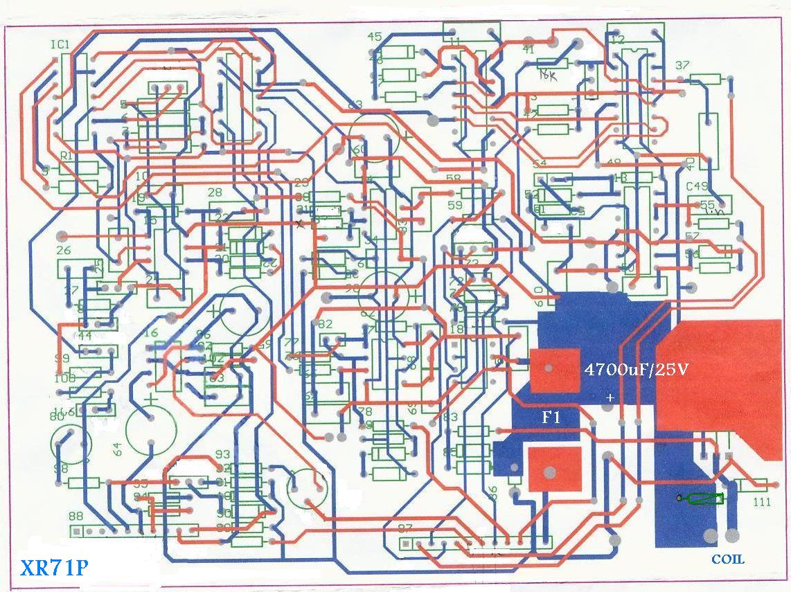

              Hi All . As i saw here the file that Max attached here (pcb.pdf) is the original pcb for XR71p. This is the file that Aban sent to me at Protell 99SE Format.
              So now Don't write to Aban for the file. The file is here.
                Anyone have built this detector from max schematic and KT315 pcb?

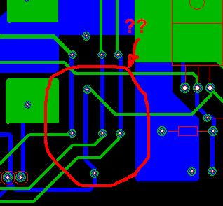

                This part of PCB dont make sense.any reason?
                  I have one Original and has the pcb that Max sent here (pcb.pdf). Components name match with the protel file that you can find here
                    Thanks Geo,
                    Not sure if i understood:do you mean the sprint layout file is the same as original PCB? as i mentioned, the PCB design is strange,not well designed.I may consider to make a new single side PCB from diagram...
                    Can you tell me what do you think about this detector?
                    regards,
                    Fred.

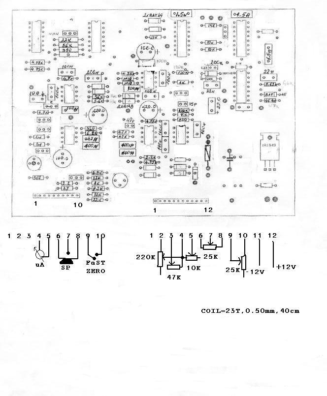

                      Hello all
                      Attached alot of file about xr71 showing bottom and top n pcb and others
                      Erol

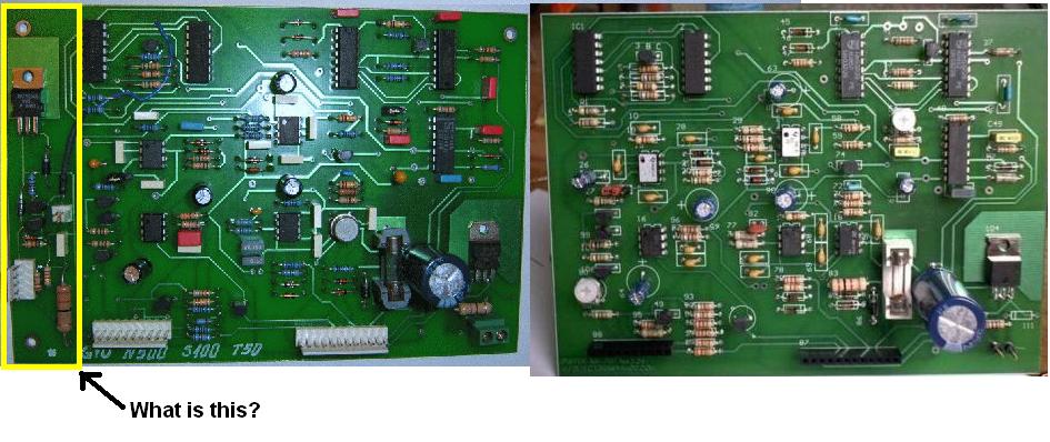

                            KT315 question
                            You posted the board on the left a few years ago in post #7. What is this additional piece (in yellow box) added to this pcb? I have the pcb on the right, but I would be interested in the other. Do you have the schem and pcb layout?
                            Thanks so much!
                              The three terminal regulator in the yellow box is a uA7915uc -15 V negative voltage regulator. That could be the circuit supplying the -12 V to the circuit.
                              It's not hard to see how it could just be dropped off with the addition of another battery (if that was the intent here). Not my choice to do it that way but half-understandable.
                                Thanks so much!
                                thinking it is a charger. maybe done on LM317.
