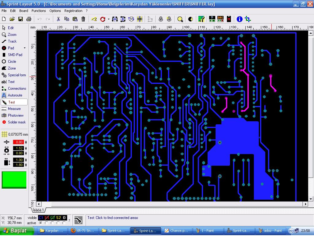

    Vladimir D. asks me put a file of PCB in .LAY format, Sprint Layout-4. now you have all files to do The Thing.

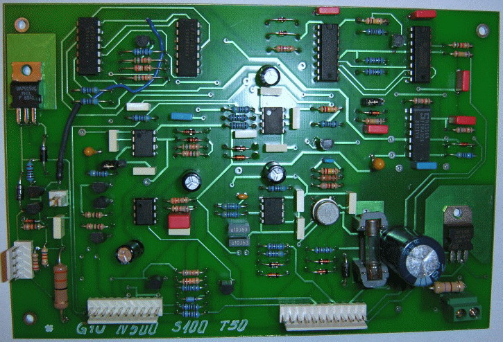

    this PCB faulty

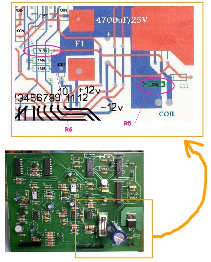

      Originally posted by Darren in NC View Post
      You posted the board on the left a few years ago in post #7. What is this additional piece (in yellow box) added to this pcb? I have the pcb on the right, but I would be interested in the other. Do you have the schem and pcb layout?
      Thanks so much!

      We haven't to speek for price. I'll send pcb not for money but for somthing similar. Last year I sent to Jurij some coil shells - you can ask him. My XR71 pcb is the same as "Aban" sent in Carl forum. He ("Aban" is pseudonim which one bulgarian boy have used. He is from Burgas and is very good liar.) He had stolen my pcb at the early 2000. This pcb have manifactured yet have a bit modification - we added a part with batery changer and lowbat indication. As you good know on pcb are swich for "Manual" - "Auto" tune which was soldered in "Auto" mode in "Aban" pcb. The main advantage my pcb is spetial selection for IC and pasive - You mast know this is "secret", because there were many XR71 detectors were manifactured but when you will test any from "VE EL electronics" you could register adventage. I have many detectors and think it was one of the best models at the time and can compare it.

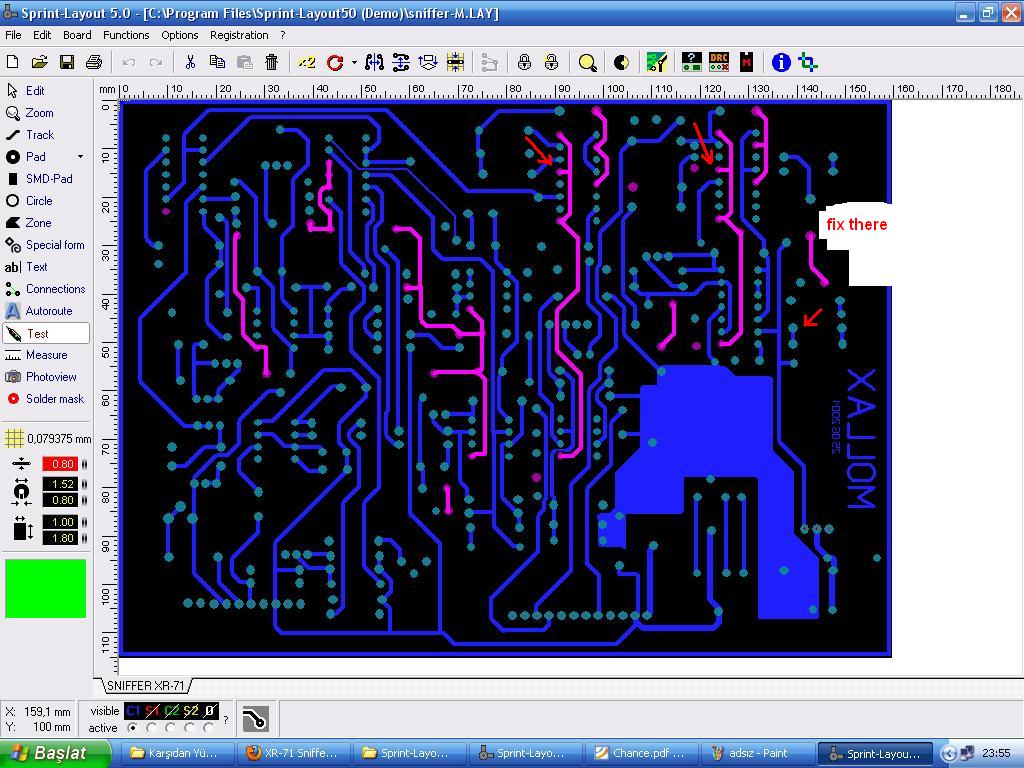

        I fixed it everybody get a gift
          Mollax, what did you fix?

            Some of them are more
              mollax,
              If you are going to the trouble of re-spinning the PCB I have some other suggestions.
              I do not think that the original PCB designer took into account that thru-hole plating would make the diameter of the holes narrower. Some component leads must be forced through the holes because of the space being too narrow. Make the R and C pads bigger where possible, and widen the holes
              The damping resistor R5 should probably be a power resistor because of the high voltage spikes. The existing PCB layout only accommodates a 1/4W resistor. Pad diameter, pad spacing and hole size, are all wrong. R5 needs some attention.
              Same goes for the receiver input resistor R6. R6 pads are laid out for a 1/4W resistor, but I see a power resistor in the photo. Also, I have someone's XR71 project to finish, and there is a power resistor installed at R6 as I received it. Come to think of it, a power resistor for R6 is not a bad idea but evidently that is not what the PCB designer had in mind.
              Q1 (IRF740) pads could be larger and the holes wider. Why not make those bigger? I damaged pads because I could not get all of the old solder to wick when I needed to reposition Q1.
              Tight specs might be great for industry, but not so good for the average hobbyist. Vias being larger than solder pads seems like nonsense to me.

                porkluvr amen.I posted here PCB I want to state incorrectly that.
                If you want the .lay file you are correct.
                  This pcb have manifactured yet have a bit modification - we added a part with batery changer and lowbat indication. As you good know on pcb are swich for "Manual" - "Auto" tune which was soldered in "Auto" mode in "Aban" pcb. The main advantage my pcb is spetial selection for IC and pasive - You must konw this is "secret", because there were many XR71 detectors were manifactured but when you will test any from "VE EL electronics" you could register adventage.
                  So is this pcb file available in Sprint Layout or other layout?
                    it places in folder PCB from demchenko. Sprint Layout .LAY file.
