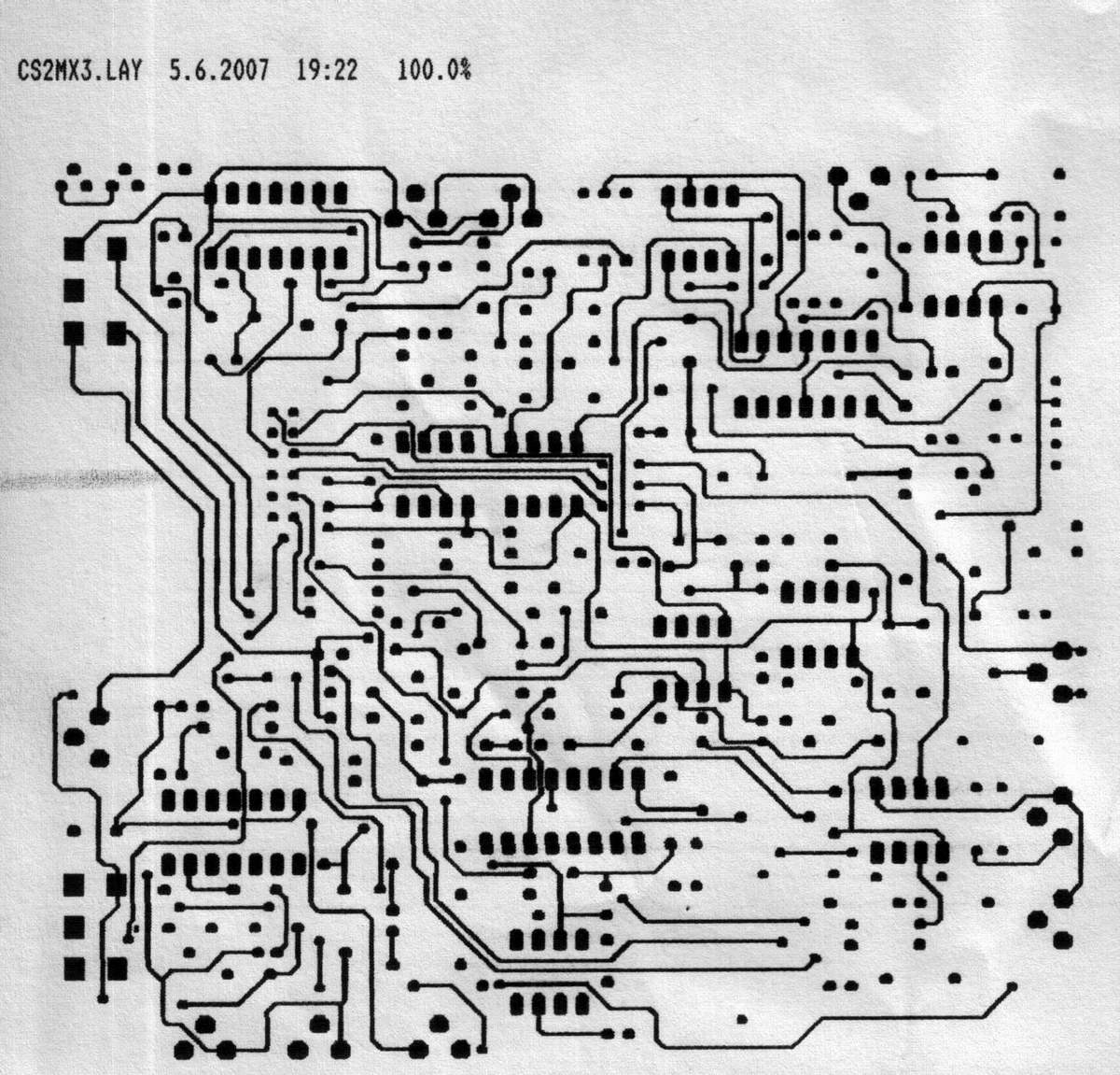

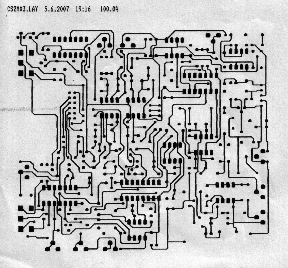

    I have these scans from Cscope 2MX pcb. It is double sided pcb.
    I am not in condition to spend so much time infront of my pc to clean and retrace those. Anyone have good will to make proper,clean pcb file from those? Any format will do; Sprint Layout, DXP,Eagle,PCB Express,CAD...
    Or just simple .bmp, .tiff,.jpg or .cdr...

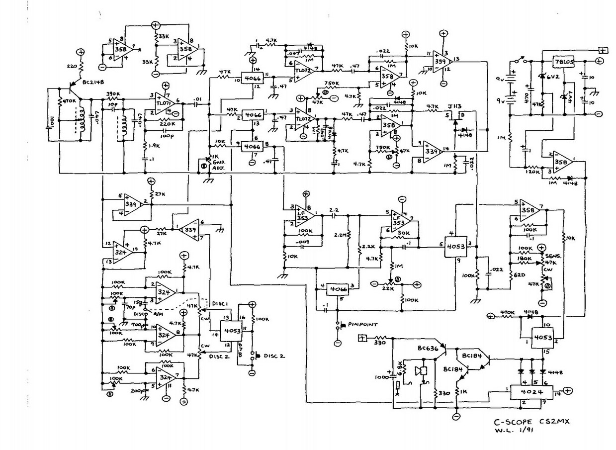

    Please, this is C-scope 2MX schematic (traced by W.Lahr)
    Mrand
      Thank you Mrand!
        And - thank you Ivconic for posting this interesting information.
          Thank you ivconic , also many thanks from Mrand , another clear and
          Good reverse Engineering from W.laher .
          Ivconic, are you know about sensitively? For 2cm coin in air and ground .
          Regards.
            Bill Lahr certainly has traced out a lot of circuits, eh?
              Lahr
              Carl you are right, William Lahr has made a lot schematics that we all use ...
              Think he also made some good PI detectors !
              Thanks to Mr. Lahr !!!
                Thanks to mr.Lahr! Yes indeed.
                Also showed those traceouts are accurate,correct. TGS turns to be my favorite handmade. Thanks to Lahr's traceout.
                I always wanted to ask, but hesitste,is there collection of all his traceouts, at one place? So far i collected Tesoros's and dozen others. This is first Cscope schematic i got complete and clear. I presume must be there more schematics? Personally i am very satisfied with Tesoro schematics. TGS already made,SS already made. Intend to make Royal Sabre and Lobo this year.But i am also interested in Minelab schematics and of course Cscope's too.

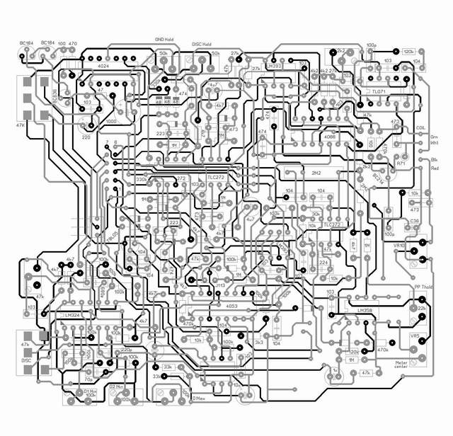

                          clean pcb
                          clean pcb
                          http://www.savefile.com/files/1323101
                            C-SCOPE RPROMET 3, another Reverse Engineering schematic, without control panel /buttons and leds/.
                              I played a bit with those pcb patterns.
                              Didn't finished front panel part because it is not so important, having just few components.
                              Maybe will do in future.
                              But, while working on this i noticed that it is not the one that correlates with available schematic?!
                              It is some "CS2-MX3" model!?
                              I searched through the internet and didn't find anything like that.
                              There are "CS2M" and "CS2-5MX" models mentioned on manufacturers site, but not this one.
                              Is there any chance someone to know more details about this one?
