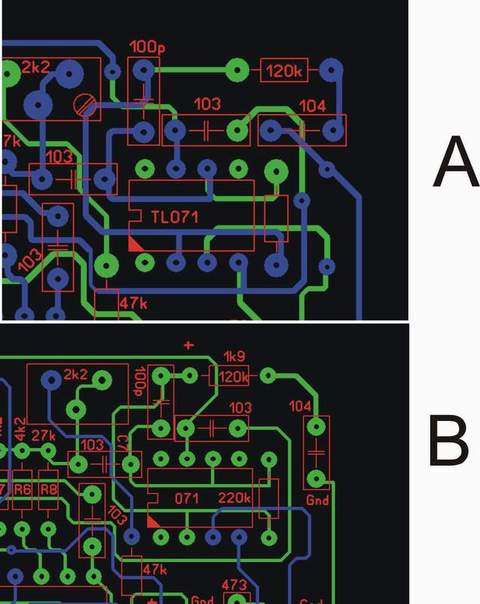

      Trying to resolve this pcb draw and make it less complicated, more logical and more human.
      So... tough job!
      Tough, because original was done by autorouter, which was so stupid and made zillion nonsense tracks, vias etc...
      Simple example is showed on photo bellow. Example A is original autorouter draw and example B is my manually routed draw.
      That's why i don't like "machines"!
      Man have to do what man have to do, ain't no machine to do the same job instead the man, simply as that.
      Autorouting is necessary only at more complex designs, in cases when it would probably take months man to route it manually.
      But i can only wander about those routes!?

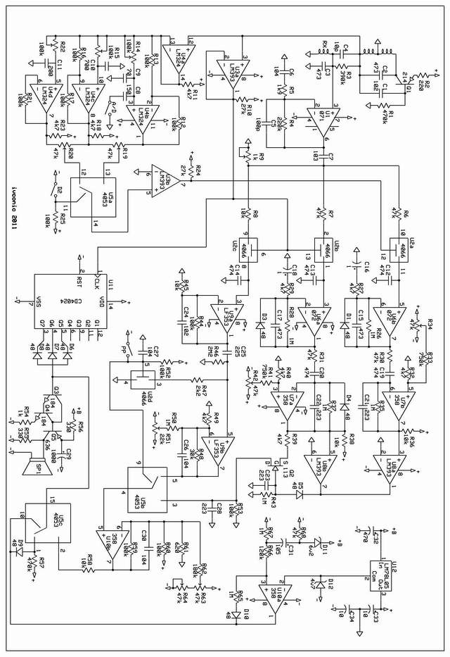

      Back to subject; i am sure now that posted schematic and posted pcb are not from same model.
      So, again, is there anybody that might have more details on this? Photos, similar ...etc..?
      I will do this anyway, with or without extra help, but it would be much easier if there is additional help...
        Of course, i made redraw from Lahr's sketch, because it is much easier for me to follow the "logic" on this one...

          It depends a lot on the flexibility of the autorouter and how you're allowed to set the cost functions. In general, lower priced autorouters will simply place horizontal tracks on one layer and vertical tracks on another. This creates a lot of vias. You can reduce the number of vias by setting a limit on each net, or define an allowed length that the router can deviate from the rules. Subsequent passes of the router can also be used to remove superfluous vias and other problems. Although you have to pay a lot of money for good autorouting software, it is sometimes possible to get acceptable results by careful adjustment of the parameters. I agree with Ivconic though that, most times, manual routing is best for smaller designs. That's the way I do it.
            Yes that's a fact.
            Along with SL5 , ExpressPCB, Target3001, Eagle and few others; i also have EDA (Protel) installed on my PC.
            Well... EDA is state of the art in any aspect, especially in autorouting.
            But sometimes it took me twice as much time to adjust all the autorouter's parameters - than to route my work manually!
            And pretty often i do "overadjust" some parameters that i later forget how to reset to defaults!
            EDA (Protel) is good for somebody much smarter than me, Sprint Layout is just all i ever needed and wanted!

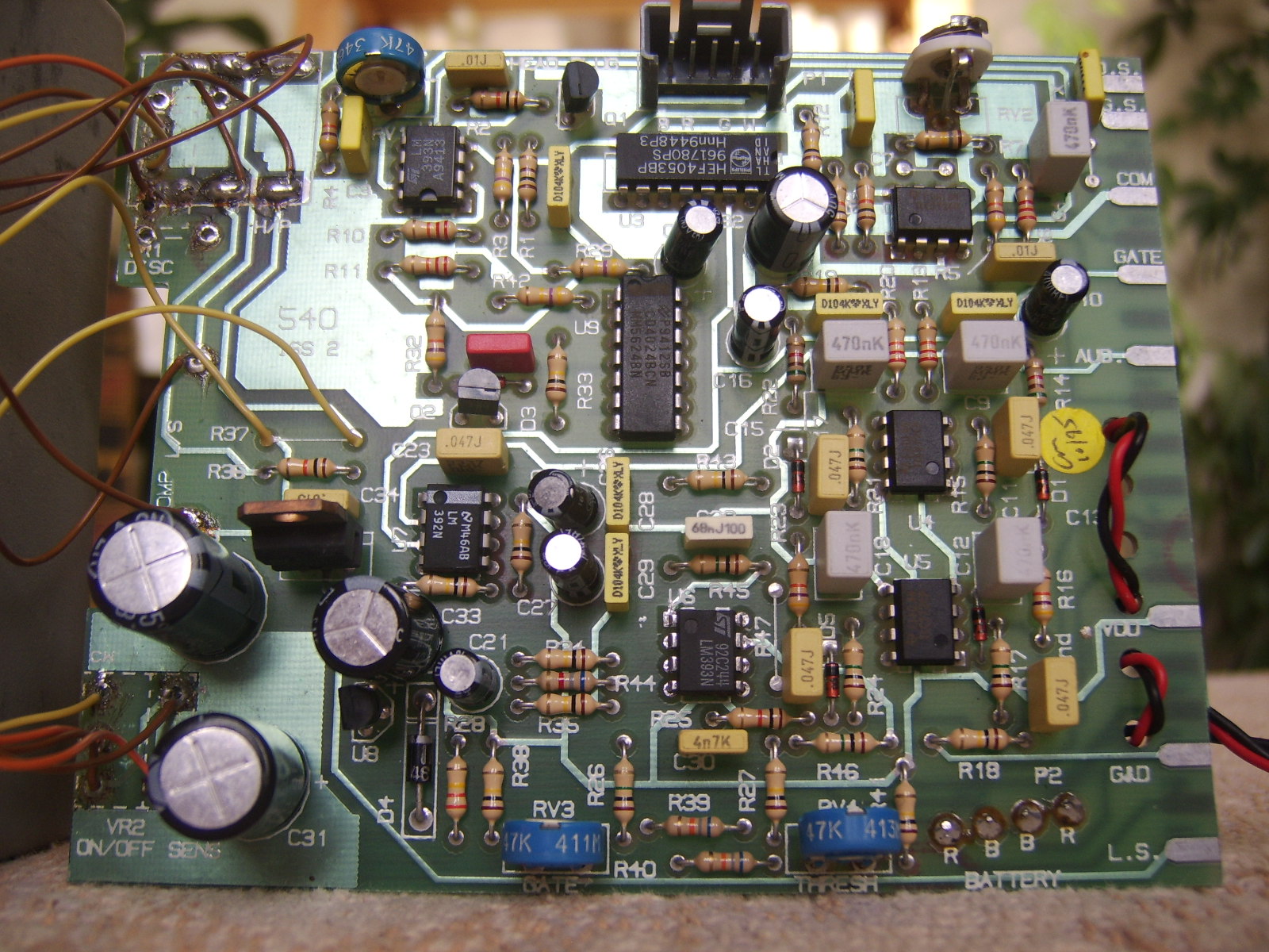

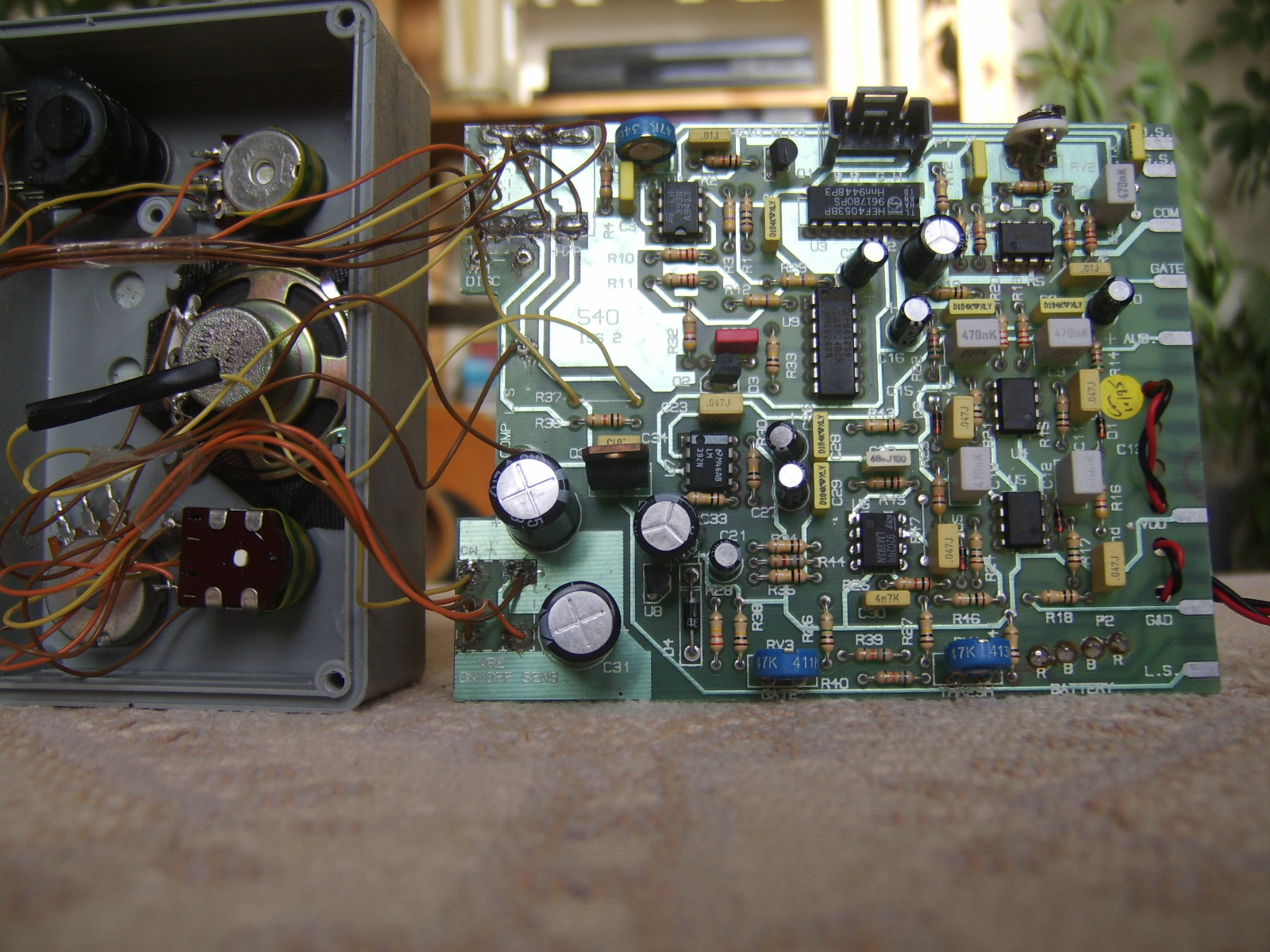

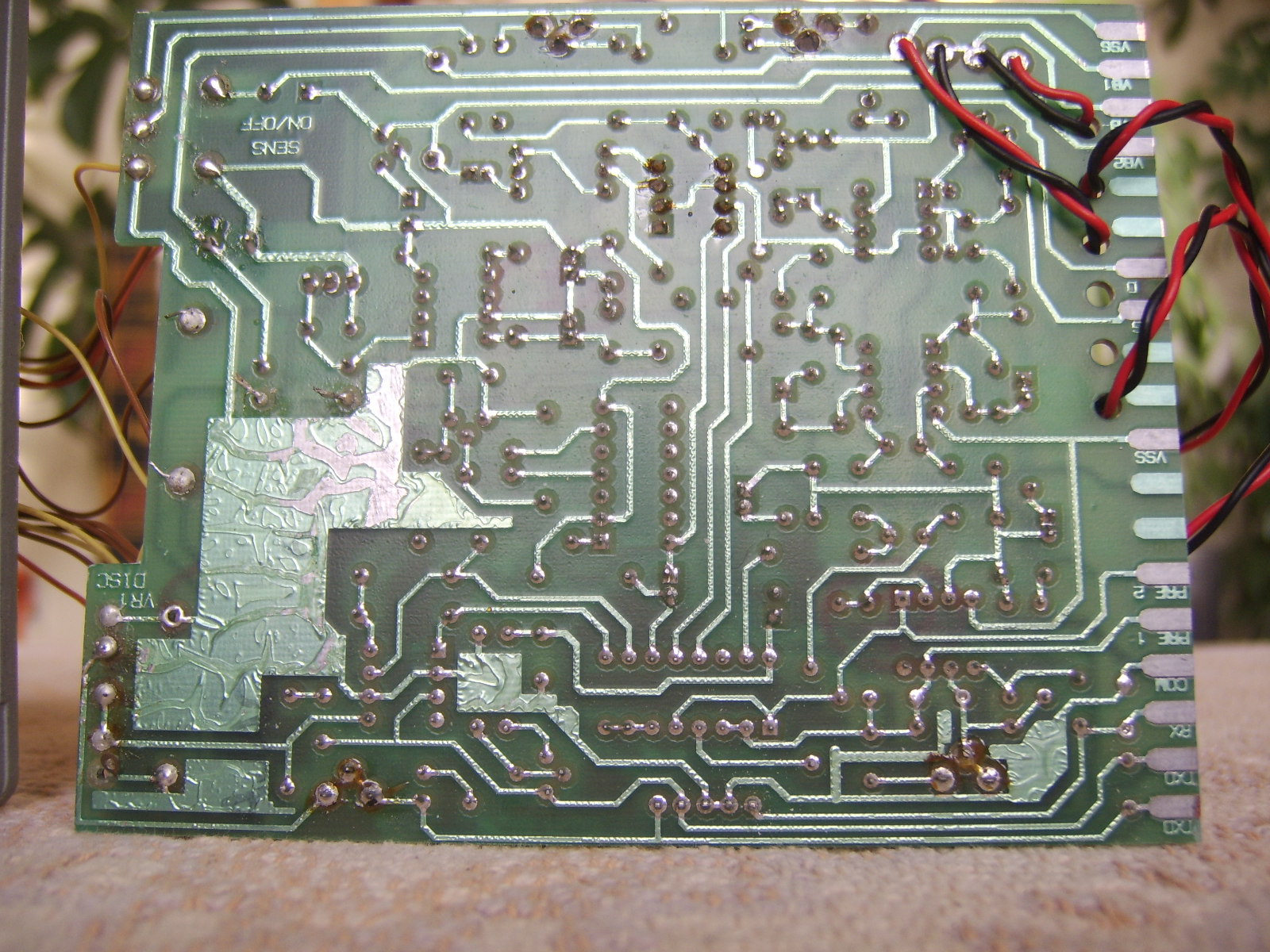

                  Hi folks,
                  As promised here are some photo's of the PCB of the Cscope CS2M. I have made some modifications - detatched the control pots from the circuit board to make more room in the control box for 2 x 9v packs of AA cells. As someone recently said on the forum "People who design detectors to run off two 9 volt batteries should be shot" Here here, I agree!
                  Anyway I will leave the board out of the box for a week or two as I know you guys will need to know about the component values that can't be seen in the photo's. Just mark on the photo whatever you want clarified and i will check it and post the info. If anyone does manage a rev eng of this machine then post your PCB, parts layout or schematic here and i will check it against the board. In a few weeks time i want to return it to factory specs and sell it, so I won't be able help with enquiries for long.
                  Good luck!
                  Regards, Jim.
                    CS2M PCB
                      Another view.
                        Track side.
                          Anyone Interested?
