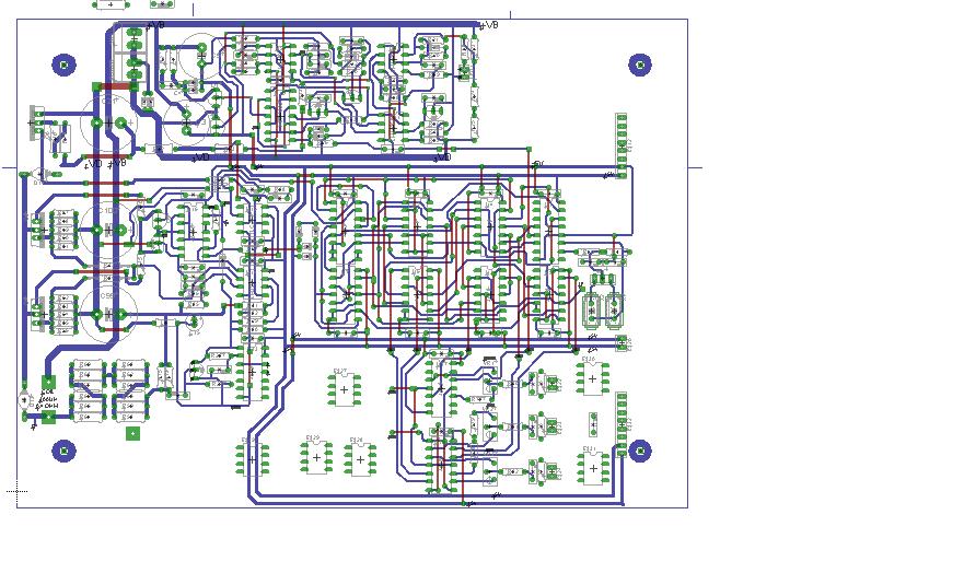

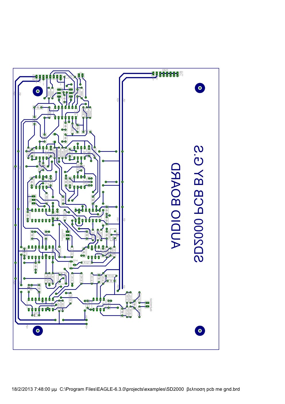

                  • I would like your opinion. SINGLE FACE PLAQUE ..
                    I have not yet completed ..
                    • g.s.
                      What shematics use?
                      I've seen some of them with errors.
                      Lucafa
                      • USE schematic from the zed

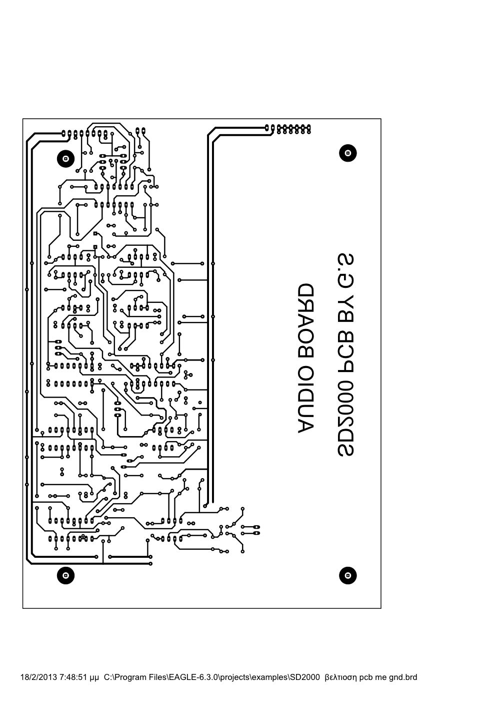

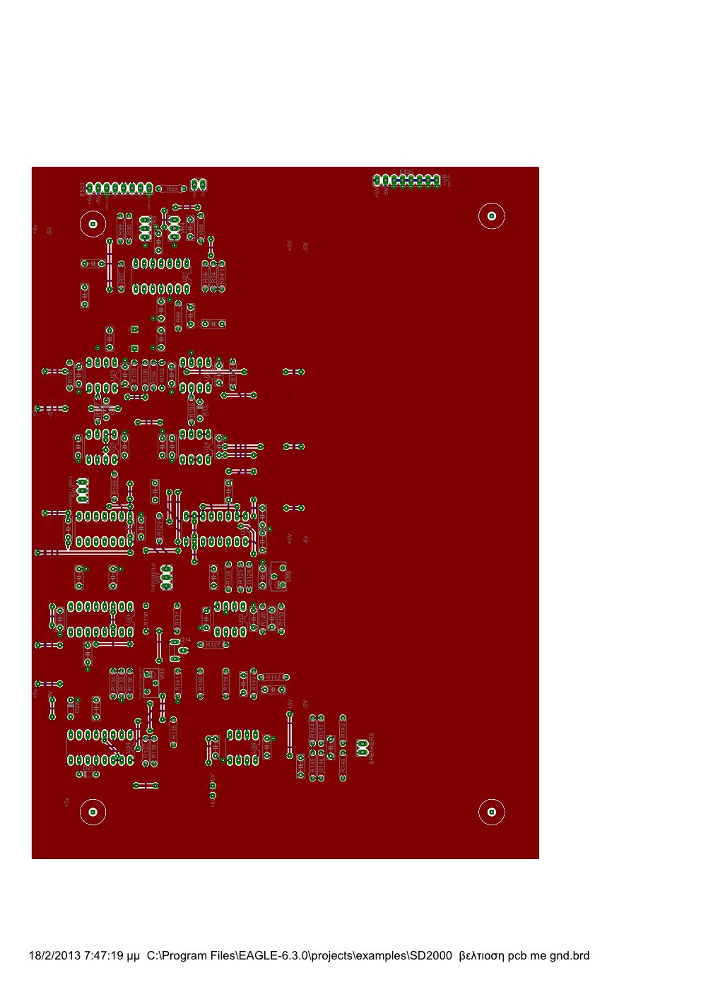

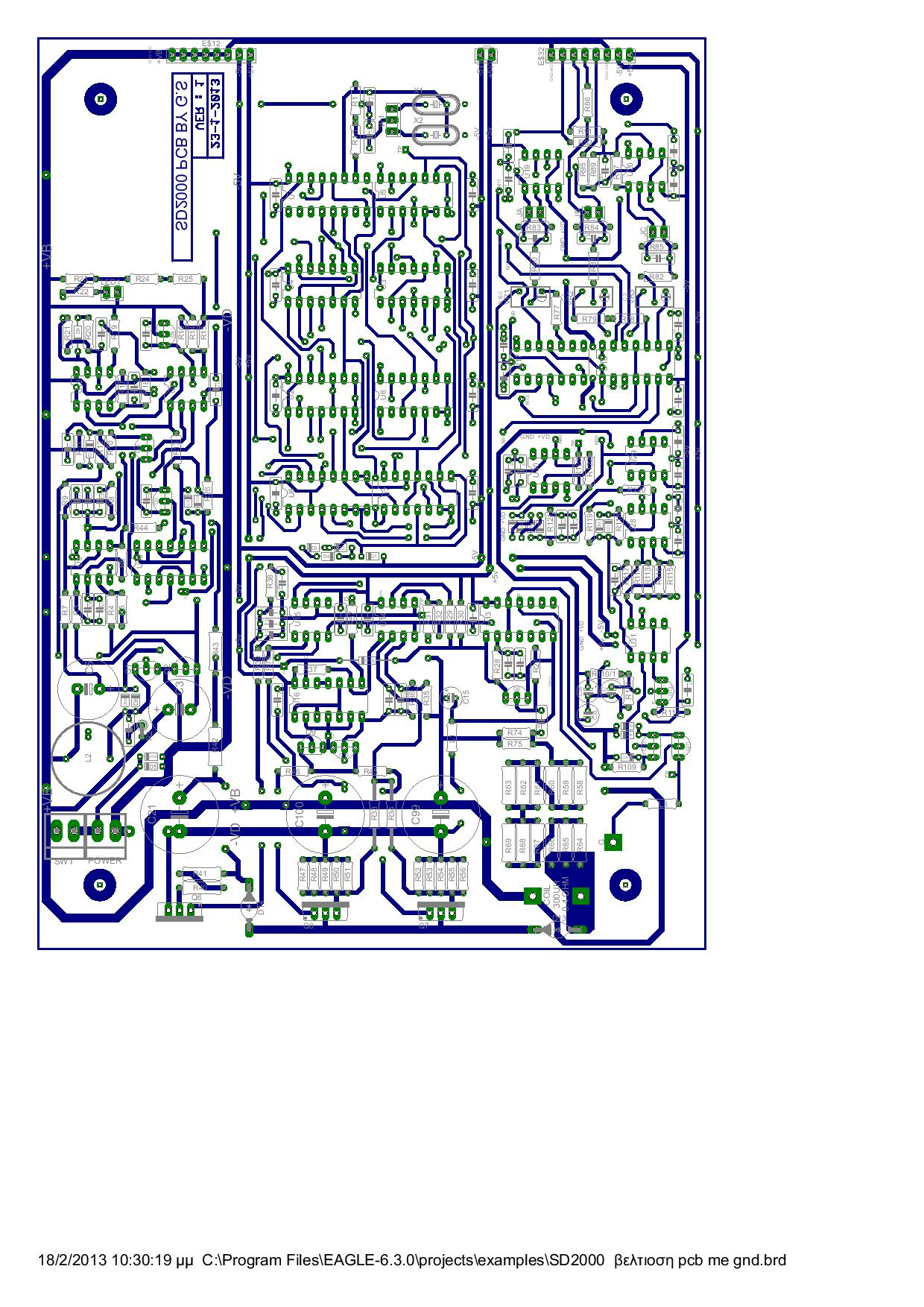

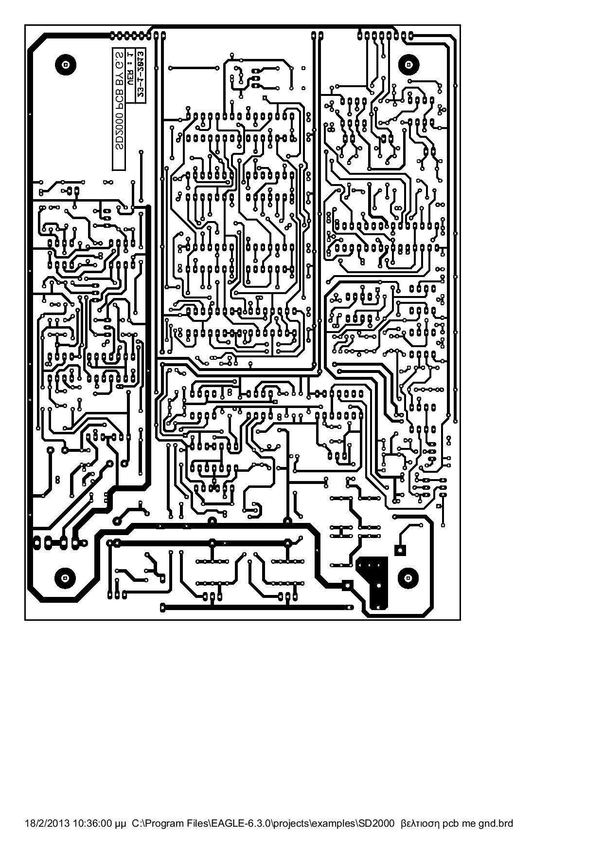

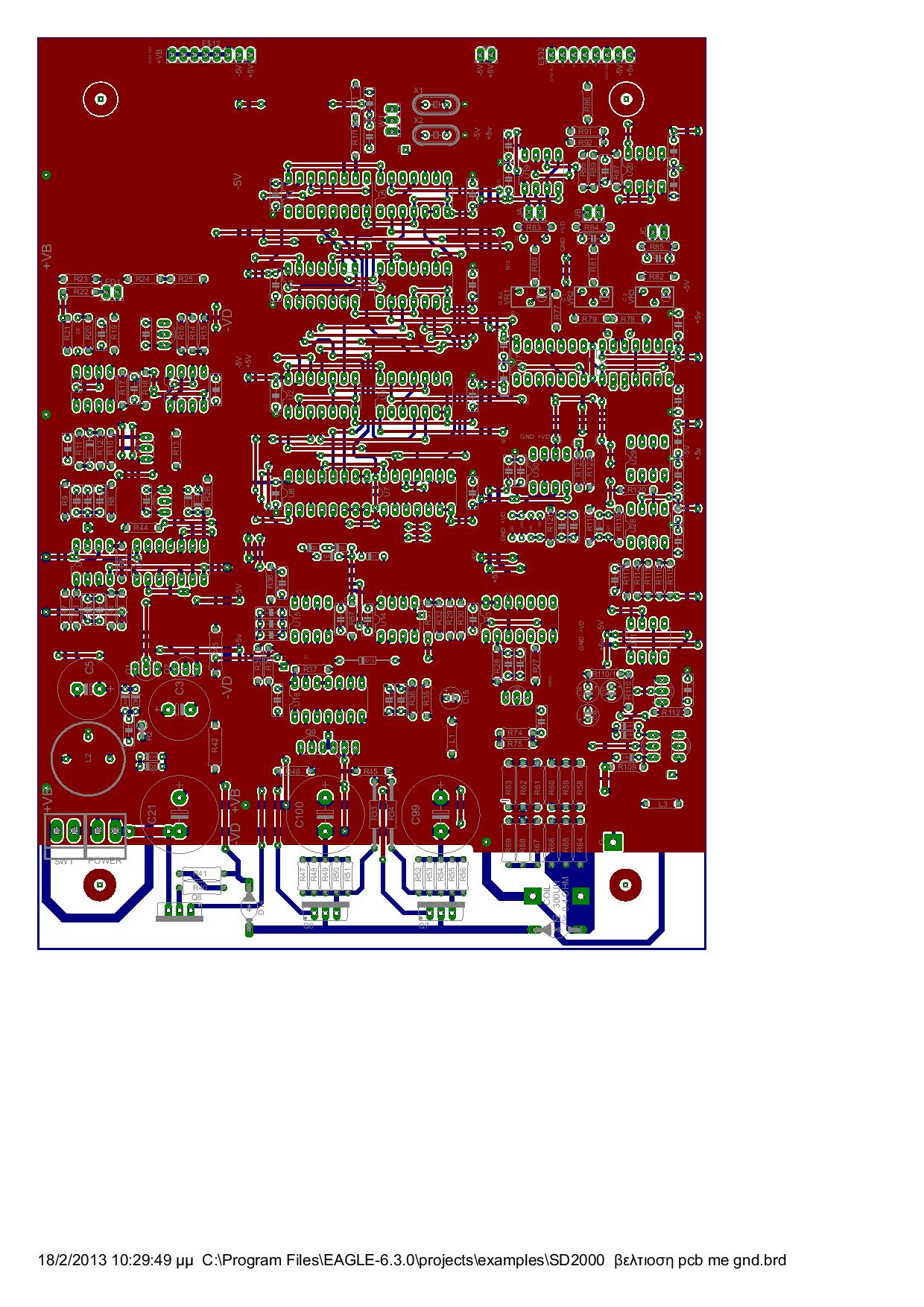

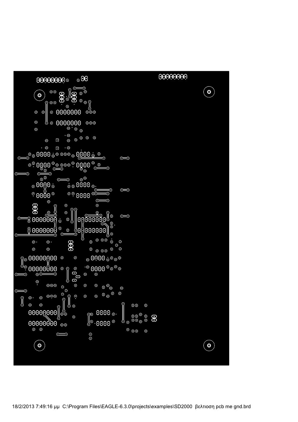

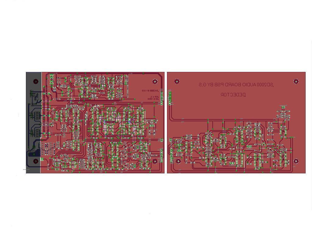

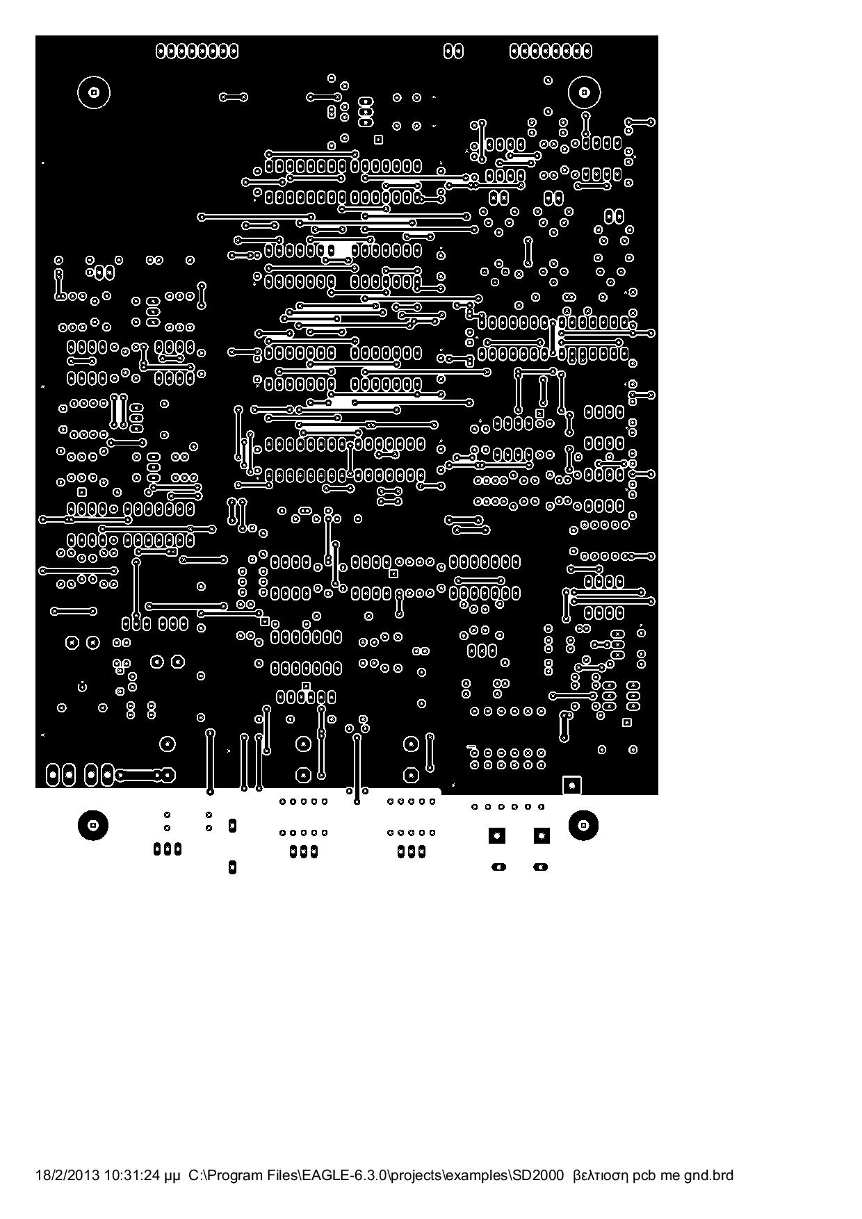

                        • FOR TO ALL. FINISH PCB BY G.S. WHEN WILL UPDATE THE PLAQUE ASSEMBLY AND DO TESTS
Name:	SD2000 BY G.S.JPG
                          • Good looking board g.s., keep your work.
                            Is this surface mount or trough hole - pictures isn't really clear?
                            • I have to make SOME corrections and will publish here with better resolution, WM6 BELIEVE TILL TOMORROW to finish
                              • here are with good resolution. you can choose for any errors
                                I would happy if I had a little help.
                                Acknowledgements G.S
