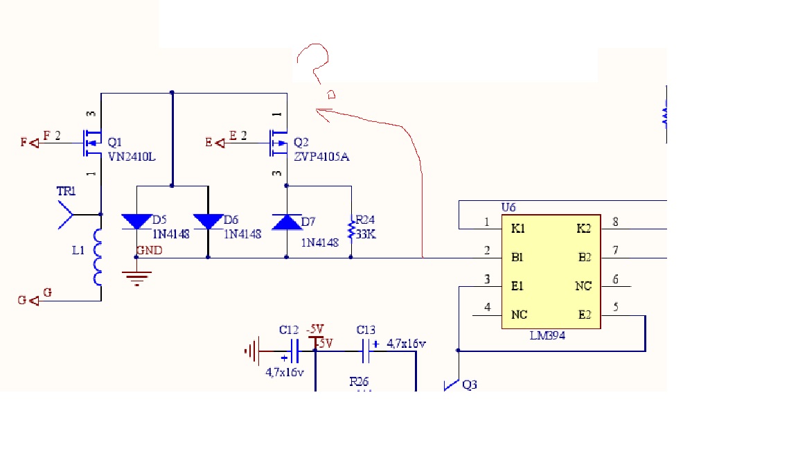

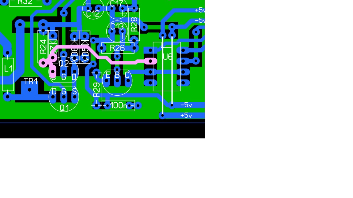

    • there are errors on the schematic
        • Yes I've mentioned it in my post above on this page. Refer only to the original schematic posted by ZED.

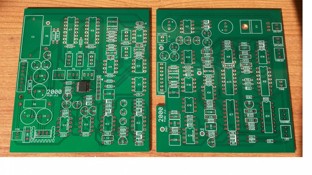

                • Been working on modified / simplified version of this thing. V1.3 of the boards arrived. What I did is:
                  - Removed the entire pulse generation, transmitter & power sections
                  - Removed the complex snubber I know nothing about, would probably try without one, or try and use the optional 2x zeners (or one fast rectifier HV) diode/resitor/cap
                  I can also try and disconnect the snubber section with the blocking signal for the front-end mosfets.
                  - Mosfet should be able to reach 400-500V with or without the snubber. 600V is the maximum due to the limit of the blocking FET
                  - power supply is simple 7660/LT1054 boost converter (+5V), 79L05 for (-5V) and one more for 3.3V. Can be connected to battery of any sort because I've added a fixed
                  7808/7810/7812 regulator (not decided on which voltage it would work best so I need to try that).
                  - Parts removed allowed me to fit the whole thing on 2 boards 90x100, sliding in Hammond case, one will go on top of the other connected with 8 PIN molex connector
                  - Timing will be controlled from a single 20 PIN SSOP PIC32 CPU (thing is smaller than 8 PIN op amp!!!), - will generate TX, SAMPLE1-SAMPLE6 and the blocking signal for the protection mosfets (fed to dual inverting/non-inverting mosfet driver), I can probably get it to work down to 2.5uS IF I can get it to work at all
                  - No inductors, SSM2210 for the preamp (I should check and compare with AD797 setup), integrator gain increased to x2.2 from the original
                  - level shifting and stuff needed to be done, 4066 won't going to work so I tried something else instead to drive directly from the MCU, things may go horribly wrong there
                  - P1-P3 are connections for some software upgrade (FREQ/DELAY so on adjustments).
                  - 1206 decoupling caps on all damn ICs on the bottom, 2 each
                  PROBABLY won't work at all but hey I will try anyways.
                  Almost same front end (PCB on the left) can be used for the GoldScan 5.
                  No share / no sale at this time guys.

                    Zdravo,hi eclipse
                    News good, infa ok ?
                    remove snubber burnt all transistore. bad idea. very bad.
                    zeners solder to bad, much noise, bad voltge drift.
                    Mosfet 400-500V bad, max 200V, best 100-200a curent. very high fast need. ocean front wave crash big boat, not wave. front crash nuget gold not pulse. gold sing when crash. ok
                    7660/LT1054 must synce global osc./atenuate koefficeint. cros-inference blok.
                    7808/7810/7812 too bad no ok. noise grat rise no choise.
                    inductors must did. avoid inference.
                    integral gain rise to bad - noise rise quadratico. need optimale integral koefficeinte.
                    SSM2210 put 4 paralel all, one at two at tree at four, noise got NF/4. not many impedanze need match valid.
                    need excelent design new way, not discover hot water.
                    good day sir.
                    luck with you
