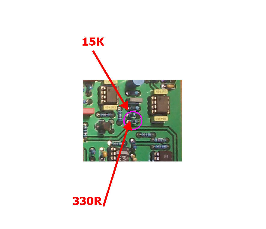

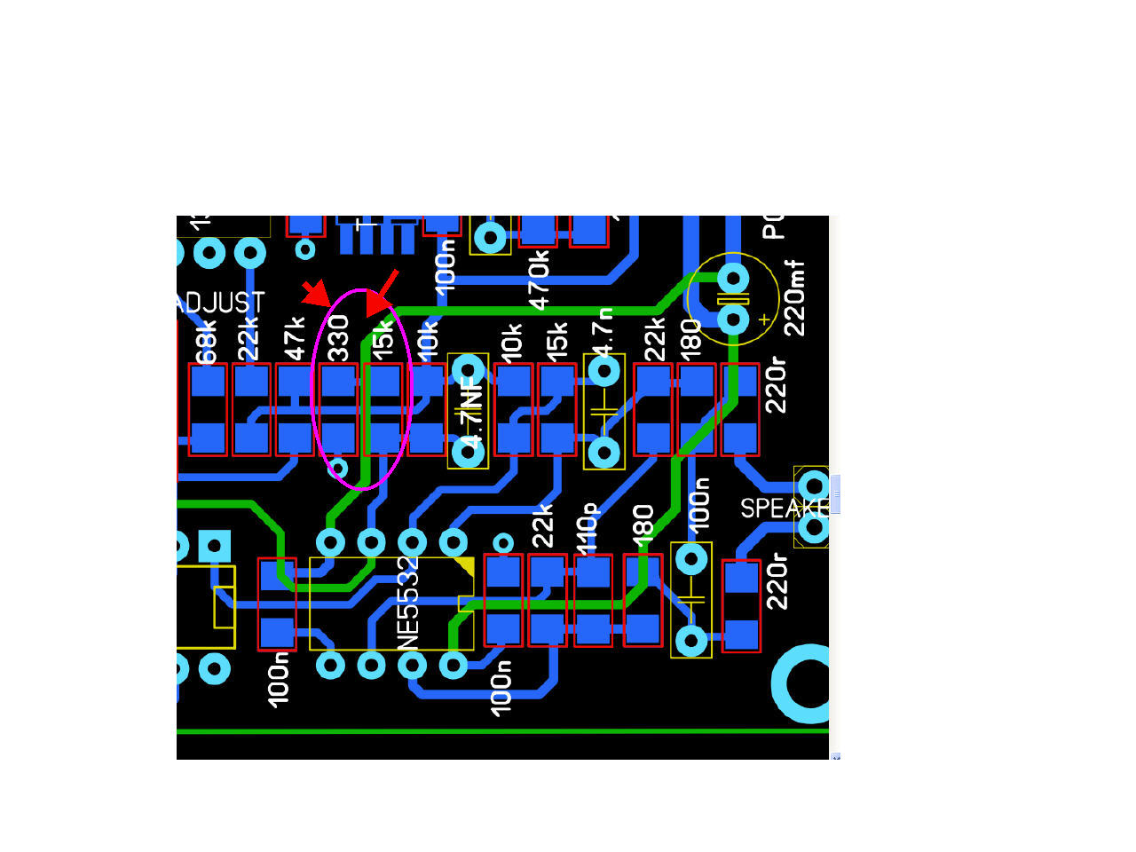

Full m/lab SD2000 schematics
  • Except if 15k should be trim-pot.

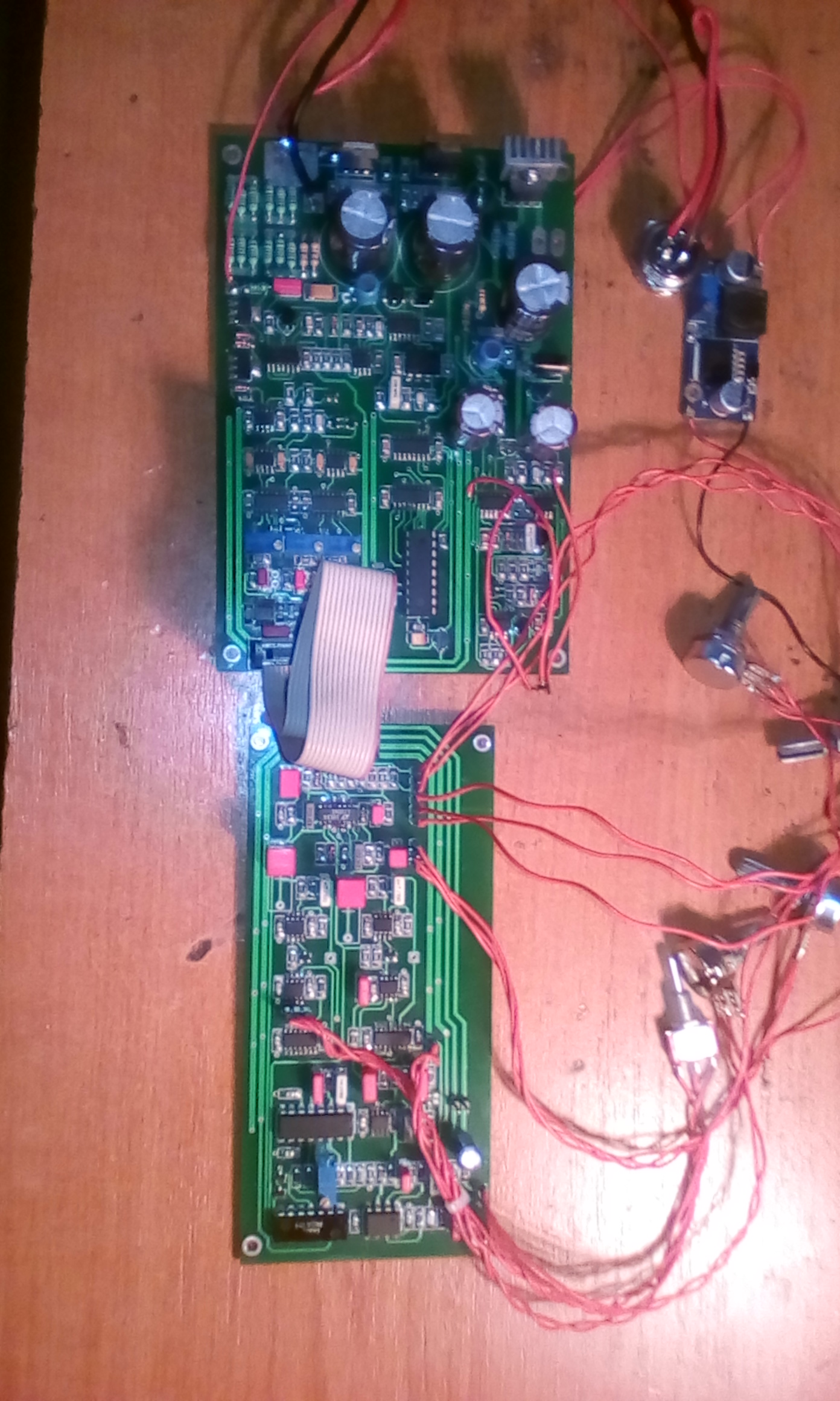

      PCB-2 Click image for larger version

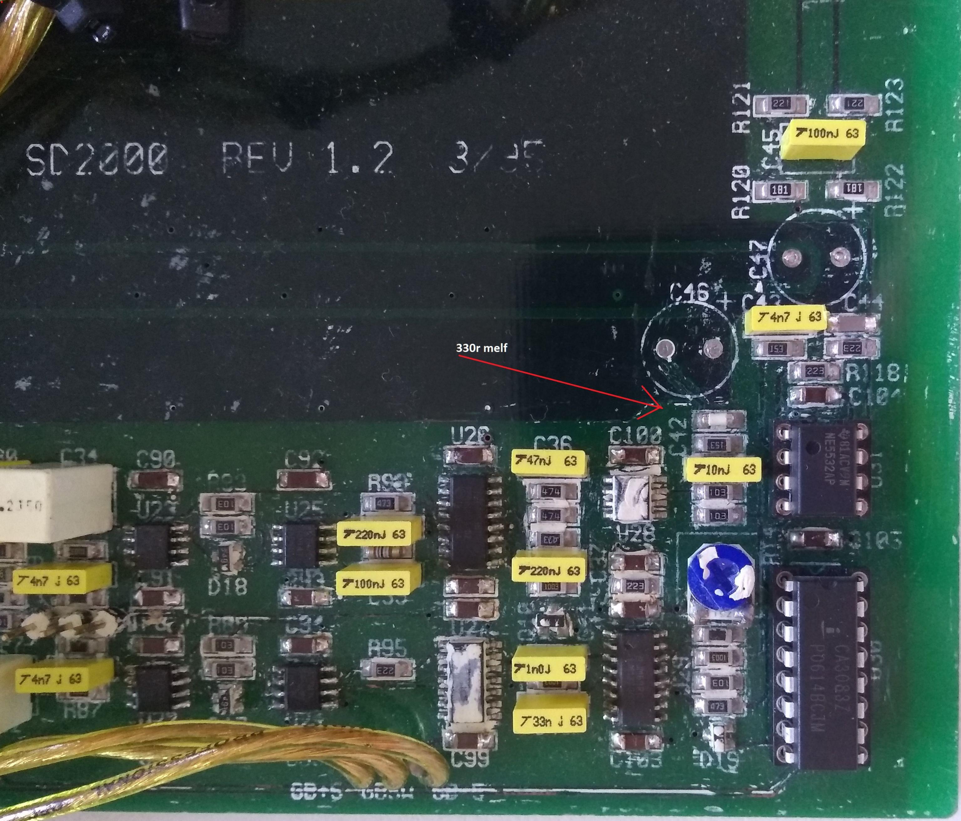

      • Hello detecto
        See pic,the 330r resistor is part of the voltage divider,it helps zero the DC offset on the audio output.
        • Hi Zed! Can you take a photo of the whole board ?
