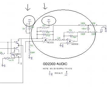

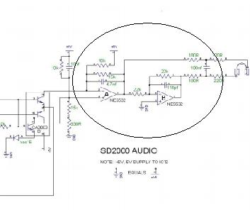

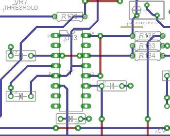

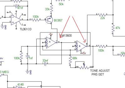

just checked mine and the voltages around the ne5532 are correct. Check pin 15 lm13600 should have a saw-tooth wave that changes with adjustment of the tone control, pin 14 will have a square wave. Check that the threshold pot is adjusted to the 5- side, this should bring the audio on full. Check pin 10 ca3083, with the threshold pot set to the 5- position, pin 10 should read about 1v+, with the threshold pot set to the 5+ position pin 10 will read about -5v. Check the 4053 at the end of the filtering section, just before the audio section. Pin 14 should only have signals that go from gnd to 5-, pin 4 will have signals that go from -5 to +5v and anywhere in between, touch around the lt1057's while probing these pins and there should be an obvious response. Did you connect the enable pin on the 4053 to 5-?

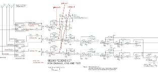

Now with the 1057's, were these tests done with a coil or no coil? With no coil, on the gb channel output, I get a waveform +-2.5v. On the ch1 integrator output I get 1 drop to about -2v and for ch2 I get 4 small pulses that drop about 1v below gnd.
Check that pins 5 and 12 on the 4066 for the GB channel have the GB pulses shown in the schematic, they should swing between 5+ and 5-v. Check all your sample pulses are the same as the schematic. Check that your tx pulses are the same as the schematic.

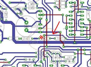

THANKS mechanic Finally a little unwary the g.s except the mistake I have in lm 13600 I've done and ca3083 I've put no extin at ca3083 pin 9 and pin 13.attention Anyone making USES pcb by g.s should correction Those reported above.
