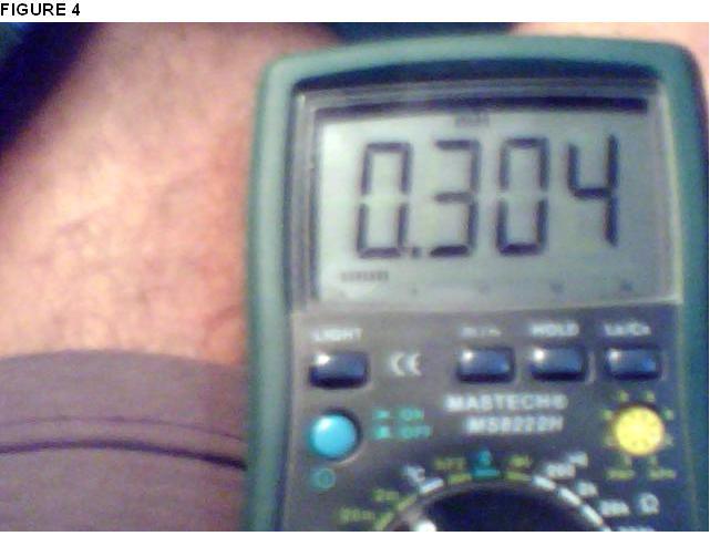

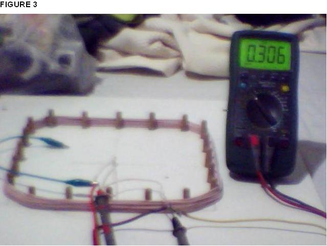

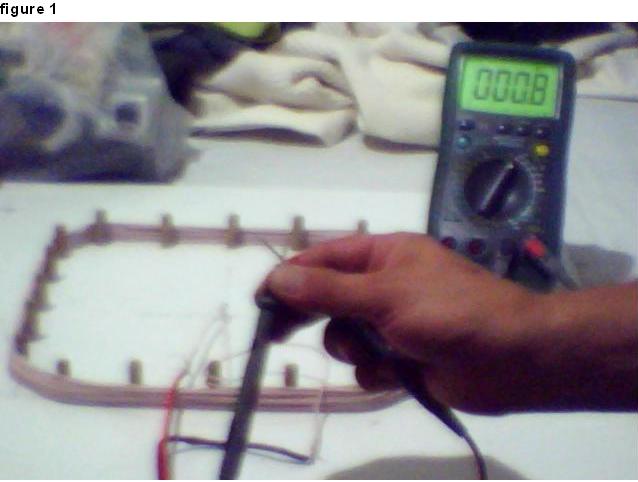

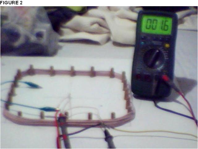

          • GOOD EVENING TO ALL HERE .. finally found WIRE LITZ ..
            Before we start by to construct coil I want to clarify the following .
            1 . When measuring with my lc meter and link the two together TERMINALS to count ohms then observe that it lc meter show resistances are 0.8 ohms have a look at FIGURE 1.
            2 . When measuring the coil I see resistance 1,6 ohms next The resulting difference is 0.8 ohms have a look at FIGURE 2. Is this the correct technique used.
            3 . is correctly mh this is very close to the desired figure 3 end 4 .I would like your opinion Thanks in advance G.S ....................

            • Hi g.s,
              The inductance is fine but remember when you lace the coil up to a tight bundle the inductance will increase you will soon learn how much to allow for after you have done a few, I lace my coils up with a running lock stitch at around 10mm spacing using fishing braid also if you change the shape of the coil after you remove it from the former the inductance will change as for the resistance if you are using the 660/46 Litz it seems a bit high there could be two reasons for this.
              .1. First make shure that all strands in the wire bundle are soldered properly (this is extremly important) I do this with an old fashioned soldering iron with a 3mm hole 10mm deep drilled in it I heat this up with a gas flame when it is realy hot I then apply solder to the hole to within 2mm of the top then place the litz in the hole untill the solder has fully flowed.
              .2. the other reason could be the accuracy of your meter my LCR meter measures resistance to .001 of an ohm but my multimeter does it the same as yours but it is no where near as accurate.
              Regards, Ian.
