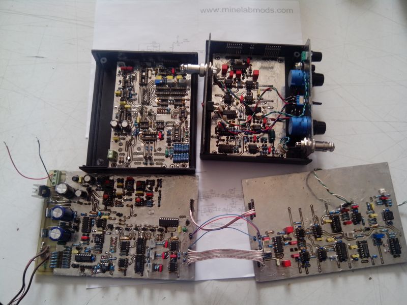

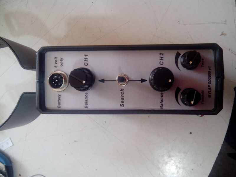

Hi All I need from some help for SD2000
Switch for channel 1 and 2 where is connected to pin 2 of CD4011 maybe it need to connect to pin1?
About Audio with CA3083 why pin11 /Emiter of Q4/ and pin7/Collector of Q3/ not connected?
Can I replace CA3083 with CA3046?
Zed's schematic is correct,not need to be changed! my copy of SD2000 work good with CA3046.
