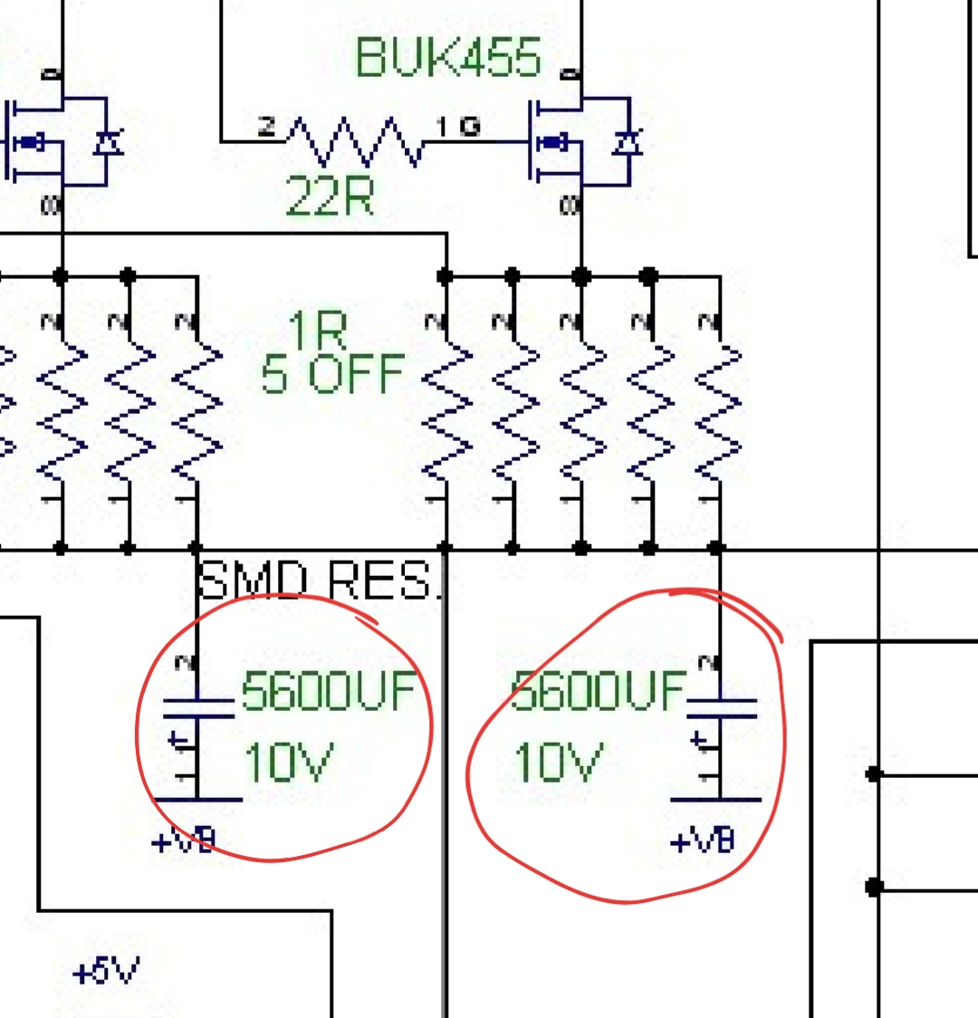

Full m/lab SD2000 schematics
Esr is the thing you want to look at for those ones.
The originals were 5600uf, but there are better ones(used in later detectors) that are 4700uf 10v nichicon. They are hard to buy though.
All in all it probably makes sweet FA difference.
Cheers Mick

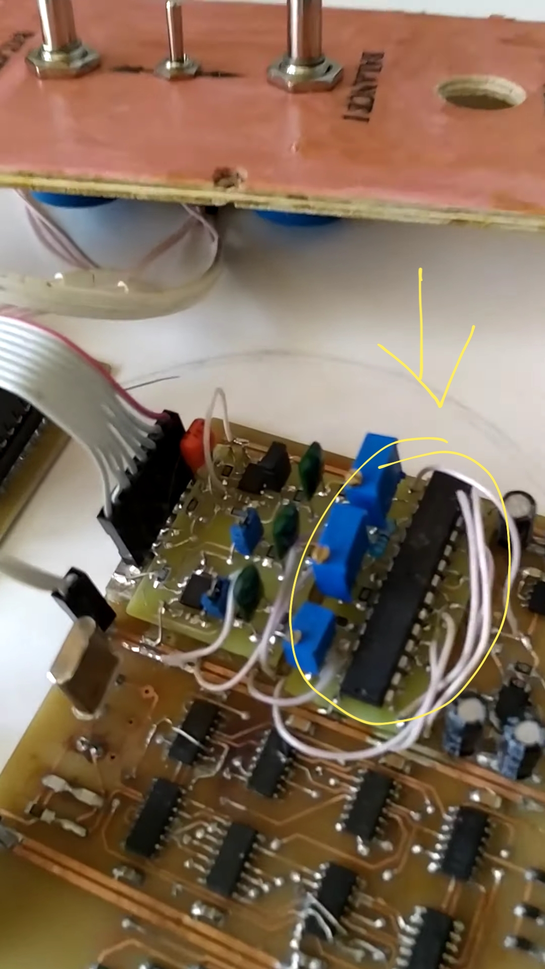

Hi!Originally posted by Anis View PostHi Andrei, I take a look again to your last vedio of the SD2000, I would like to know what Demodulator you are using it seems to be not the 4066.
[ATTACH]50416[/ATTACH]
Rgds
Anis
These are two 4066 DIPs, before that here were 4066 SOICs, the result has not changed
