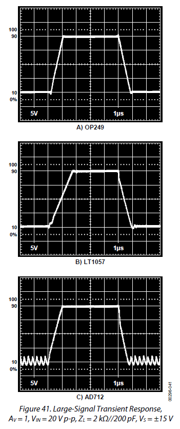

    • Hello Andrei
      The OP249 has some nice spec's but at 10 hertz its to noisy,see page 8 (voltage noise density),the LT1057 at 10 hertz is 25nv as opposed to the OP249 which has almost 60nv at 10 hertz.
      For me thats to much noise,but for other detectors it may be fine,i have a total gain stage starting at the integrator and finishing at the ADC of 8645,so an integrator amp producing 60nv of noise at 10 hertz
      would give me a noise signal that the ADC would convert.
