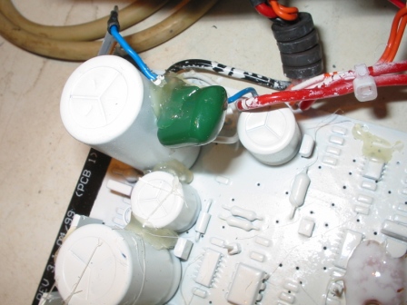

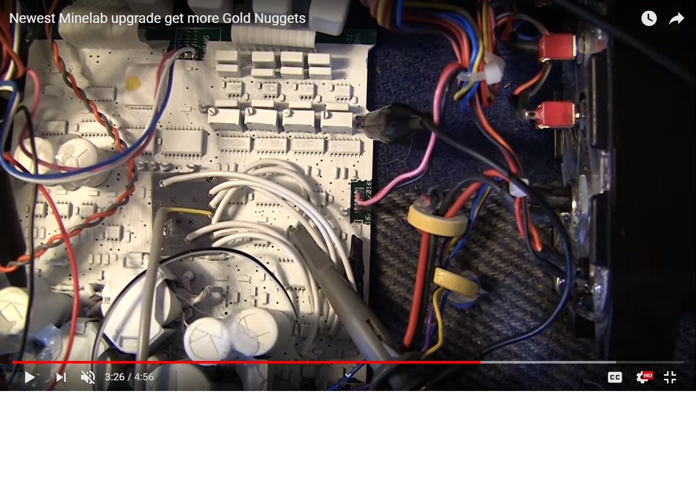

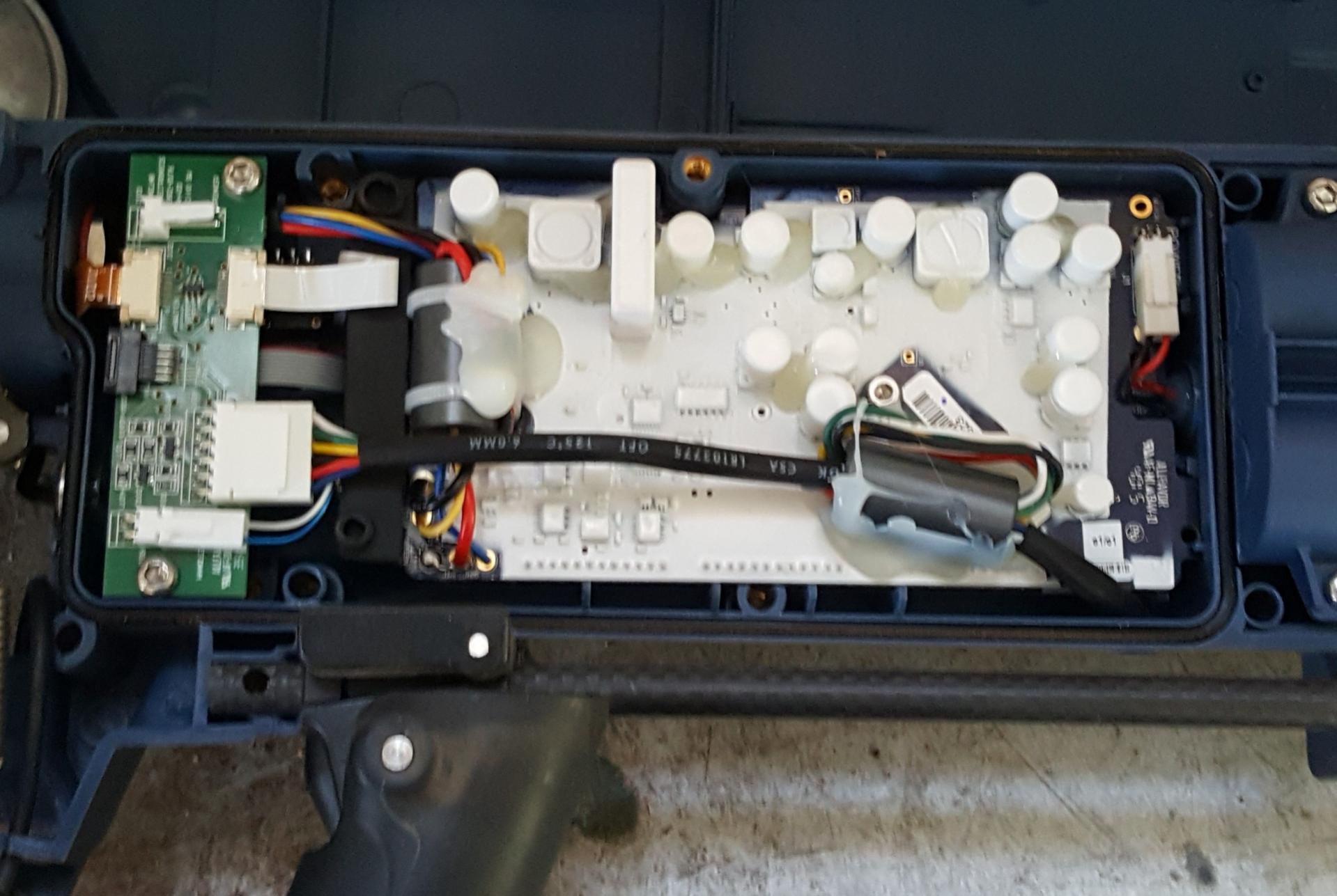

      • hello, i've noticed all sd/gp detectors have ferrite rings over the coil leads and power leads. Can someone tell me which type of noise we have/frequency range so i can choose the right ferrite? color code can be different from manufacturer to manufacturer.

          • Ionut_mtb, the ferrite ring is for radiated emissions for emc compliance purposes. I have seen orange ones, grey ones and big long black ones!

              Thanks, i understand, but why it has ferrite ring on the RX side also?
                  Don't know. Minelab run all the wires through the same ferrite ring. I guess it is standard practice to run all of the wires in a cable through whatever ferrite is selected.
                  • Hello everyone !
                    Mechanic is correct,its all about emissions,both transmitting and receiving,the receive also has fast transient pulses on it as well.It is possible to run these P.I. detectors with no ferrites
                    and they run just fine,but for compliance ferrites are used as part of a solution.

                        Correct, Ferrites are Only for CE/FCC compliance. They do NOTHING for coil noise pickup or detector performance.
                        What they do is reduce RF Emission from inside the detector which could cause interference to other electronic devices.

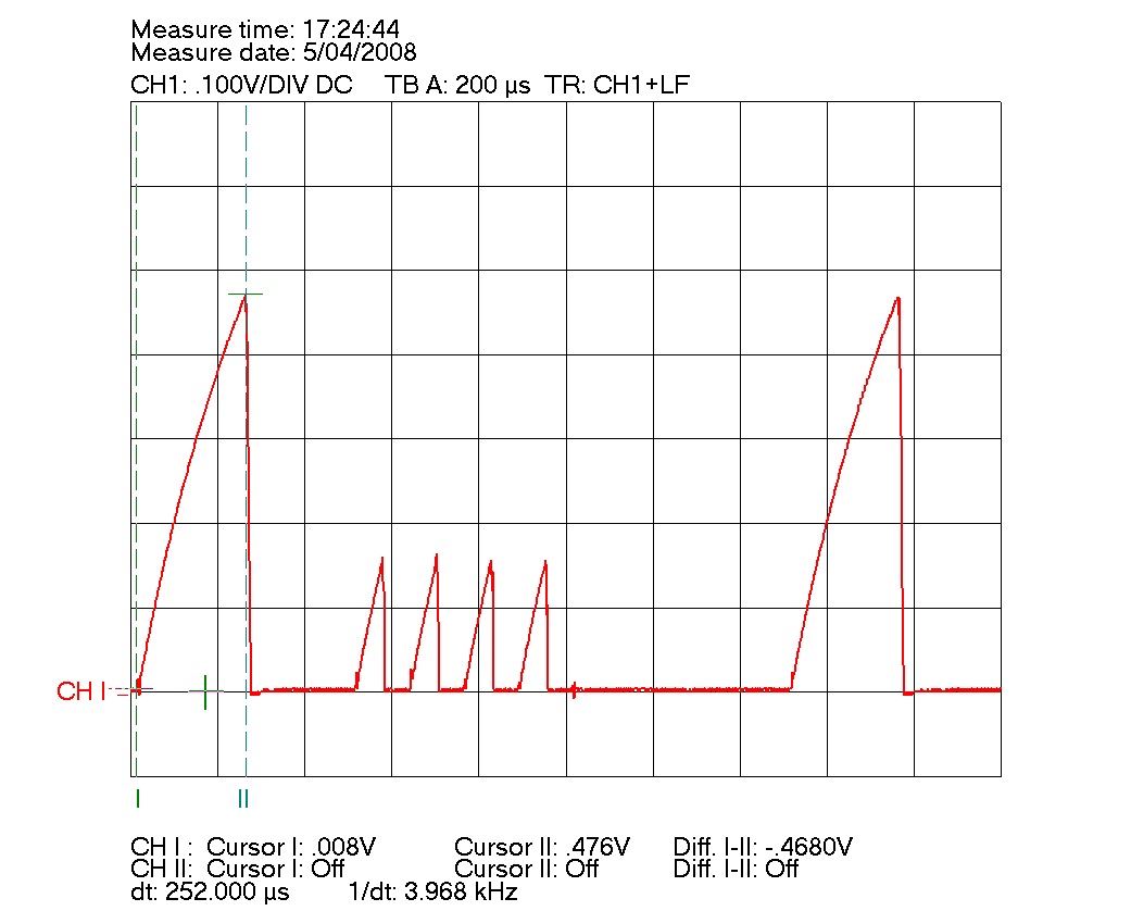

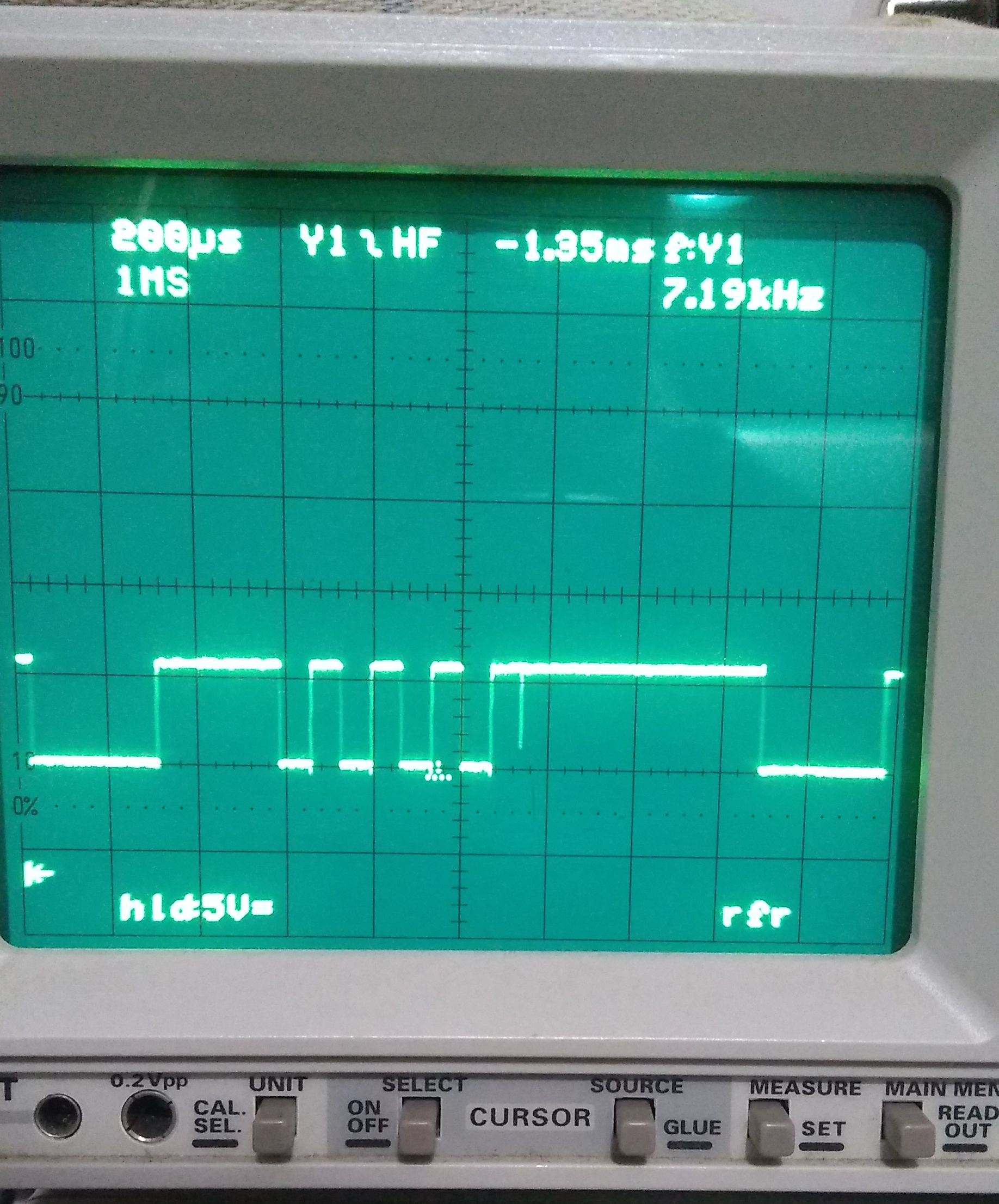

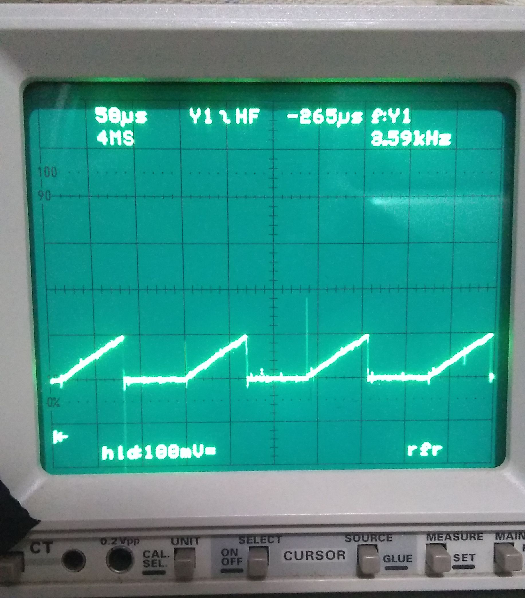

                        • Hello Anis
                          Please see attached image,it shows the coil current waveform on a SD2000 using a 100 milli ohm 5W power resistor (the white blocky ones), 1 ohm is too high and will affect the current going into the coil to much.The scope is set to 100 mv and each gradient on the screen equals 1 amp of coil current,this is what you need to see on your scope,mind you my supply voltage is over 8 volts so a 2000 on 6 volts will show less coil current,but over all the waveform should look roughly the same.
                          You will also note that the coil current doesnt flat top,this is normally the case with the SD2000.

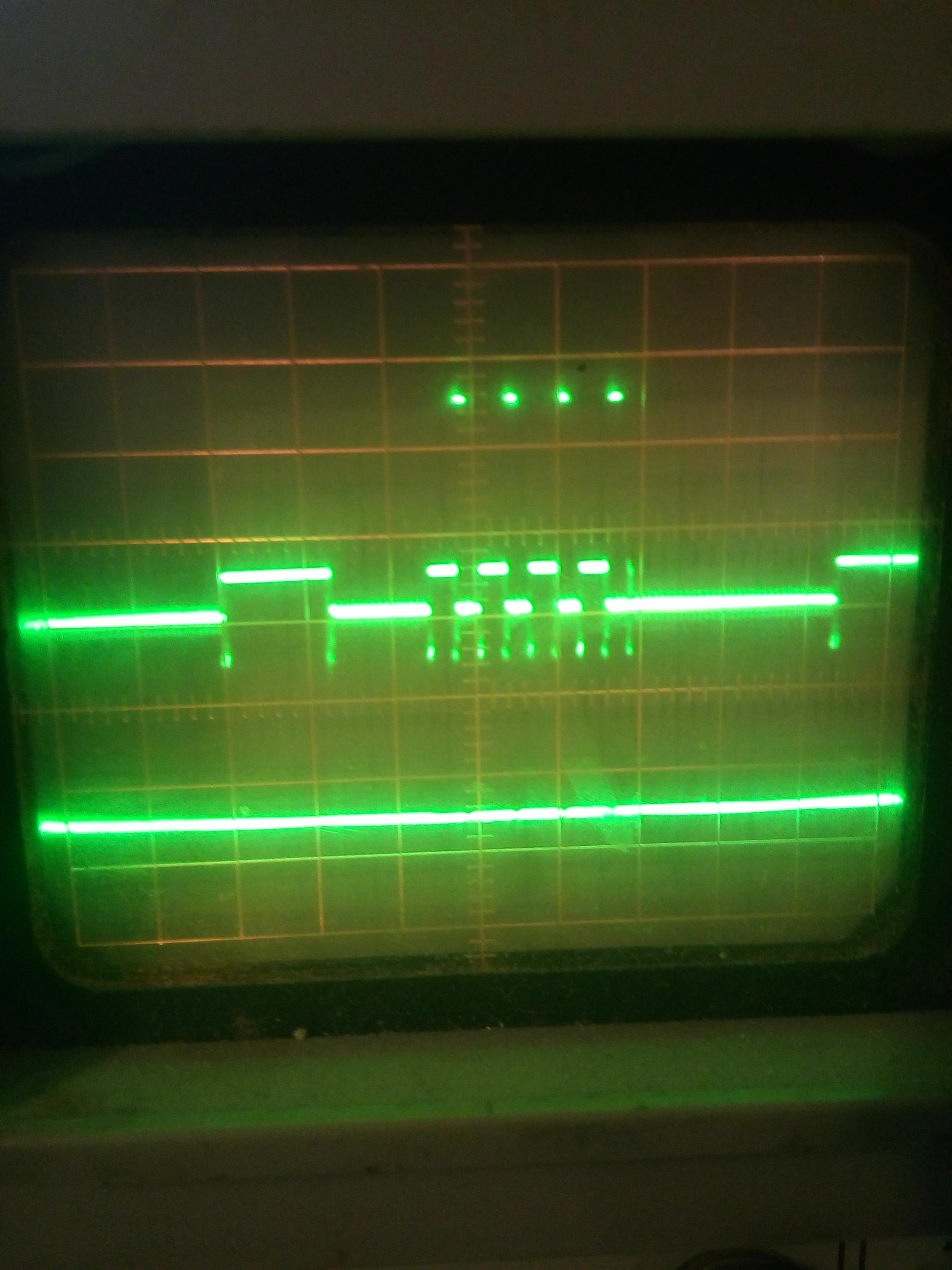

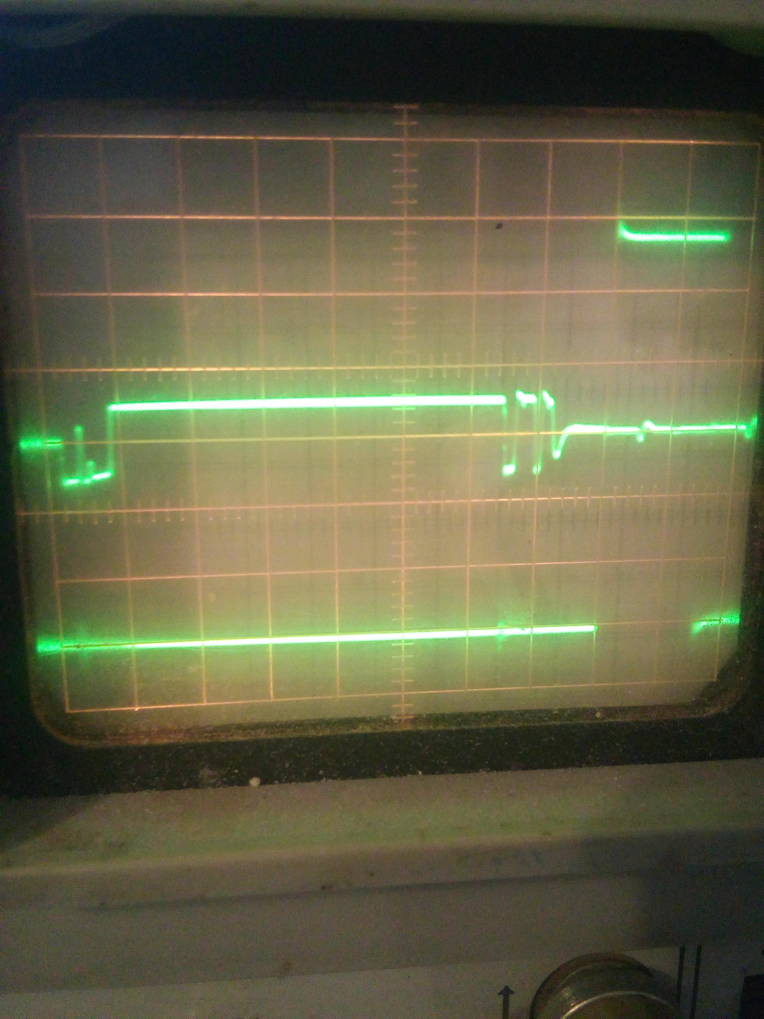

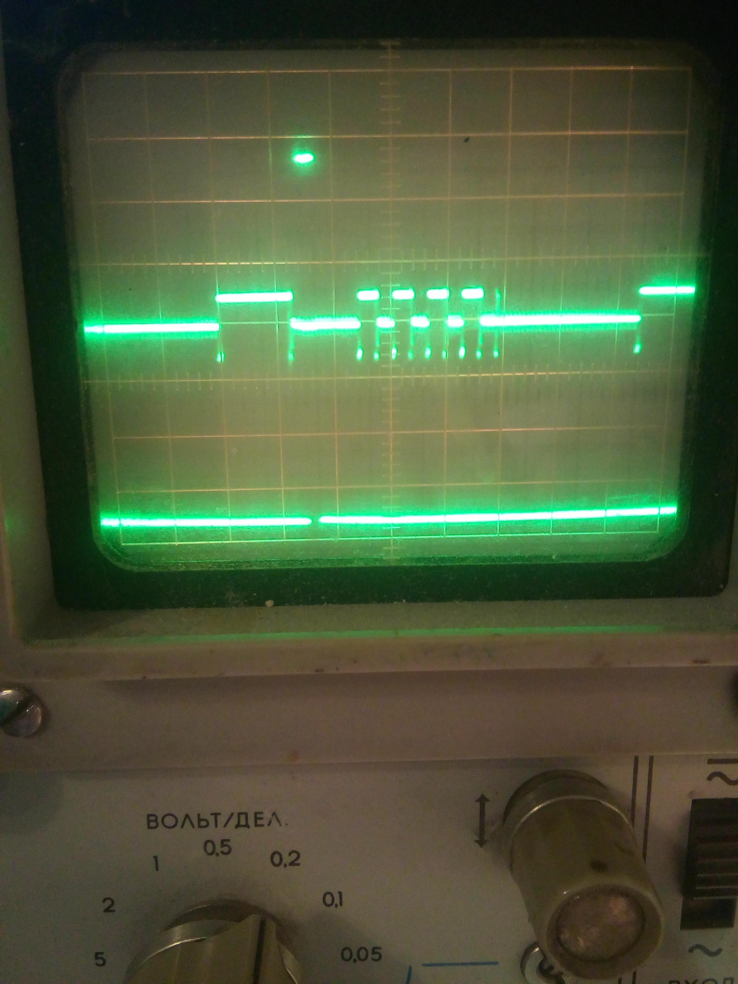

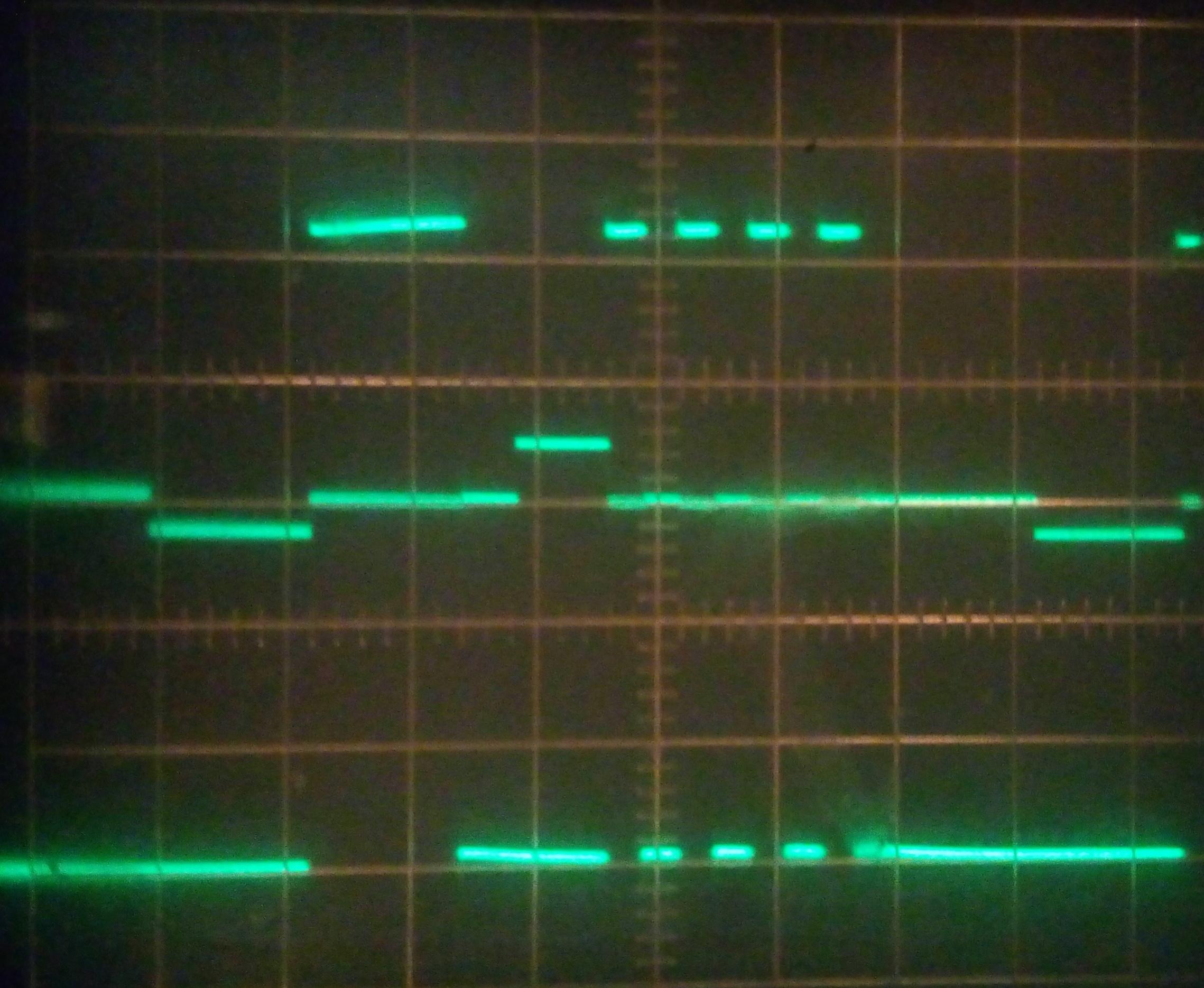

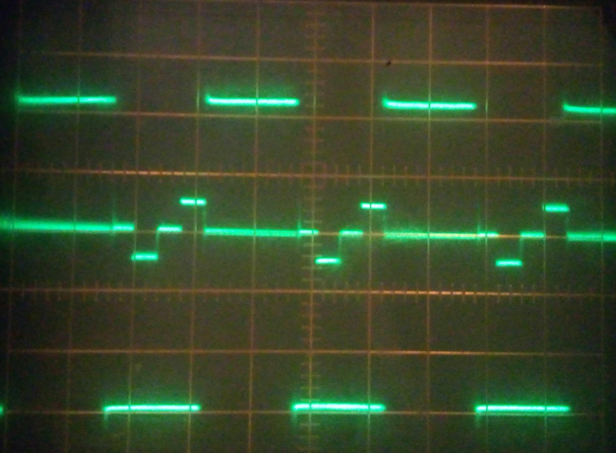

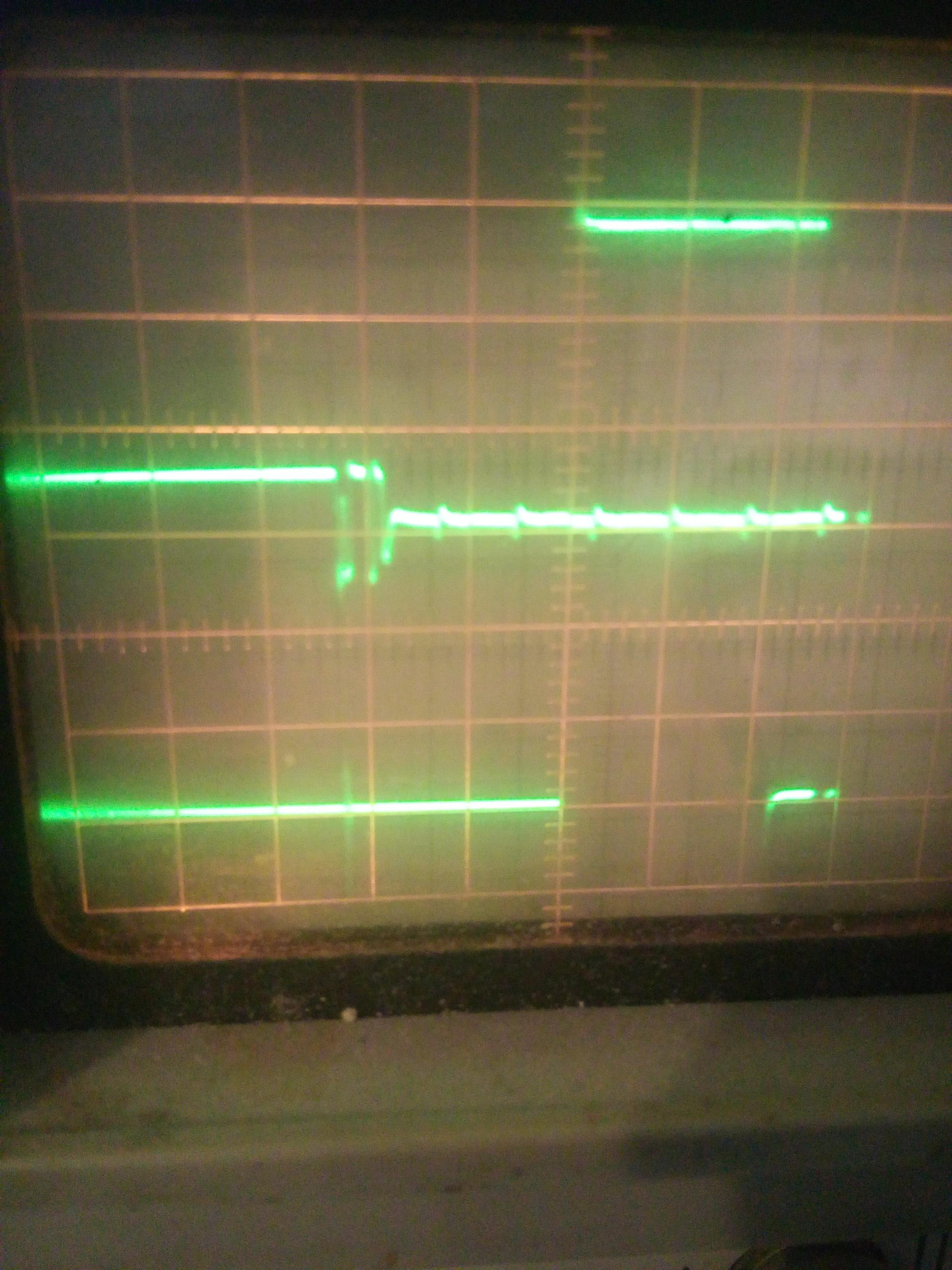

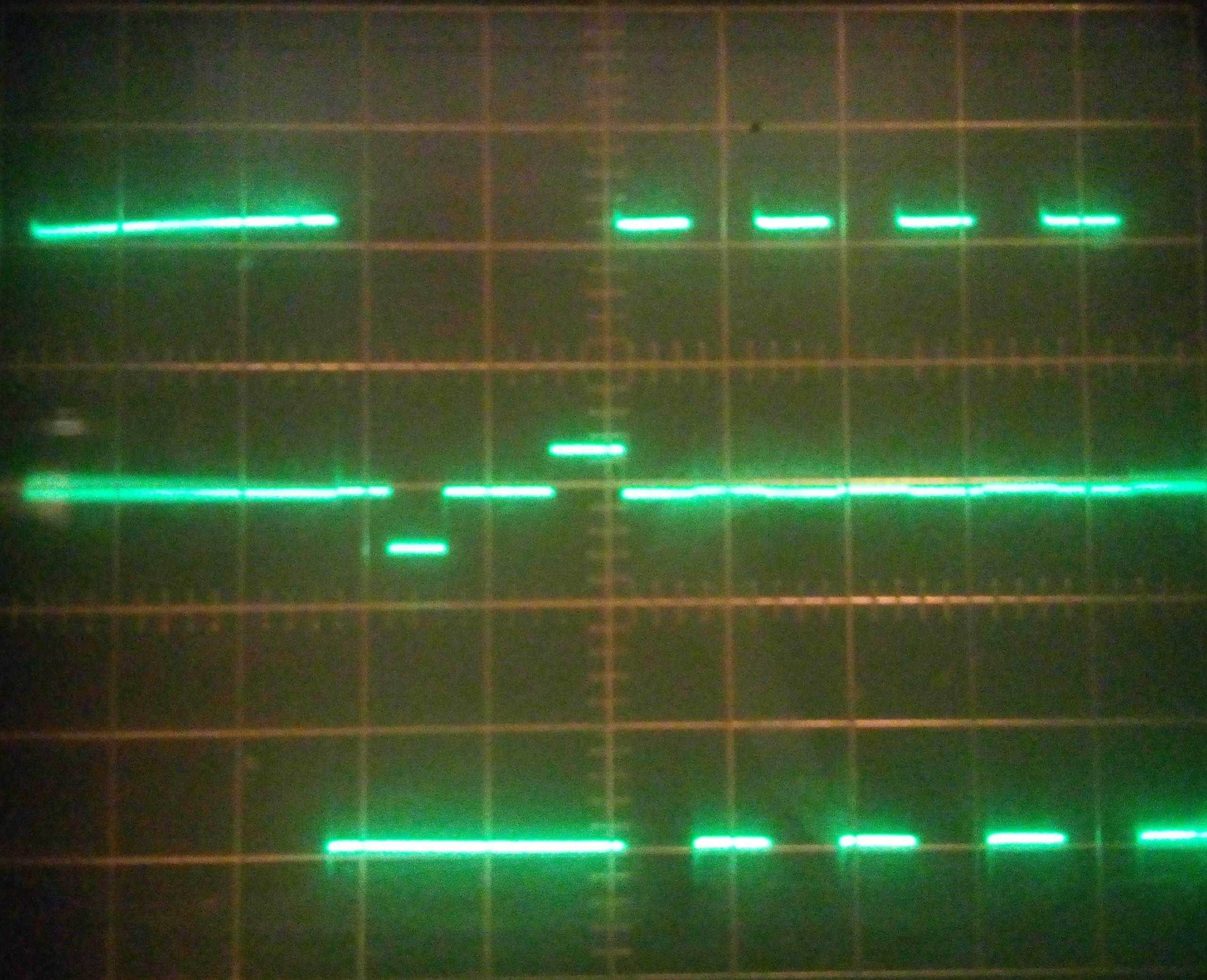

                            • This is the signal from the coil ... this is the signal on the fet gate.
                              When I connect a coil to rx or drain of vn fet the transistor heats up
                              and does not conduct and interrupts the signal on the gate vn ....
                              What could be the cause? TX -Click image for larger version
Name:	GND TX SIGNAL.jpg
ID:	356260 ... VN FetClick image for larger version
Name:	GND  ..N FET SIGNAL.jpg
ID:	356261 .. PN Fet Click image for larger version
Name:	GND ---P FET SIGNAL.jpg

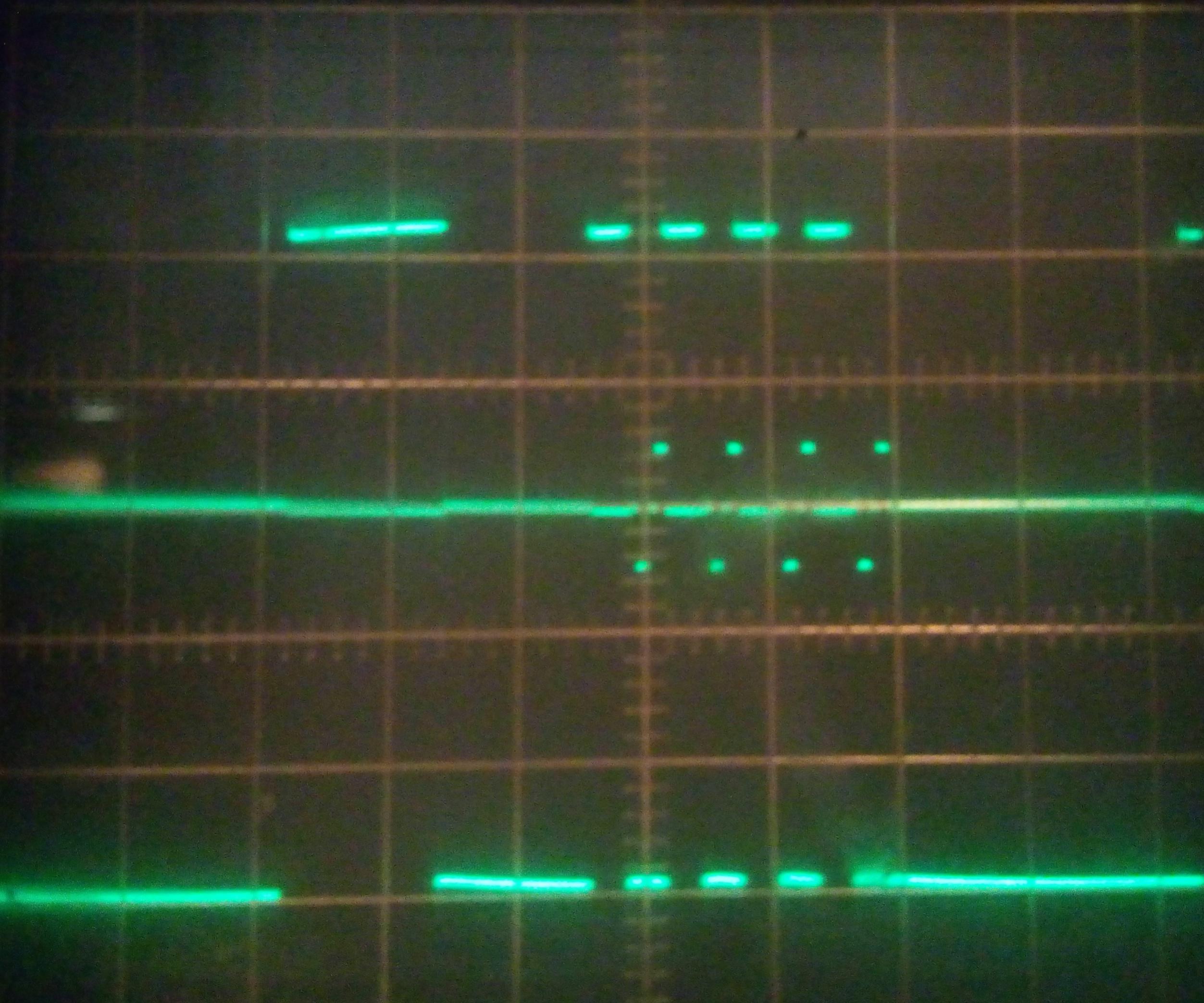

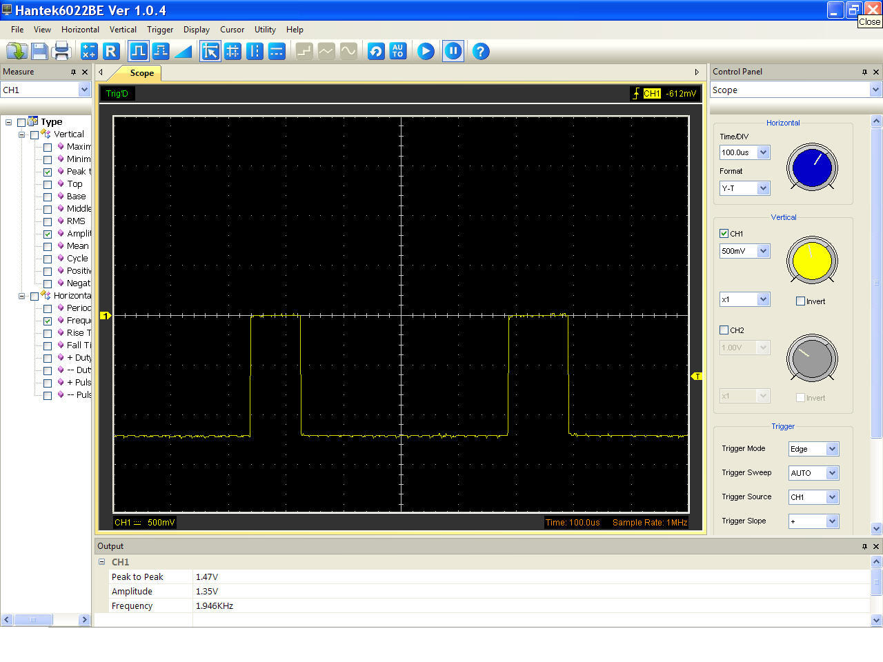

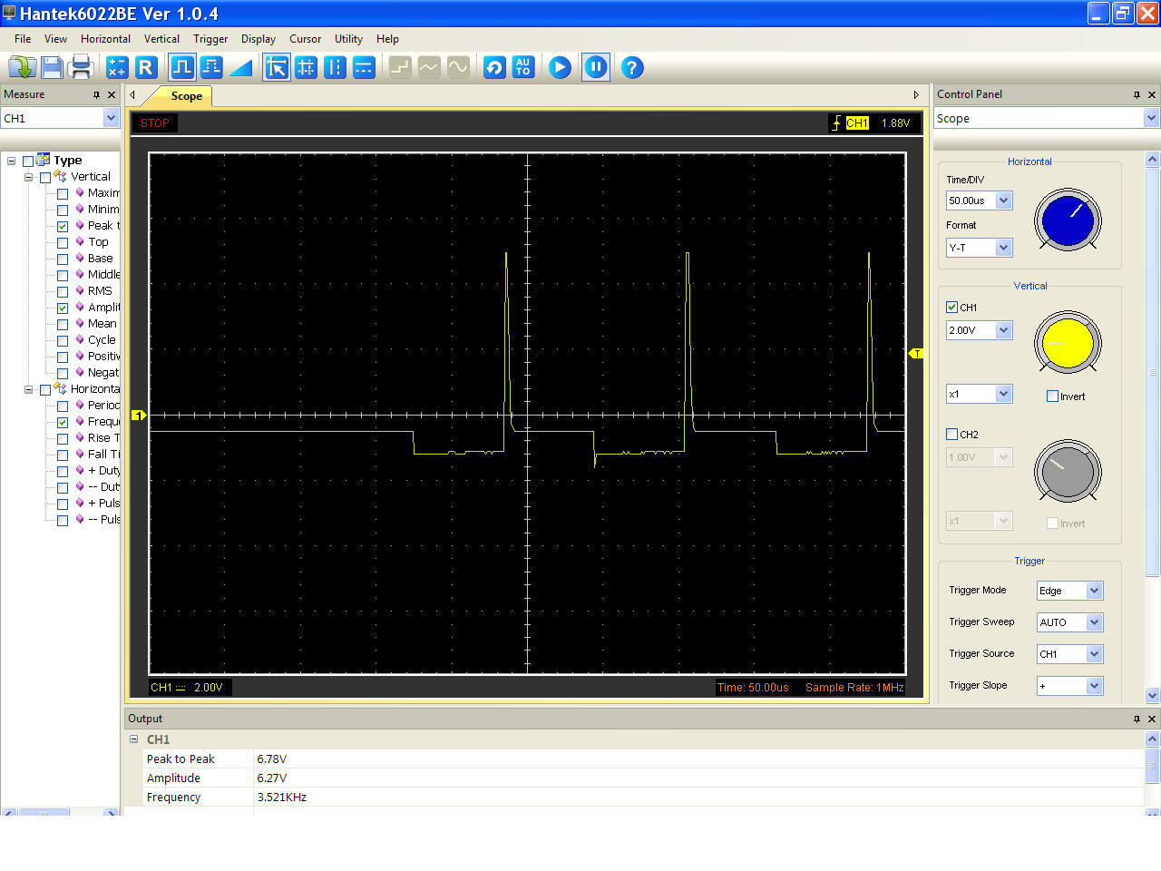

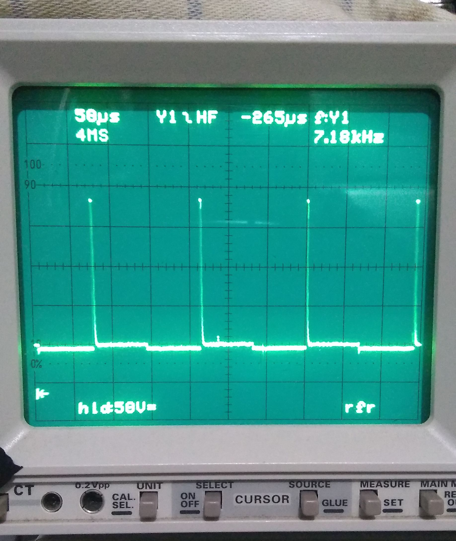

                              • Hello Suhoj57
                                Hmm those signals dont look right,i need to ask a silly question,is your scope probe set to x1 or x10
                                When i work on a 2000 with TX problems i remove the receive wire completely and address receive problems once the TX CCT is running correctly.A number of CCTS wont work properly until the TX CCT runs right so this is where you need to look first.
                                I have three pictures for you,one shows the flyback signal that you should be aiming for and the other shows the signal on pin 2 of the 393 chip,that signal is 100mv pp,pin 3 of the 393 needs to have about 52 mv on it or 0.52 volts.
                                The signal on the gate of the TX fets should be about 11 volts pp
                                Also try leaving the coil disconnected and see what signal you get on the hot wire going to the coil plug(wire with the flyback signal)it should look like the waveform in the third picture.
