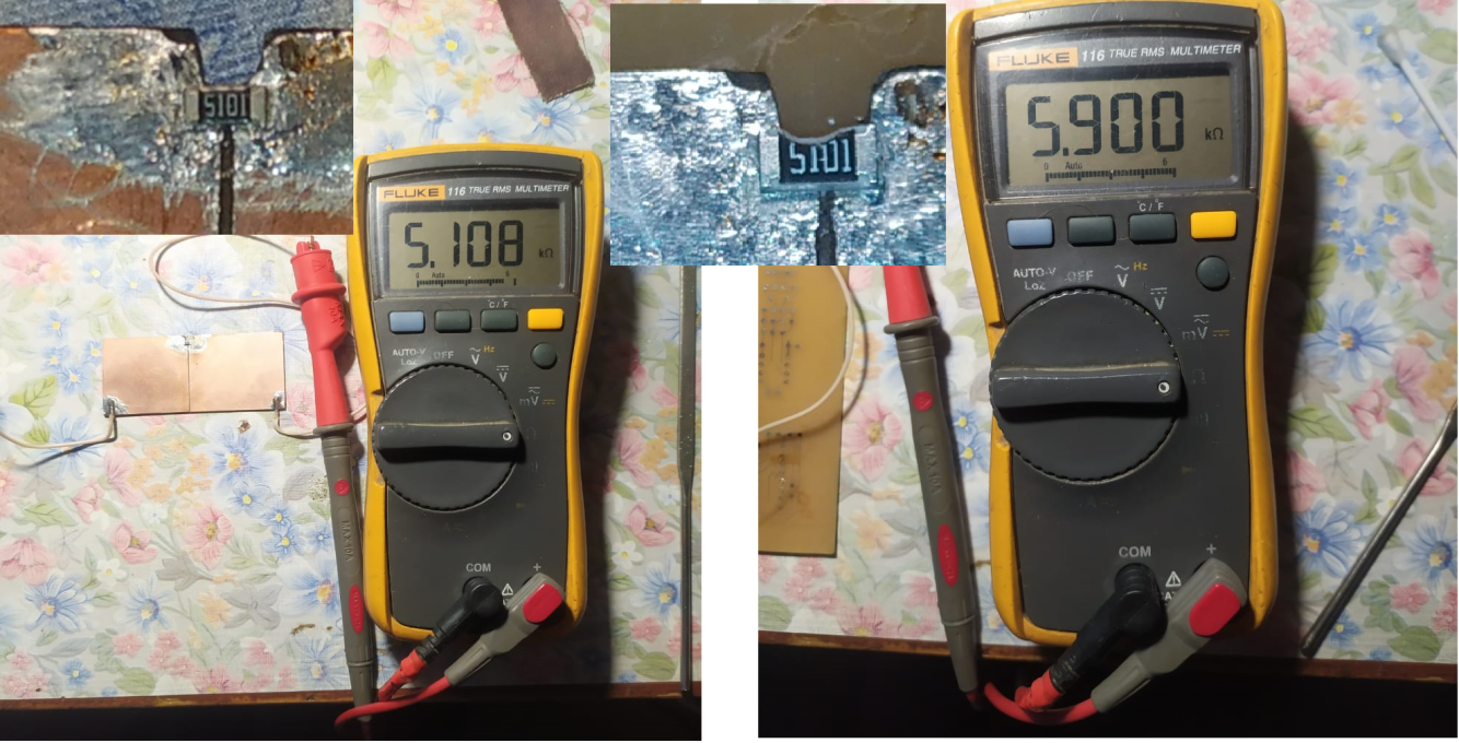

                        • Hi! if according to the standard scheme, the delay can be adjusted by a capacitor.
                          • The circuit has a 5.9K resistor. If it is not at hand, then you can adjust it from another resistor.
