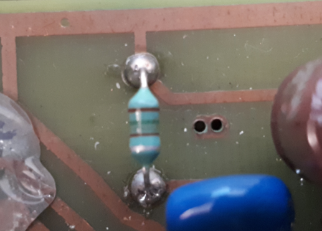

Thank you waltr for your replay, your advices are appriciated since it drived me to some major errors like soldering 1ohm instead of 13K for the resistor below LM358_A, setting BS170 instead of 2N7000, anyway I v been cheking all these thinks and it seams to be good.
So I v started again the +'-5V test and now it become the revers condition -5V is Okay, +5V = -0.4 and the 2N7000 becomes too hot!!!
Knowing that I m using BD675 ( I taked care about pinout) as replacement for ZTX688, PLEASE I M TOO CONFUSED, CAN ANY ONE ADVICE?

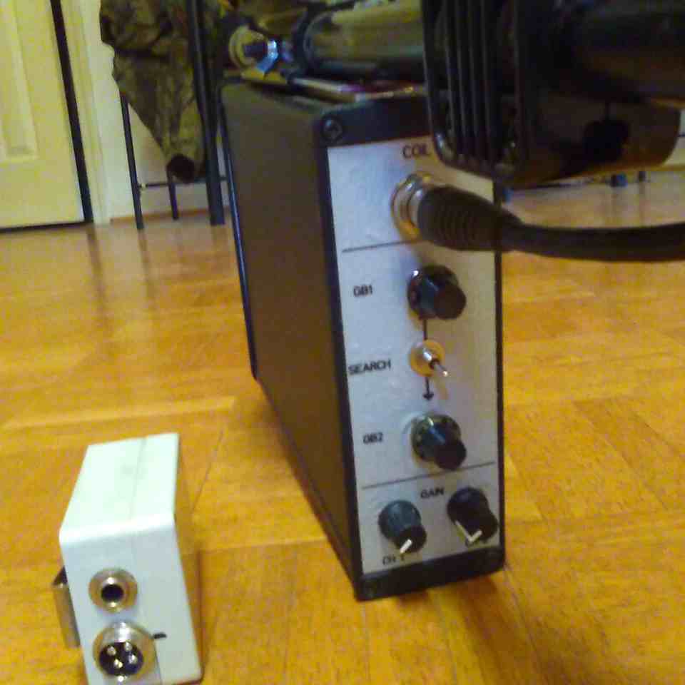

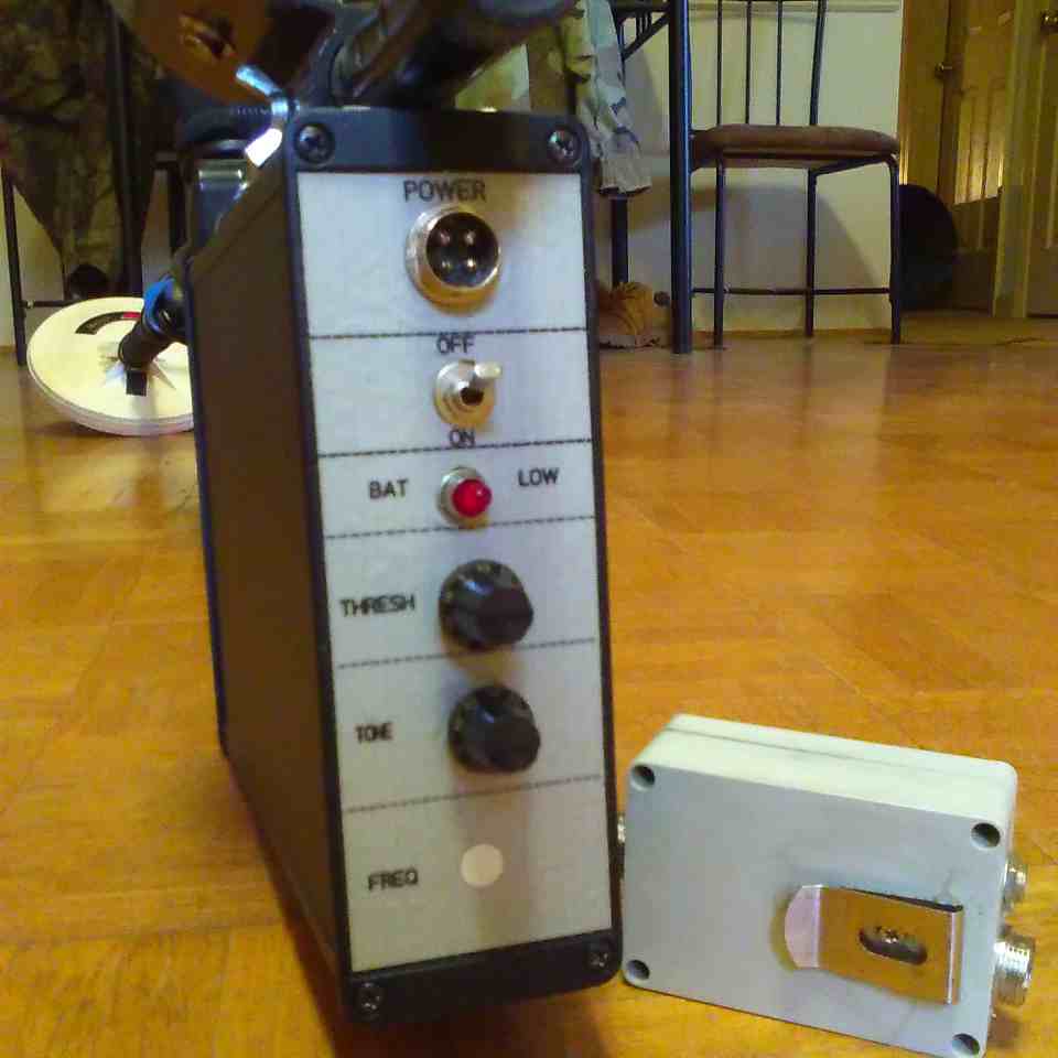

Keep up the good work, nice sweeting job...hope i will be on this lvlOriginally posted by au1 View PostThis thing works great!
[ATTACH]48615[/ATTACH]
[ATTACH]48616[/ATTACH]
[ATTACH]48617[/ATTACH]
Thanks Mechanic, Finderskeepers , Zed and anyone else that posted constructive help in this thread!

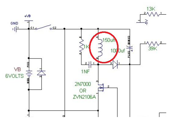

Looking at the PS schematic again. Now see why I though the ZTX688 was up side down, it is shown correctly, -VB is lower than -5.Originally posted by Anis View PostThank you waltr for your replay, your advices are appriciated since it drived me to some major errors like soldering 1ohm instead of 13K for the resistor below LM358_A, setting BS170 instead of 2N7000, anyway I v been cheking all these thinks and it seams to be good.
Not sure why you do not have +5.
The Gate of the 2N7000 should be pulsing, driven from the HEF4093.
Check that with your O'scope.

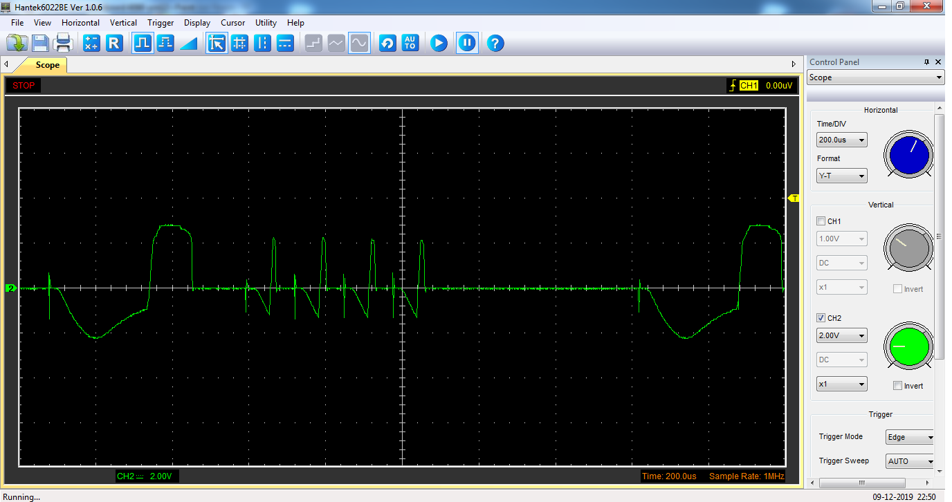

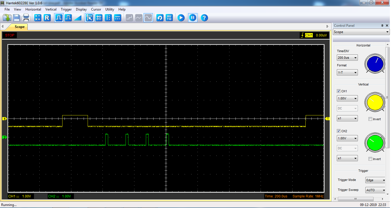

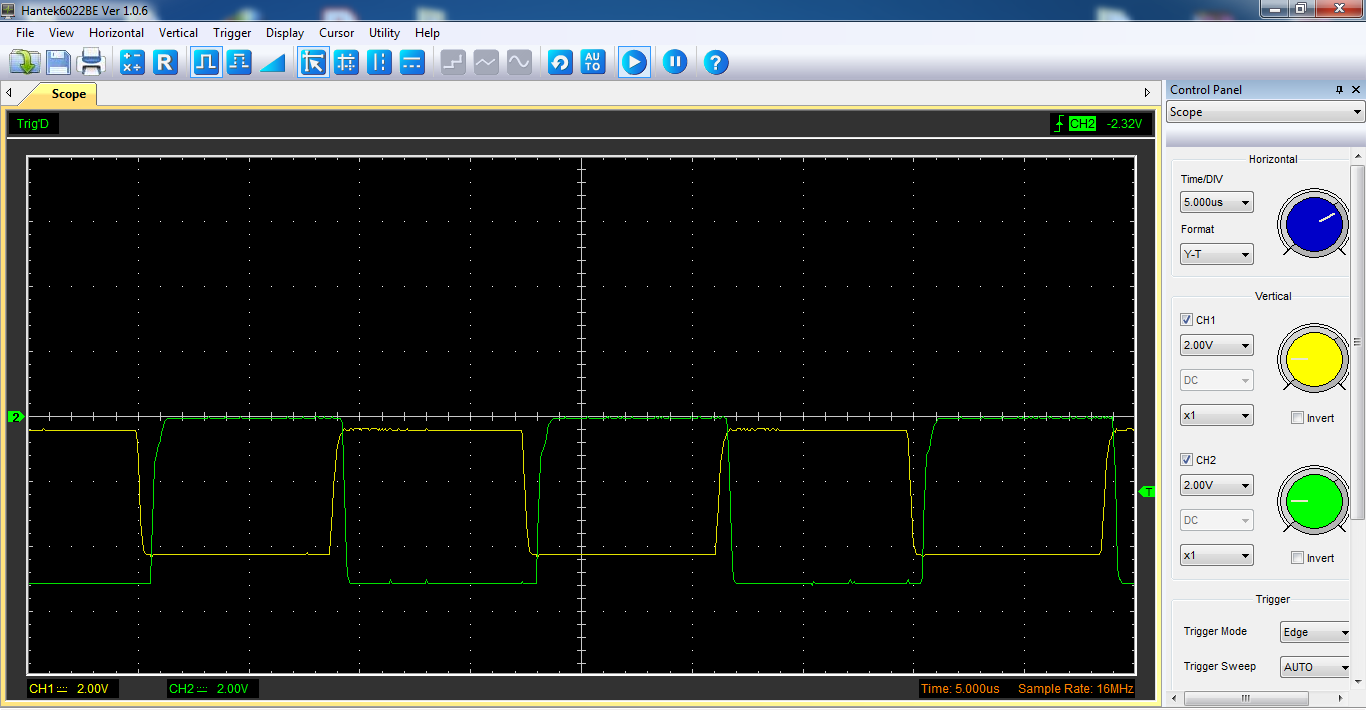

Hi Waltr, I v checked the gate signal of 2N7000, please see what i got in the scope.Originally posted by waltr View PostLooking at the PS schematic again. Now see why I though the ZTX688 was up side down, it is shown correctly, -VB is lower than -5.
CH1 is for 2.5v test point
CH2 is for the gate of 2N7000
Dose the resistance of the inductance in this circuit affect the +5V? (see picture of my inductance)
Something like this should work. https://au.element14.com/bourns/rlb0...09238?st=150uh
I think from memory that the 5+ rail on the 2000 uses about 300mA or less.
Cheers Mick
Also look with the scope on the 2N7000's Drain. This should be switching current through the inductor.Originally posted by Anis View PostHi Waltr, I v checked the gate signal of 2N7000, please see what i got in the scope.
Dose the resistance of the inductance in this circuit affect the +5V? (see picture of my inductance)[ATTACH]48619[/ATTACH][ATTACH]48620[/ATTACH][ATTACH]48621[/ATTACH]
This is a fairly complex circuit- the lower part of the schematic seems to be where the +5V regulator is done.
What didoe is used on the 2N7000's drain?? The schematic I have does have a part number.

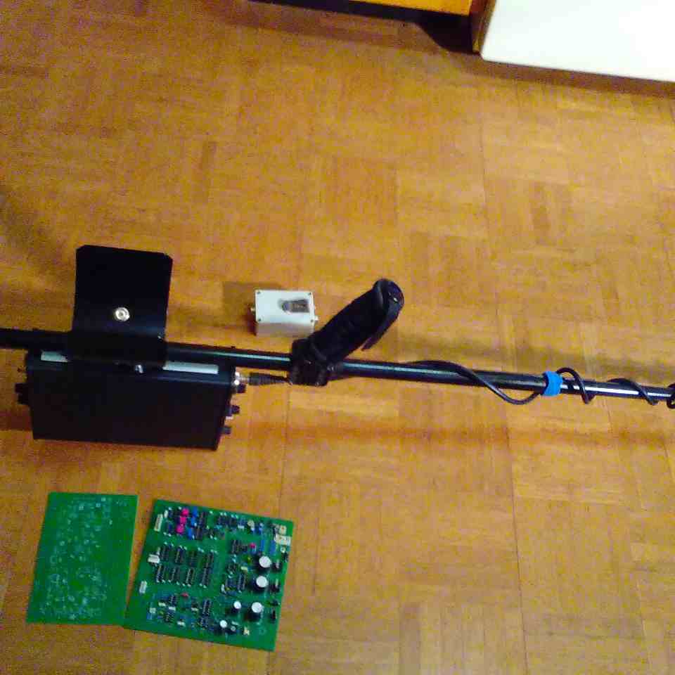

Hello genius people, @ first I would like to thank everyone for all advices, now I m glad to hear that magic sound, after many tests it was 2 problems: bad 2N7000 that I v replaced with 2N60C, and the bad inductor that I v replaced with one from a broken power adapter, after calculation it was about 180uH, and with these it works well,
BUT, I m just hearing sound and no reation from the coil,
Please I need your help to fire on this piece of over engineering...

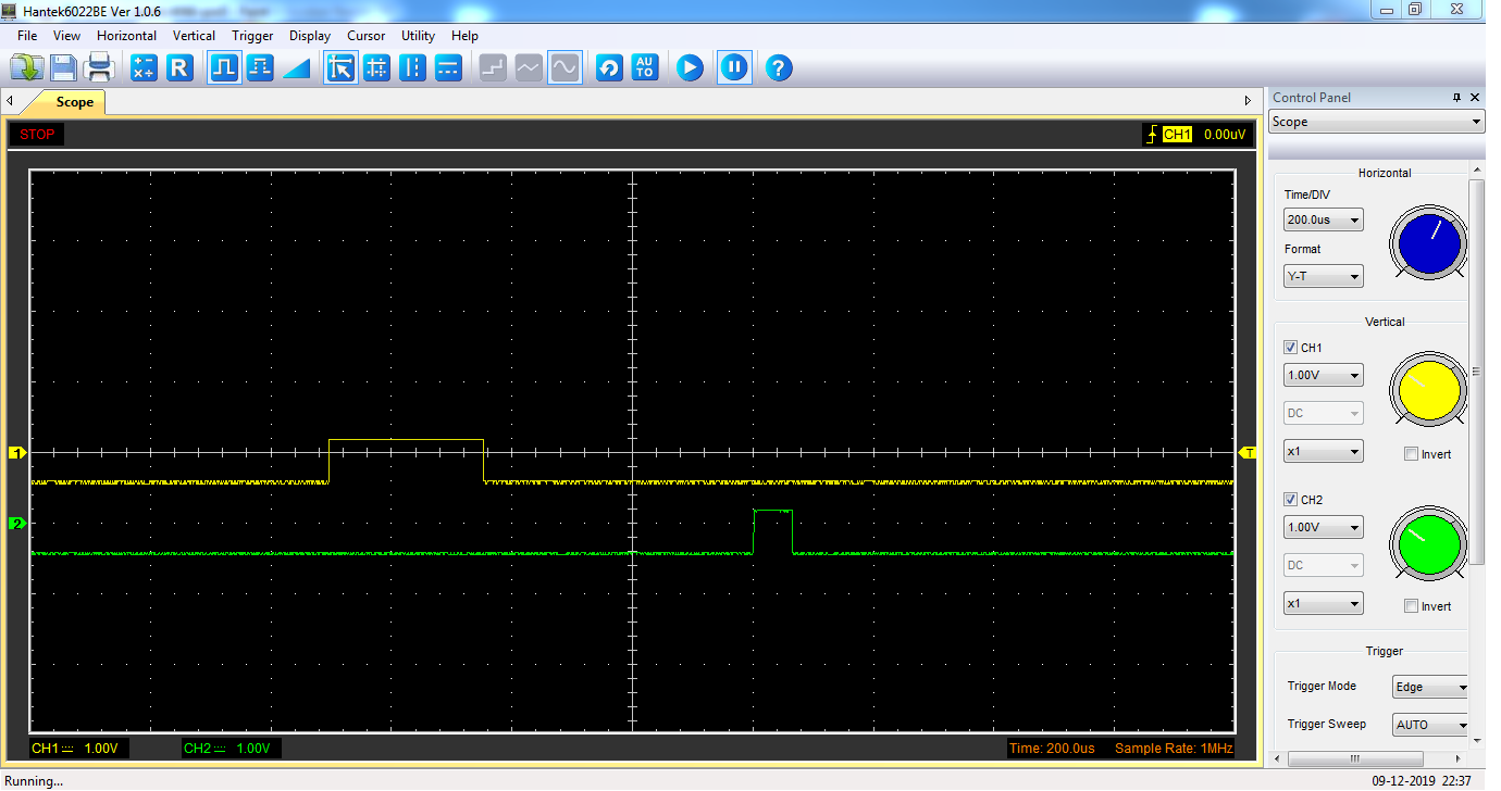

HiOriginally posted by waltr View PostMaking progress.
No idea what else is wrong. Hope the others can help.
But first give some hints:
Use O'scope and check that coil is pulsed.
RX op-amp see Coil signal, etc.Waltr,

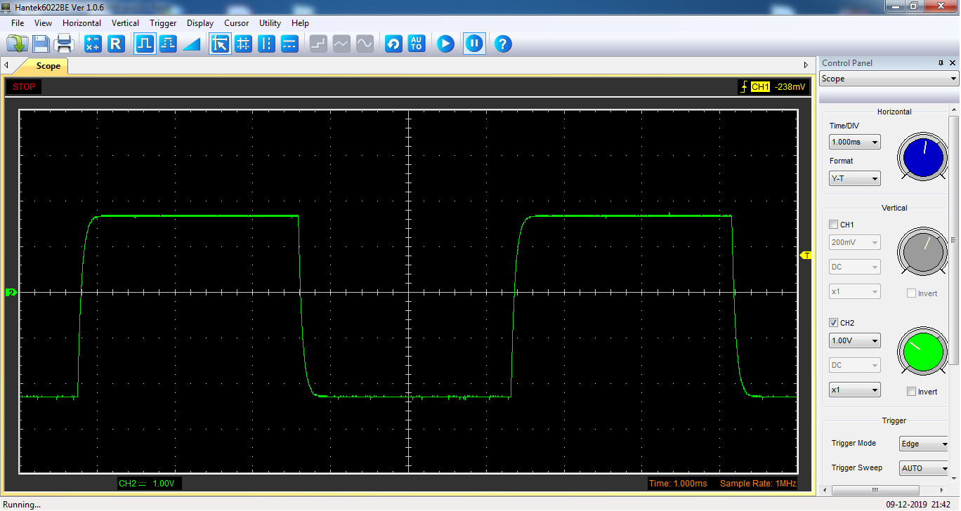

Please I v attached some pic from the mainboard signals, each picture named with part and pin.
I count on you and anyone to help me on this project.
All my respects
J.Anis
Looks to me you've got some timing pulses going(4066)
