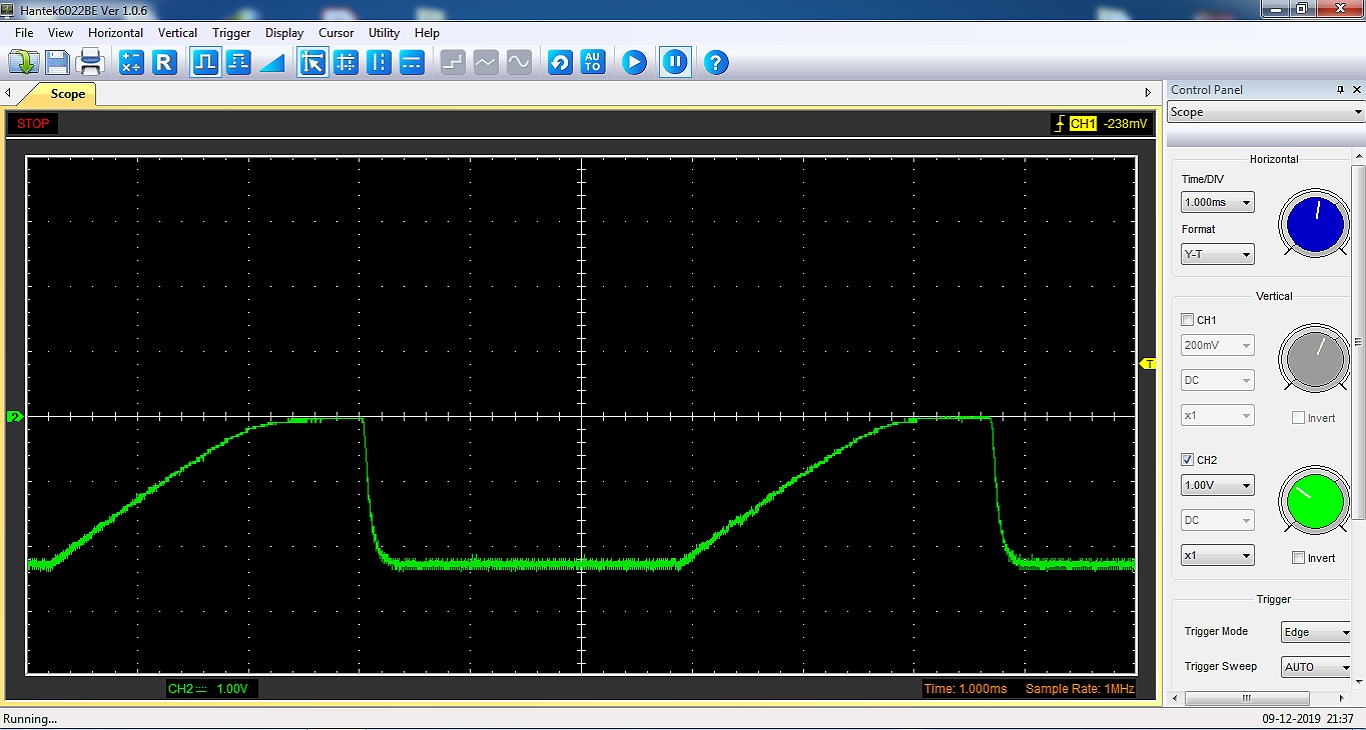

    Please below is dents waves from LM13600 and it change with tone control,Click image for larger version

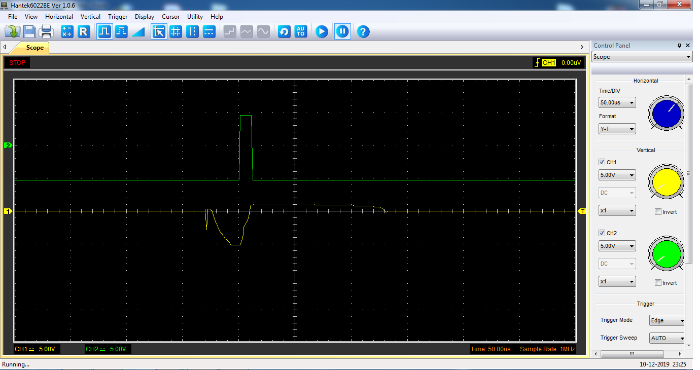

    • Problem seems to be from circuits related to the coil, see the coil signal picture.
      • Yes you are correct, the coil pulsing is not working correctly.
        After the tx pulse turns off, the flyback voltage should be going up to +180v.
        What coil do you have? Resistance and inductance and self resonant frequency.
        Also, if yo could measure the current waveform going into the coil that would be helpful.
        Cheers Mick
        • Yes, the scope pic of the coil pulsing looks goofy.
          • Originally posted by Anis View Post
            Yep,
            Please below is dents waves from LM13600 and it change with tone control,[ATTACH]48658[/ATTACH]
            That audio VCO section would not be a problem. If the waveform is changing with the tone control then that's to be expected.
              Not sure if the 'coil pulsing" scope pic is correct or not.
              Seems that the IRF710 on the TRANSMIT page of schematic may be a flyback clamp.
              Anis, you have a two channel scope.
              I would like to see the Coil and the logic pulse in one scope picture. This way we can directly compare the timing.

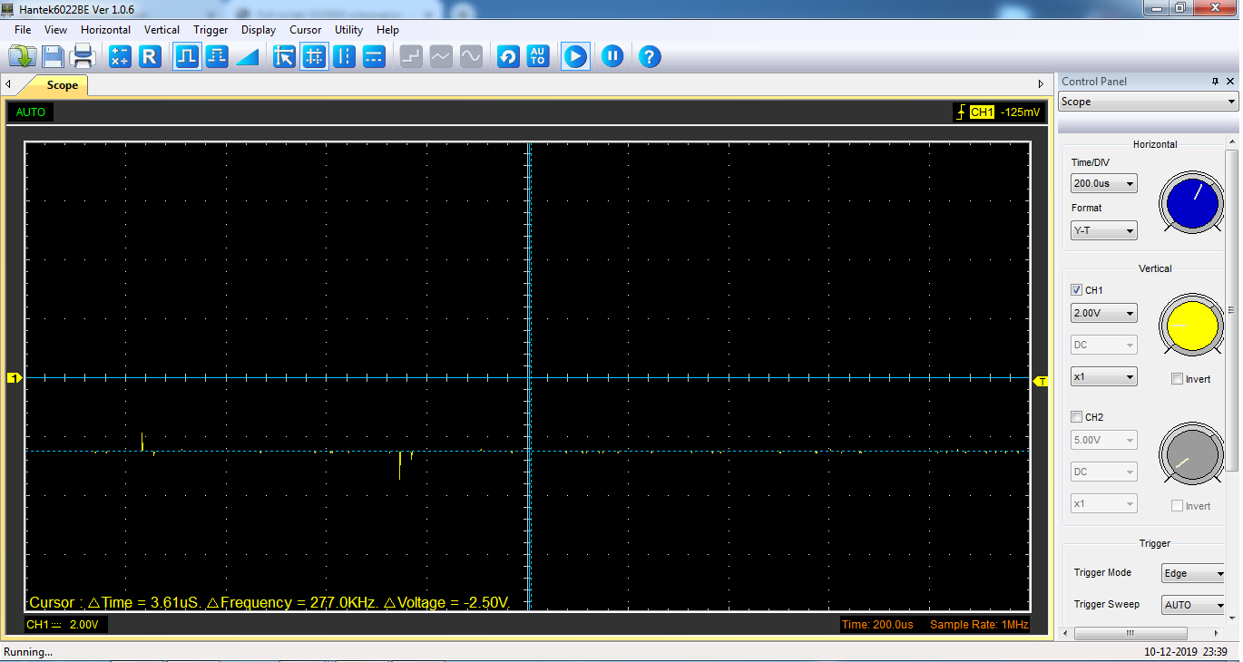

                    I would be really suspicious of the 2.5V (supplied by the LM336) for three reasons: (1) The original schematic is ambiguous to the correct connection and the 2.5V should really be labeled -2.5 V (although studying the circuit and understanding it will allow you to sort it out), (2) if the 2.5 V is incorrect you will have problems with the +5V generation, (3) if the 2.5 V is incorrect, the flyback regulation circuit will be incorrectly biased and will not function properly (and like Mick says the front end is blocked). All of which seems to apply here!

                          2-Also, if yo could measure the current waveform going into the coil that would be helpful. see attached both waves for coil voltage and curent.

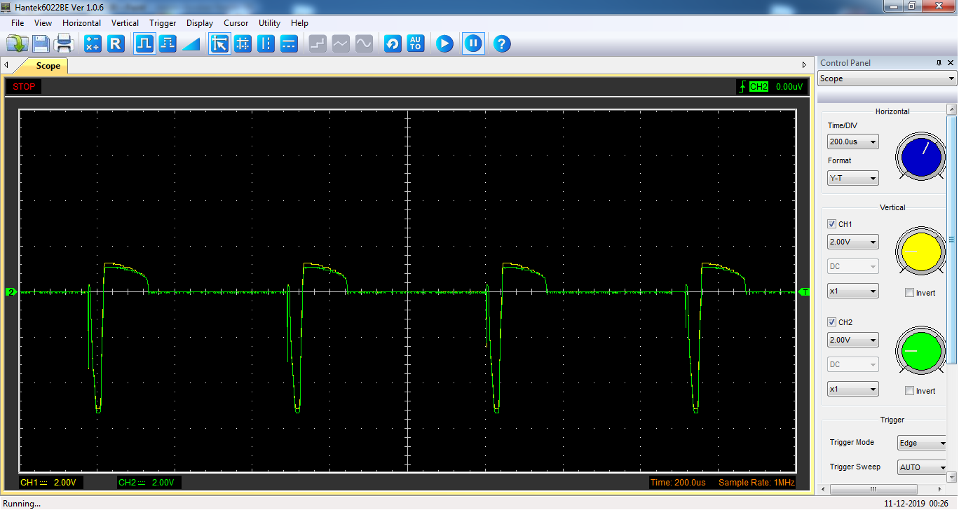

                          Waltr,
                          Please see attached is both voltage waves from coil and from CCT with coil connected and no for the other.
Name:	CH1-Coil-and CH2 CCT (D).png

                          Please below is the scope for 62KHz test point and 2.5 ref.

                            Foolish question... what are the actual parts you are using in the TX circuit... e.g. TX MOSFETs, diodes, etc? If you are actually using BUK455, which one... there are at least 4 different ones -60a, -100a, 200a, and -600b? And for the diode, is it the BYV28-200? If you temporarily remove the diode between the TX drain and 100uF capacitor, do your TX current/voltage waveforms change... particularly the end of TX/flyback time? Currently the flyback is extending for about 120 usec... indicating an almost complete shunt of the flyback. The polarity of the 100uF/200V capacitor?

                              Your picture with no coil, the tx pulse looks like it has a fairly slow risetime? Where is the other pulse(ch2) taken from?
