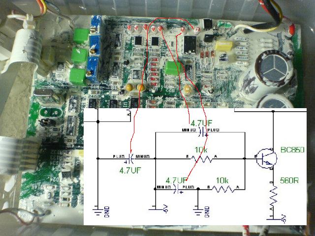

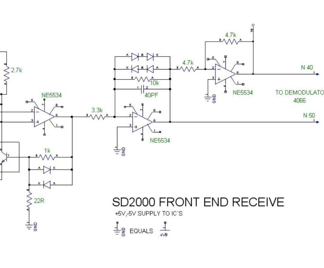

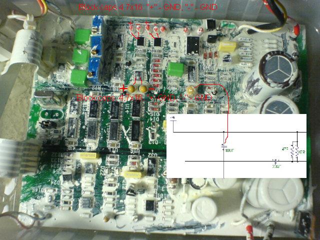

          Checking the type of components you are using I found these:
          - capacitors used in the front ed receive, I didn't found them in the original schematic.
Name:	Front end receive.jpg
          Please can you detail the characteristics and what purpose for them?

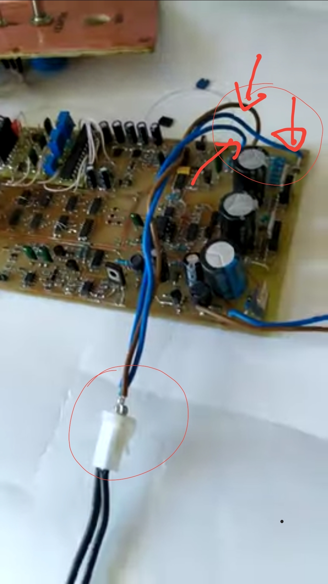

          Also I see you connected 3 wires as below pic it seems to be the coil connector, If yes, please can clarify from an where these wire are connected since in the zed schematic there is only two wires connected with the coil?
Name:	Coil connection.jpg

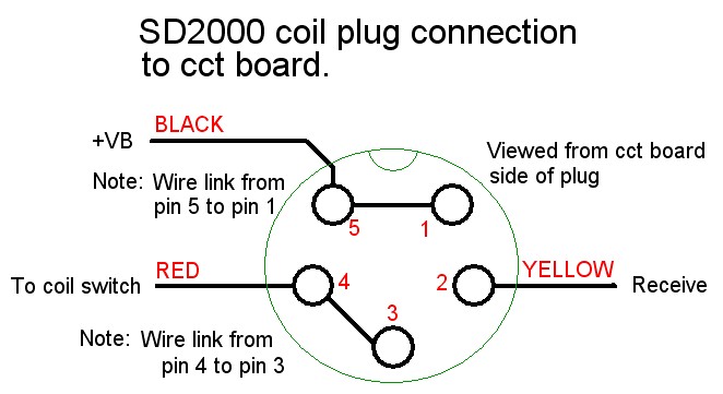

          • There are three wires to coil connector on the SD2000 pins 1 and two connected and come from TX pin 3 to RX and pins 4 and five connected go to ground.
            Regards, Ian.
            • Originally posted by IBGold View Post
              Regards, Ian.
              Hi Ian, thank you to reply
              So If I understand correctly, the three wires from the main board are:
              2 wires to the inductance and 1 from GND for the coil shielding.
              I already sent an email to you, please can you check?
              I make the coil from the 0.2mm 36 strands litz wire and it gives me 310uH and 0.6 ohm, no shielding sample connected to the board.
              Result was not good enough, it has no response to gold but little on heavy stainless steel and magnetic part from speaker.
              Please any advices?
              Rgds
              Anis

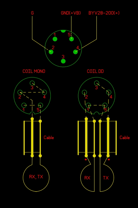

              • Anis if you were using a mono coil then two wires to the board would be fine,but with a DD coil an extra wire is added,how the wires are connected to the coil plug depends on whether its a mono coil or a DDcoil.
                See pic

                  • Hi Anis! From this forum
                    _________
                    Hi Morgan,
                    In DD configuration connections as follows.
                    Pin 1 is RX shield and linked in the plug to pin 5.
                    Pin 2 is RX active.
                    Pin 3 is linked in plug to pin 4.
                    Pin 4 is TX active.
                    Pin 5 TX shield.
                    In MONO configuration.
                    Pins 1 and 5 linked and pin 5 connected to coax shield.
                    Pins 2,3 and 4 linked in the plug and pin 4 connected to coax center conductor use 1.0mm for the links hope that helps you.
                    Regards, Ian.
                    ______
                    • Hi Anis! I think it should be so, correct me if I'm wrongClick image for larger version
                      • Originally posted by Andrei View Post
                        Hi Anis! I think it should be so, correct me if I'm wrong[ATTACH]53149[/ATTACH]
                        Hi Andrei,
                        Yes I think you're right, but in my case I do not have an SD2000, but I'm just referring to Zed schematic to connect my DIY coil
                        Thx Anis

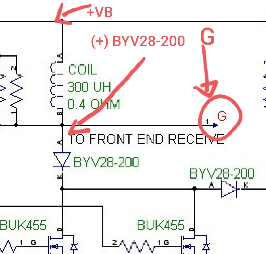

                        • Andrei,
                          The 'G' and 'BYV28-200(+)' seems to be the same potential based on Zed schematic, m I right?
                          • Yes

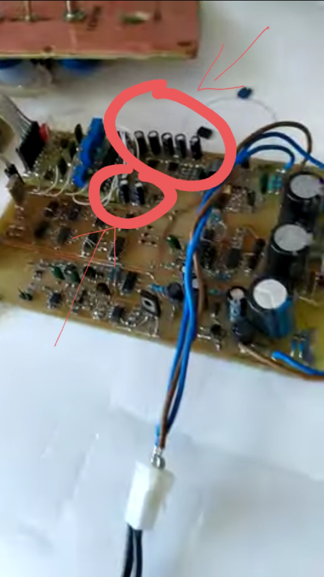

                            • Hi Anis! For the capacitors. I suppose it might be so. if you are wrong correct itClick image for larger version
                              • Hi Anis! For the capacitors. I suppose it might be so. if you are wrong correct it Click image for larger version
