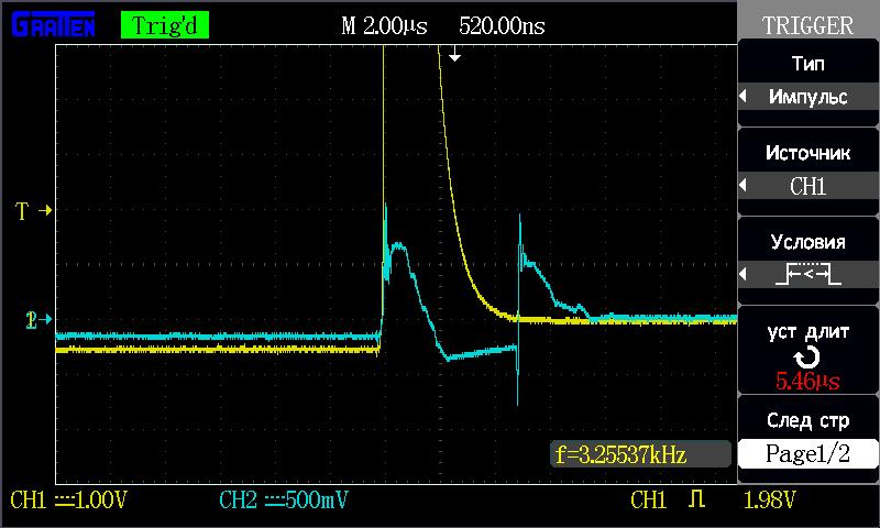

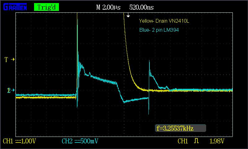

ID:	358598 Hi! Question. Where does the first pulse(blue) come from, like it shouldn't be since the vn2410l transistor is closed? Here after short impuls Click image for larger version
ID:	358599. I use VN2410L and ZVP3310.
                        • Hello Andrei
                          Yes the signal is supposed to be there although we prefer that it wasn't,mosfets have what is called capacitance,as you may know,so the flyback voltage travels through this
                          capacitance and appears on the source terminal,the diode on the source will clip this signal to its forward voltage drop,because the capacitance is small the charge from the flyback voltage will also be very small.
                          As we source components like receive fets we like to aim for low capacitance but that comes at a cost of increased resistance,the trouble with that is we like to keep the resistance low as
                          well so then it becomes a bit of a juggling act,a mosfet i like to use for a receive fet is a ZVN4525G
                          Cheers....
