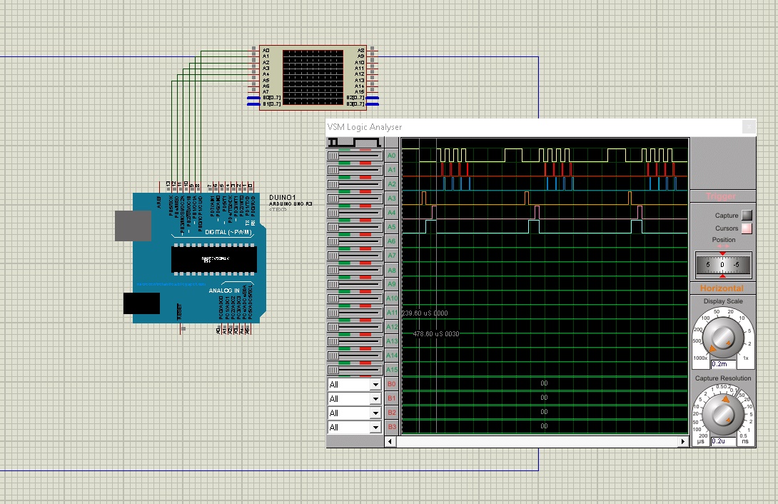

          Hello
          I am about to make a digital version of SD2000, What i need is a driver which will drive a +-5V from 5V so logic level driver. I am about to use ATMEGA328p or if i run out of pins i will use atmega2560 the reason is because those controllers support arduino ide and it will be easy to do a software. I found a MC14504B chip but now i am not sure how to connect it. Can someone with more experience help me with that ?
          I know that chip is used in SD2200 so if someone have SD2200 it will be really good if it can check.
          I can use generic transistors to do that but it wont be too good solution.
          If someone is willing to help it will be great!
          • hi friends my detector timings:
            crystal: 2mhz.
            https://postimg.org/image/jxxmc63zd/
