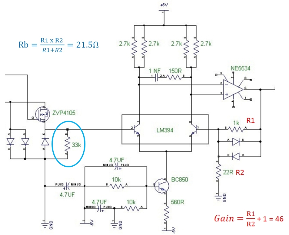

They must of thought that it brings good luck to add 2 X 4148 diodes as a protection feat. Pity that these diodes are never exactly the same as each other and if a big spike came down the lower voltage drop of the two will conduct and be converted into a tiny little bit of conductive slag. My advise is to get rid of the diodes as we can do without the extra 10pf of capacitance at that part of the circuit. The Goof is in the bias setup of the 2 transistors, the set point is wrong and upsets the noise figure and the available low signal gain. There are other technical (not quite right) components in other parts of the circuit, especial on the gain settings on some opamps. Some of the stages should have rc networks rather than a straight resistor to cut out a lot of artifact noises being generated by the detector itself when the input signal causes problems with the slew rate of some components.
Anyway, thanks to Zed for putting up a decent schematic, much better than the hotch potch of drawings from past contributors.

I may need to swap out components and see, but that's a bit of wall beating, much better to understand the theory!
Does the normal base bias theory hold? Then why have they minimally loaded the input with 33K, is this the goof?
Did they find that the LM394 hfe variations required it, or Oz ground variations required it?
Why is the gain so low in the second stage, is this where more sensitivity can be wrung out?
Why such a weird tail current regulator?
Anybody care to share their hard won knowledge on these questions, this old crust would surely appreciate the saving what little of life remains not scratching the head and lifting and tearing tracks!
