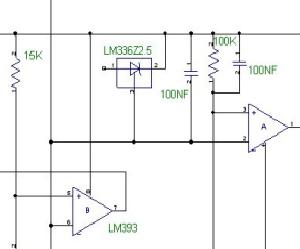

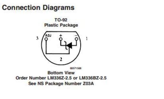

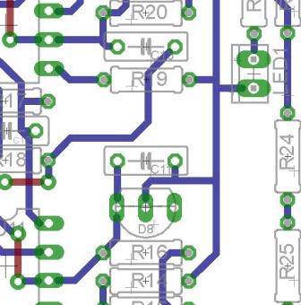

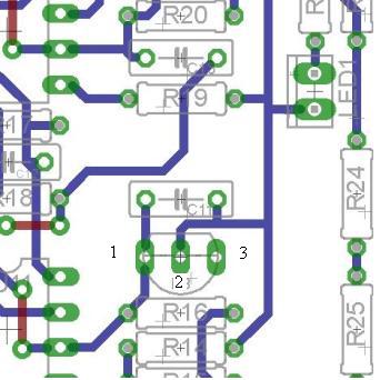

  • Originally posted by kadir6141 View Post
    hi friends why is 1.leg emty lm336
    Use of the adjustment pin is purely optional (here it is not used).
    • Yes there is something strange here ???
      observe is not reasonable..
      Look at the pin 1 .2 .3 ....maybe mistake in the schematic...
      In my own pcb I associate pin 1 and pin 2..
