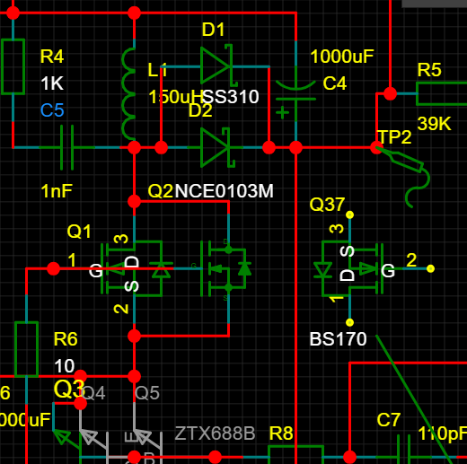

                      Hello! I encountered an issue while taking measurements: the -5V rail is functioning normally, but the +5V rail measures only around 0.1V. How should I go about troubleshooting to identify which specific section is responsible for the missing +5V?

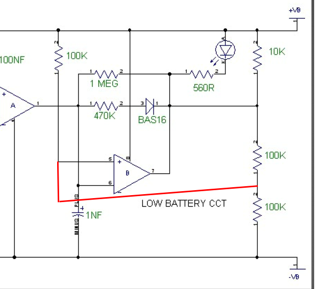

                          If the red connecting wires shown in the diagram are connected together, will this result in an abnormal +5V output?
ID:	447251If the red connecting wires shown in the diagram are connected together, will this result in an abnormal +5V output?​

ID:	447254N-channel MOSFET: PIN-D is connected to a 150 µH inductor, and PIN-S is connected to the negative terminal (-VB) of a 6V battery. Is this connection correct?​
                              • Check if there is a frequency on the gate and drain of the mosfet transistor that enables the positive voltage of the 2n700 or that you put in, if the frequency exists it would mean that the mosfet is not working! There I also tried a bipolar transistor for example bc547 and I get 5v. The line that connects to the battery drop has nothing to do with the positive voltage! Maybe you have somewhere connected not to the mosfet that regulates 5v but to the line for voltage 5v? If something in the connection is faulty for example some component that is powered by the 5v line there will be no 5v voltage present at the output of the 2n7000 or whatever you are using at that location for that line or rail. I would remove the components from the pcb if you have a base and check the voltage, and if there is a voltage of 9.9v I would put back one component at a time and that way you can see which component is problematic or possibly there is a short circuit. Because of such problems that can occur when I solder components, I first solder the components that are in charge of powering the integrated circuits and only when I check and determine that there is normal power supply at the control points or lines, after that I solder the other components on the pcb.
