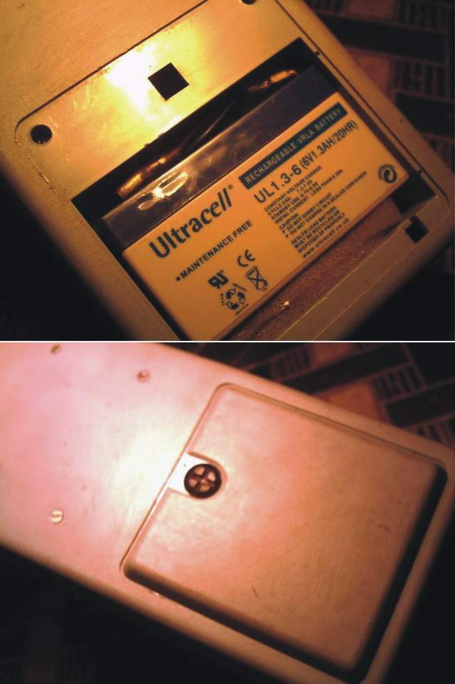

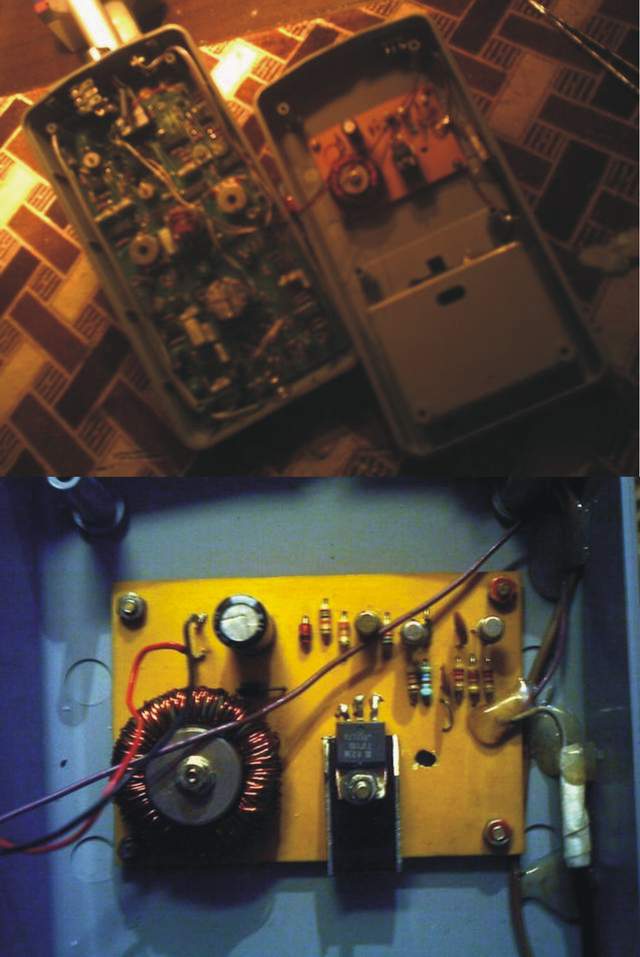

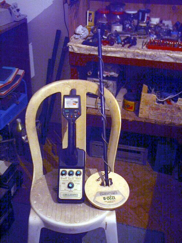

    OK, just back from workshop.
    Finished.
    Here is how is done:

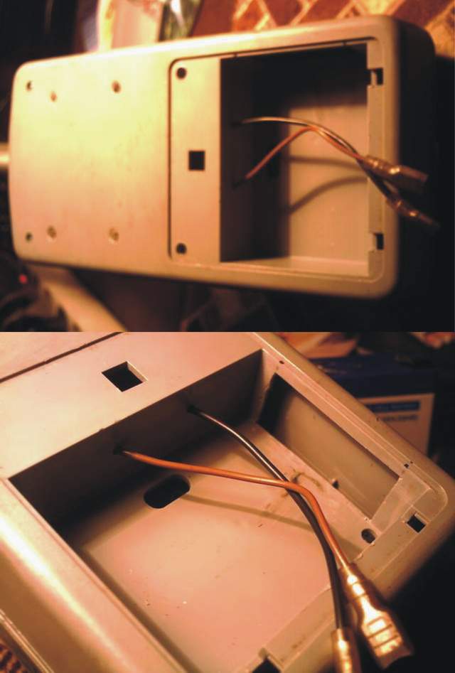

      When i said that 6v accu will perfectly fit 1220B battery compartment - i was wrong!
      It was "short" for damn 3mm!!!
      So i had to "open" one of the inner sides and make enough space.
      Not a big deal, even better now because accu will be additionally contracted in that "hole"!
        Here is the final look:

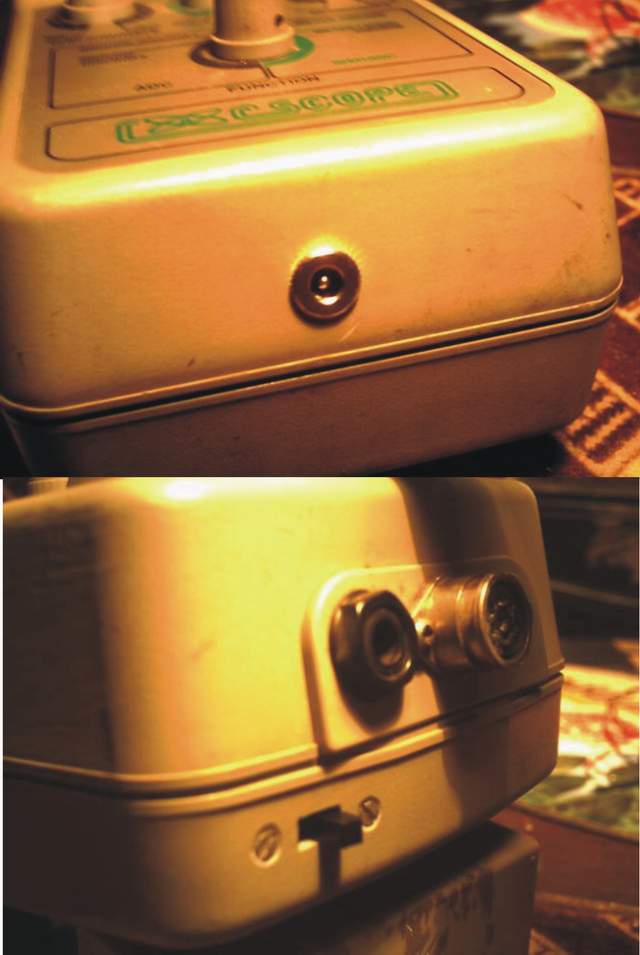

          I also added additional power Switch by which accu is disengaged from voltage multiplier.
          Also added additional DC socket for charging, because original one is not suiting my expectations, so i left original one unused.

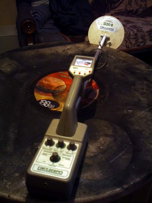

            And finally here it is, ready to kick some coins a$s'es!

                Can't tell exactly the year of 1220B production, but assume early '90. First one i had back in 1996. (as i recall...or maybe i am wrong? can't tell exactly..) and it was the same as this one now, but with a bit different colors (see photo below).
                Today they have "Newforce R1" which is outstanding machine.
                1220XD also, 1220R also... and i am happy because they are keeping the level with such products.
                Recently i had 33XD (utility detector) and was impressed with what i saw inside (some other story for some other topic...maybe in future).
                Csope is holding.. and they have my full support, because i am their great fan!

                  Now you know why i decided to make voltage multiplier..!

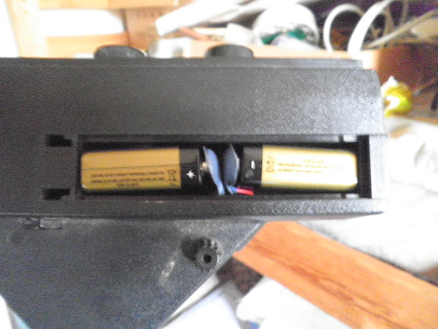

                          side view..... there are two batterys per side
                          • #43
                            Now looking that side view, i think i met it in the past.
                            But i can't remember it's performances.
                            But also i think it was 770 model that i met, not 990. Not so sure.
                            Anyway, Cscope always did good quality enclosures from high quality plastic.
                            Yes they used same mold for whole series, which is not bad thing at all.
