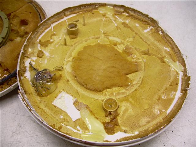

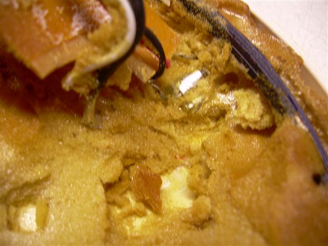

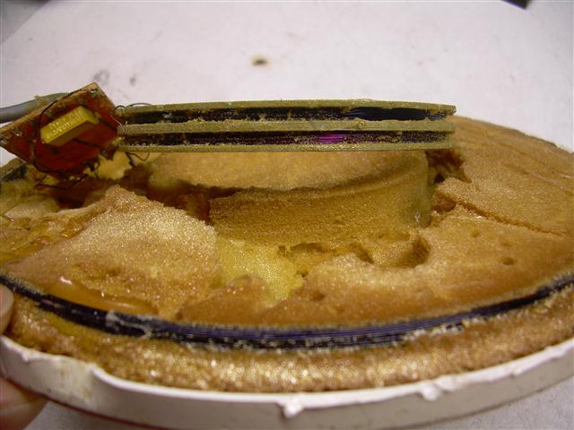

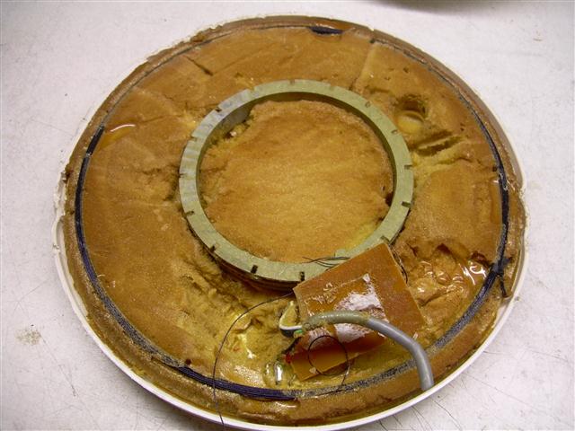

    This what found in the coil, i like to know where is the shield? I try to learn.
      Leendert
      Obviously there is no shield!?
      • #48
        When Ground balanced - most probably it is drifting from time to time? Isn't that so?
        It is probably also pretty sensitive to temperature changes? Drifting again?
        It is probably early '80 or late '70 model?
        So if you still like it and want to hunt with it, you can make significant improvement by applying Faraday shield on that coil.
        Since it is concentric - it is more advisable to make shield by spraying it with graphite powder spray than to apply Al foil tape (more easier).

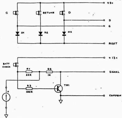

                              I have some troubles reading the schematic, can anyone confirm the frequency this rig operates at, and where are D1 and R12 connected?
                              Otherwise, I like the way phase is set by Johnsons counter and a PLL. TGSL uses delay instead, and here is the phase extracted directly. I thought of this concept as a delay mechanism for PI as well.
                              • #60
                                1) 17kHz
                                2) D and G points....
